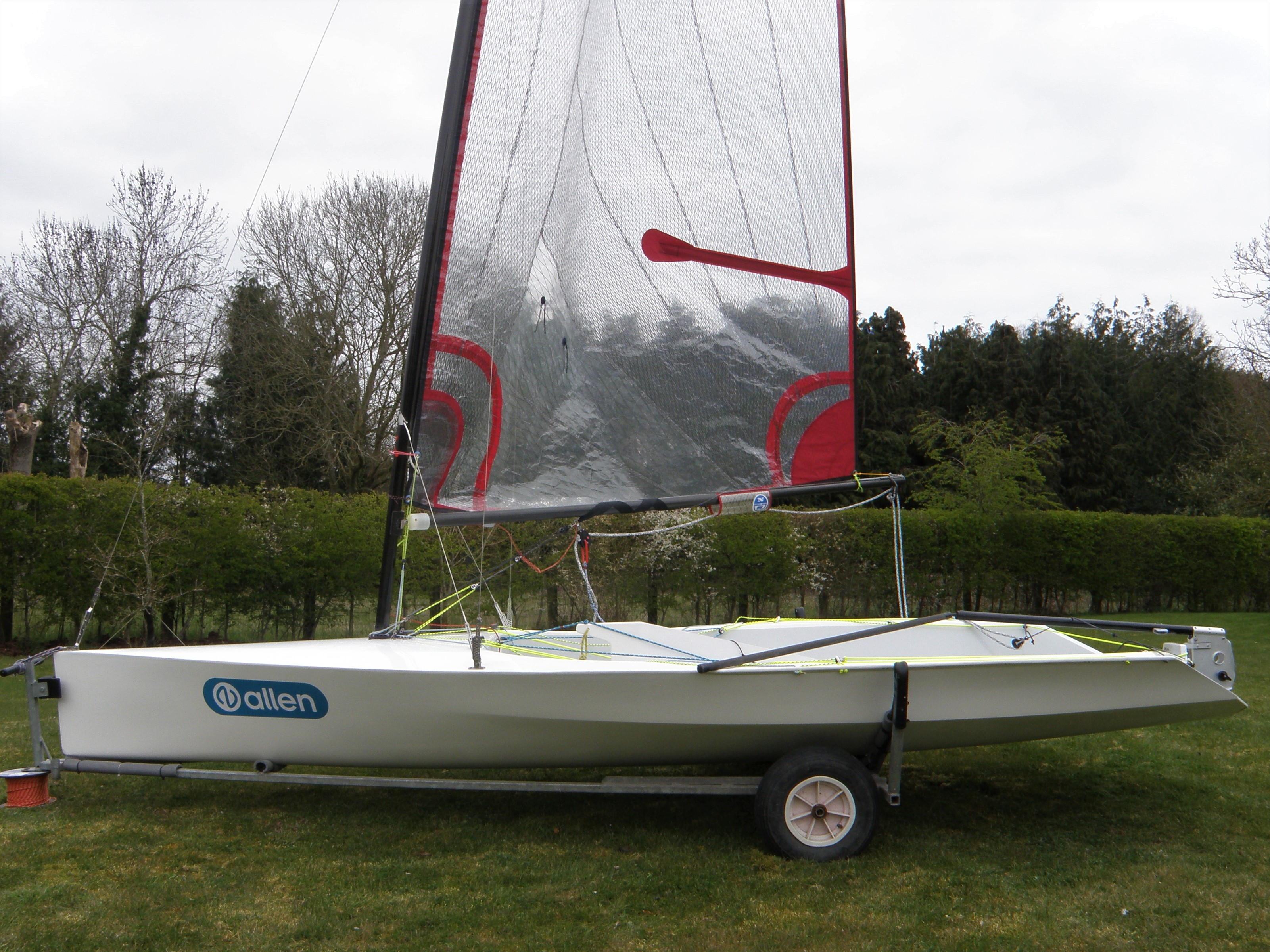

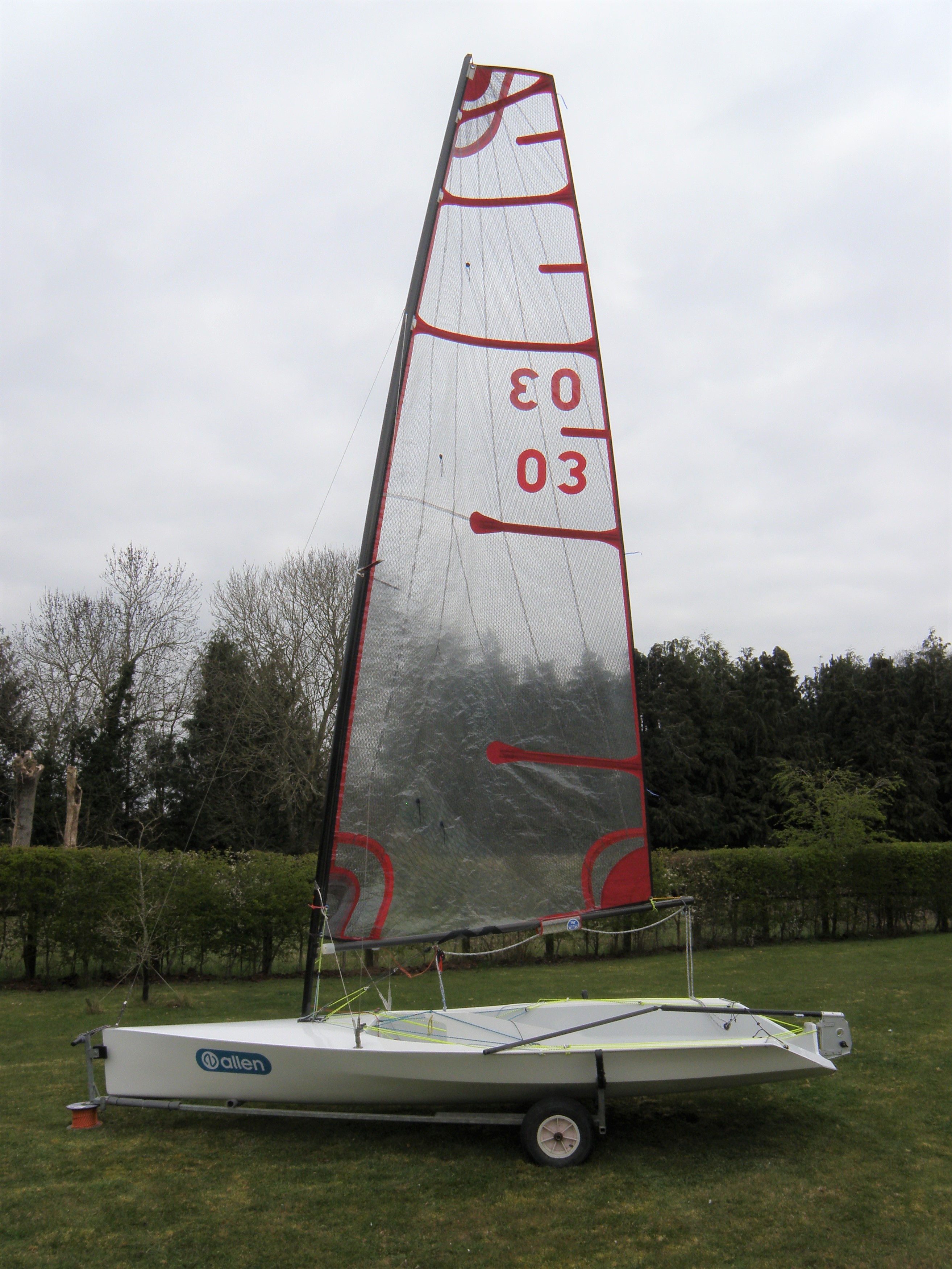

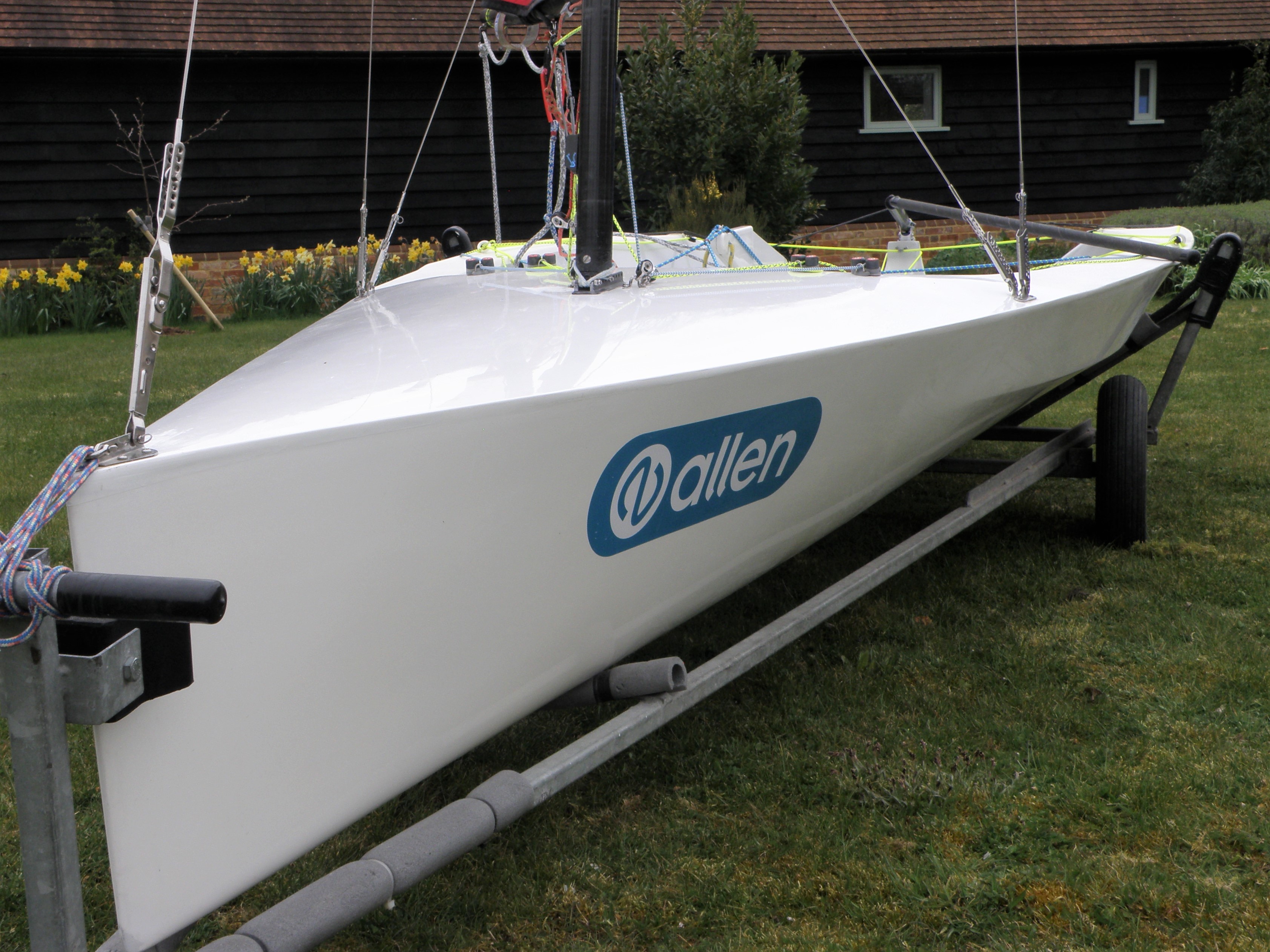

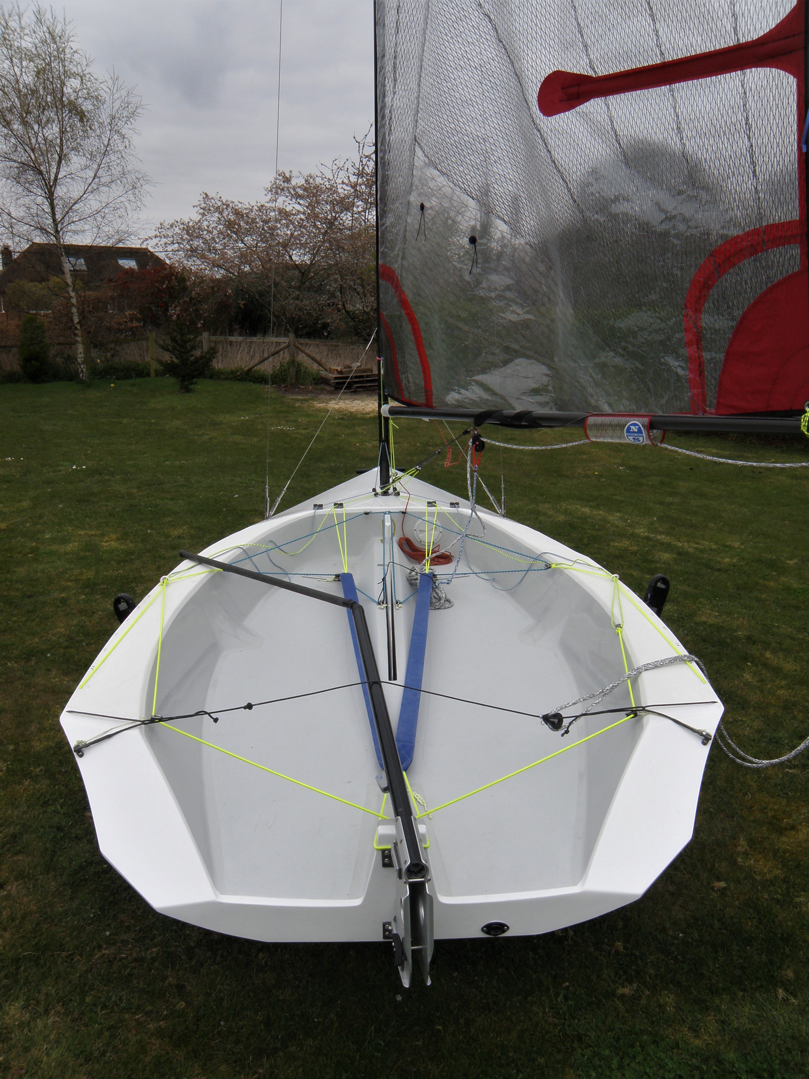

Bimbling with boats is about all
many of us can do for the foreseeable ... So here is one I started
cobbling together over the winter. Just 'finished' this 'special' with
the current limitations allowing a fast finish but cannot test / trial yet of
course !! It is simply called 'Hybrid' for now and is 4.25m overall and maximum beam of 1.60m (and lightish). A mixture of ideas in fact to trial / assess. Initial sail area in photos is approx 9.3m2 and the spars used here are carbon. Intended primarily as a non-winged hiking design with centreboard with a higher boom could also make a GRF style trapeze platform maybe. Why do it ? But equally and especially now ...Why Not ! |
Is that a Blaze rig on an Icon hull? I thought the gunwhale lines were straighter on Icon than in these pics?
Nick

quite H2-esque some might say ....
More soap dish than the H2. My knees would hate it, I'm afraid.

Not a Blaze rig ... though the mast is v.similar to both Icon and the Blaze 'family'. Not H2 in terms of general ‘bulk’ or freeboard but with a bit more (v.necessary imo) than say a Zero. The original concept was for an exceptionally easily driven simple hiking hull but not to the point of becoming ‘demanding’ light and simple but capable of carrying a reasonable weight. The hull underwater is almost pure Icon, (cos that one really is slippery yet ‘easy’) but it is 215mm (9") shorter and the freeboard is very much less than found on an Icon or H2. The sail in the pics is in fact based on an early Icon development main but modified by Dick Batt to suit the rig dimensions and rake. (The boom is currently made from old Blaze outer wing tubes – cos I was waiting too long for a larger diameter tube to arrive) So NS14 inspired with touches of Blaze, Icon. and yes even some H2 and Zero in there if you like ! This concept is much lighter than say a Blaze and if ever in full epoxy would be much lighter still. Edited by Cirrus - 01 Apr 20 at 3:20pm |

H2 and a D0 had a child. I like it!
However, if I wanted a boat that was really nice to hike I would keep my H2 but if I wanted a boat that was more like a D0 but that carried more weight and I was willing to be on my knees downwind then it looks great. Only question would be whether the rig was big enough? Most of the boats that aim at the bigger guys continue to feel a little under powered in my view, but that is a minor point! Edited by H2 - 01 Apr 20 at 4:20pm |
