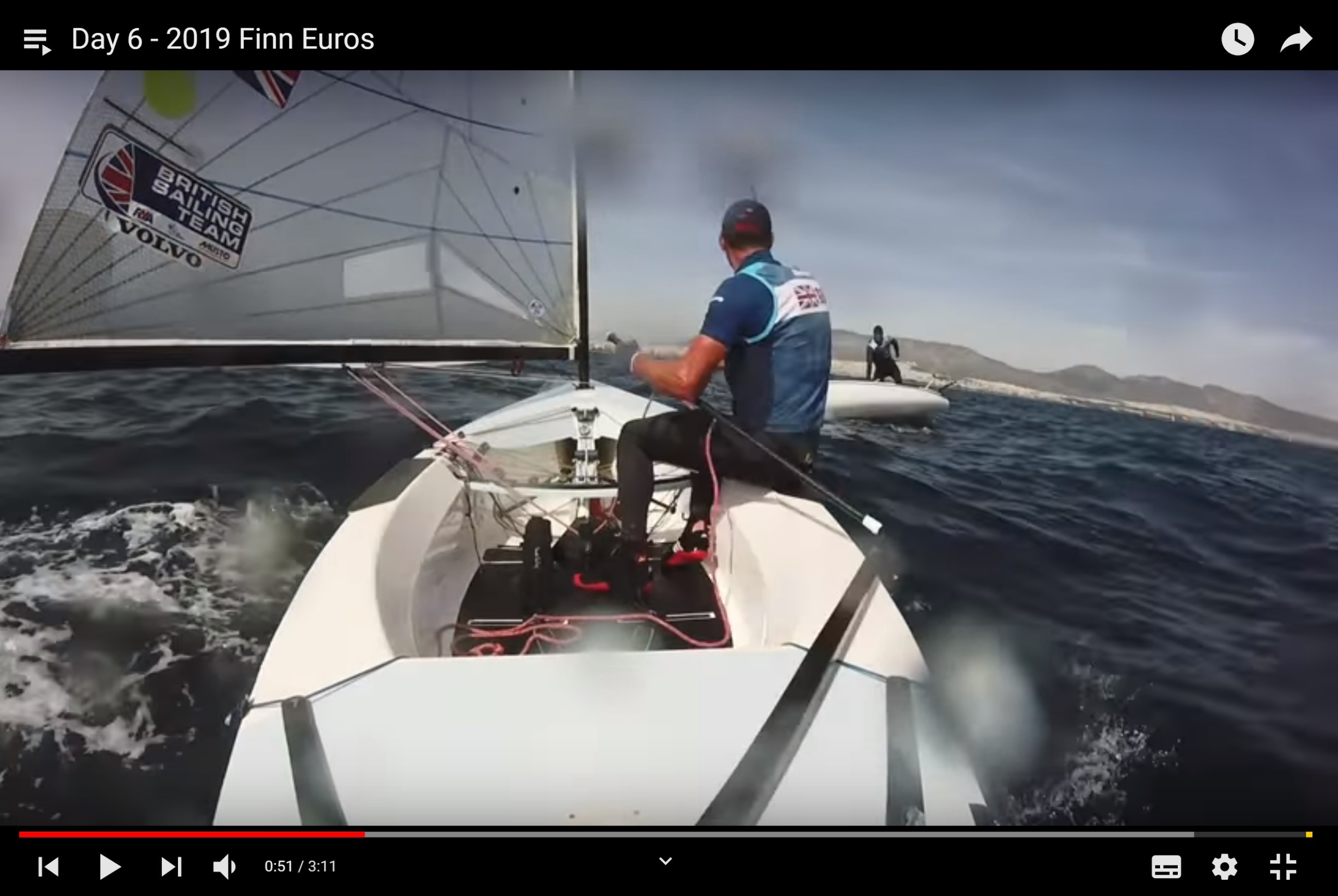

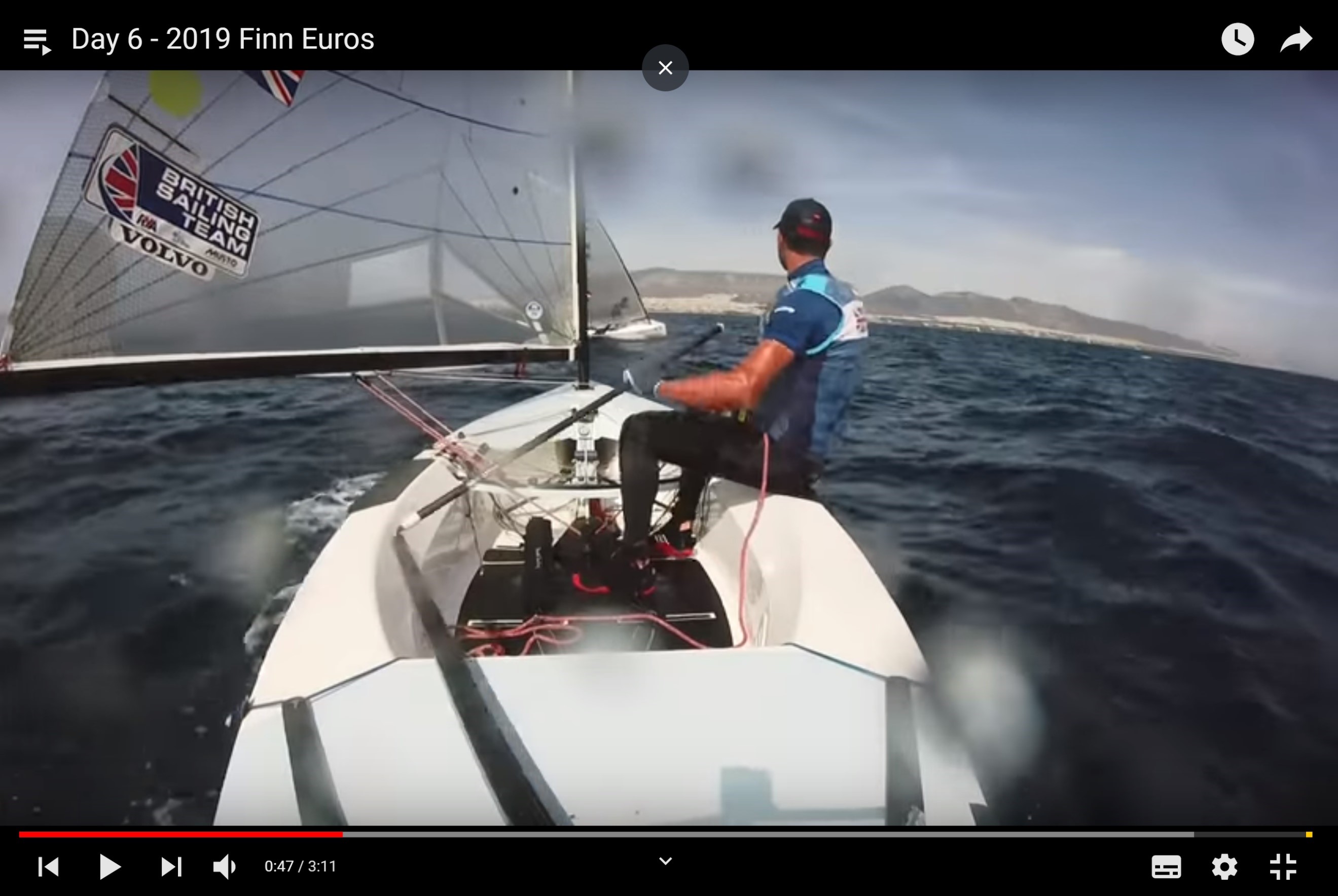

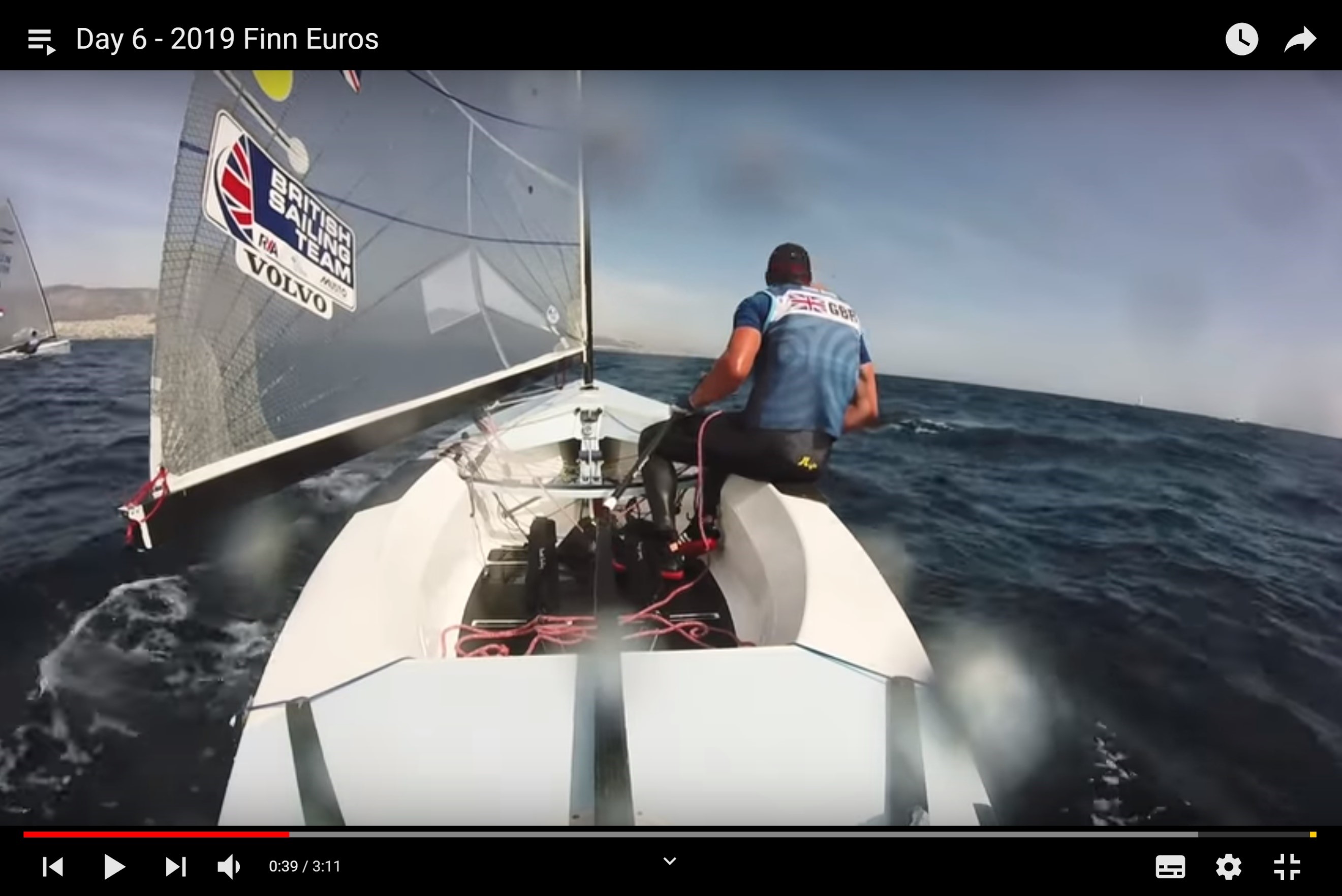

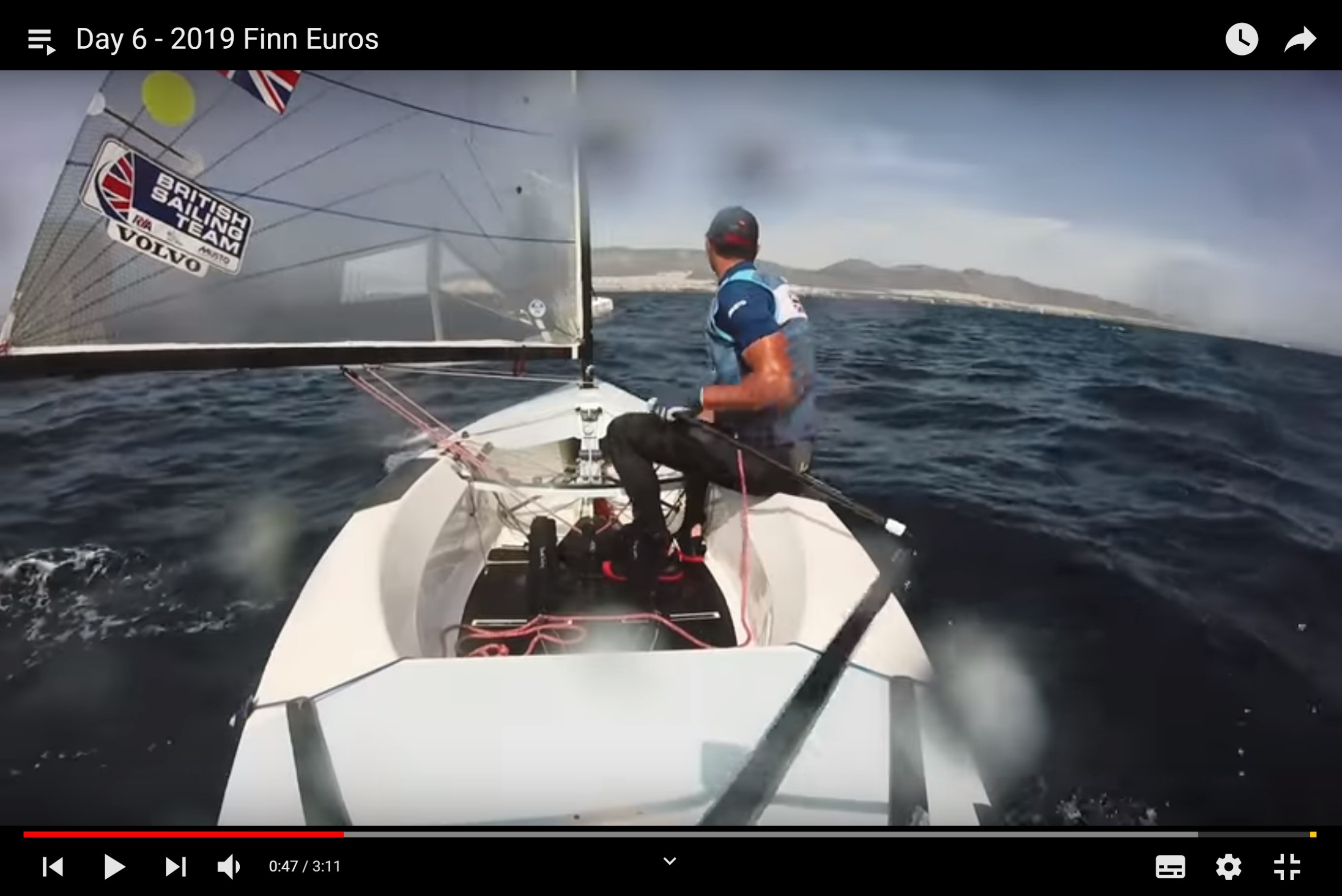

Presumably if this port/starboard event had happed outside of the zone B would have fouled A 9made her change course) ? Second scenario - Giles S (on starboard) put bow down when his opponent tacked (onto port) and then definitely altered course to prevent opponent sailing behind hi. The jury were on Giles side ? |

Posted: 03 Jun 19 at 12:26pm |
38 seconds "16.2 In addition, when after the starting signal a port-tack boat is keeping clear by sailing to pass astern of a starboard-tack boat, the starboard-tack boat shall not change course if as a result the port-tack boat would immediately need to change course to continue keeping clear." I'm not sure the other boat is ever sailing to pass astern because Giles drops the bow so early. So it forces the other boat to either try and cross, which is unlikely as Giles would come up, or tack back. Which is what Giles is saying to the umpire the boat should have done. ![]() ![]() ![]() ![]() ![]() Edited by mozzy - 03 Jun 19 at 12:32pm |
ohFFsake
Joined: 04 Sep 08 Location: United Kingdom Online Status: Offline Posts: 219 |
Posted: 03 Jun 19 at 12:46pm |
Far as I can tell from the video, Giles alters course twice.
The first time as soon as the port boat tacks, when they are still a considerable distance apart, so no rule breach there. Then the port boat alters course to duck and Giles bears away again to a new course. After this the port boat appears to hold course for 2 seconds before heading up to avoid a collision, which seems to be a bit longer than "immediately".
No rule broken? |
Guests
Posted: 03 Jun 19 at 12:56pm |
The other boat was given a penalty.
To be honest I thought the purpose of 16.2 was to prevent tactics such as these. Giles seems to change course a few times. I think the first bear away is just about okay, but at 50 seconds the Hungarian bears away further still to pass behind, at which point Giles almost immediately alters his course as well to bear away further. Maybe Giles forgot he wasn't team racing? I think he was lucky to get away with that.
