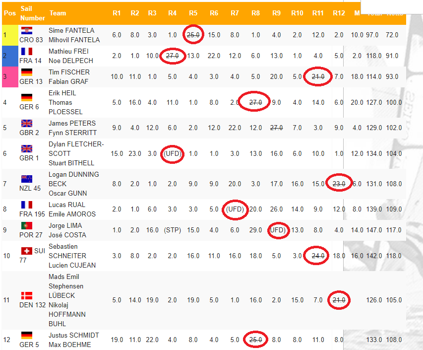

That seems to be the idea coming from 49er and Nacra class manager Ben Remocker.
"Because these classes race in relatively small fleets, and because the classes are so competitive that top teams often (almost always) have finishes deep in the pack, there is no reason to complicate scoring by having a drop race. The total, highest impact of putting in the single drop race was 12 points, across the three fleets of 49er, 49erFX and Nacra 17. When everybody is dropping a high score, the impact on the results is minimal." Seems a pretty valid argument for highly competitive fleets, but do you think it's valid for amateur championships too? What ratio of discards do you think gives the fairest result in championships and weekend opens? ![]() |
