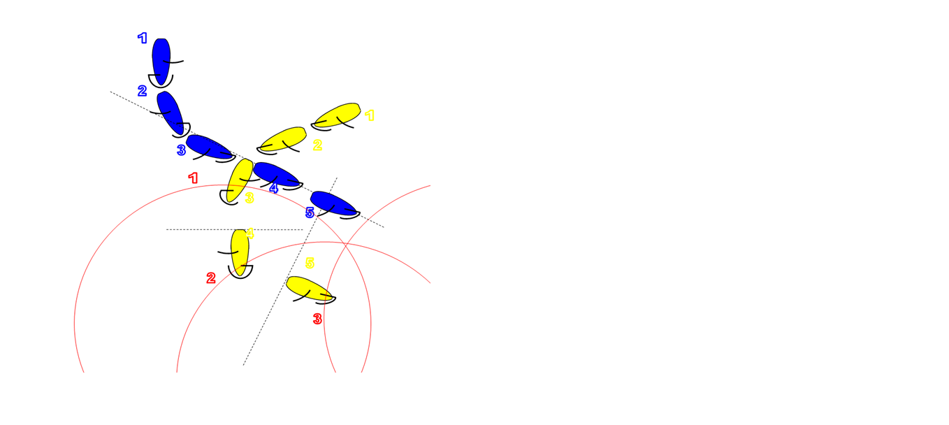

The starting point is understanding when boats in this situation are overlapped. See Definitions Clear Astern and Clear Ahead; Overlap
So, as is usually the case with boats approaching a leeward mark on opposite tacks, both boats are sailing more than ninety degrees from the true wind, the definition of overlapped applies and they will probably be overlapped. Whether boats are overlapped, clear ahead or clear astern, when the first of them reaches the zone is what determines the entitlement to mark-room. So, looking at the diagram @1 and @2, both boats are sailing below 90 degrees to the true wind, neither is clear astern of the other, so they are overlapped. @3 boats are still overlapped: B is not clear astern of the line drawn through Y's transom. @4, Y is clear ahead of B. @5, Y and B are once again overlapped. So, applying rule 18.2( b ). If Y reaches the zone @3 (Zone Boundary #1 in the diagram), then she has reached the zone overlapped inside B, and is entitled to mark-room, and any future gybes or changes in clear ahead/astern or overlap will not affect this entitlement. If Y reaches the zone @4 (Zone Boundary #2 in the diagram), then she she has reached the zone clear ahead of B and again is entitled to, and retains mark-room. If Y reaches the zone @5, she reaches the zone first, overlapped to leeward outside B, and B, as inside boat is entitled to mark-room, and as before any future gybes or changes in clear ahead/astern or overlap will not affect this entitlement. So to answer your specific questions. 1. If the other boat gybed within 3 lengths of the leeward mark do I have any rights? The issue is not whether the other boat gybed in the zone, but whether or not she reached the zone clear ahead or overlapped inside you, but if the other boat gybes in the zone, probably the situation illustrated by either Zone Boundary 1 or 2 above applied and you would be required to give the other boat mark-room. 2. If the other boat has not yet made 3 lengths when I become overlapped on him do I have rights? If the other boat gybed outside the zone and you were overlapped inside her when the first boat reached the zone, then you were entitled to mark-room. 3. How does the benefit of the doubt work here? Due to the angles we were sailing the other boat only became closest to the buoy just before I rounded behind it. I think once you understand about boats on opposite tacks being overlapped, there's not much doubt about the issue of which is inside boat. The test if NOT 'which boat is closest to the mark'. Consider two boats approaching a gybe mark on a beam reach, with the trailing boat only just overlapped bow to stern to leeward of the leading boat when the leading boat reaches the zone: leeward is quite a distance further from the mark than windward, but she is clearly the inside boat. It can probably be said, for boats, overlapped approaching a leeward mark, if the mark is to be rounded to port, the boat on the other boat's port side will be the inside boat and vice versa for a starboard mark. |

I'm having a few problems with this one!
Assuming that the assymetric was clear ahead, then Blue has to keep clear - however, if Yellow dives off to leeward (away from the mark), does Blue have to go wide of the mark to keep clear? (and call for additional mark room on the boats overlapped outside her) Tactically, if I were blue, I'd luff up and head for the mark - assuming that Yellow point higher to shut me out. Any other thoughts on how to hadle that event? Colin |

Thamks, Jim,
But 18.4 only applies to an inside boat overlapped. In the example above, the boat clear ahead has (I think) deliberately gone wide of the mark, dropped spinnaker/genniker and then gybed back. As Blue, would you follow Yellow wide (so as to keep clear of the boat that was clear ahead), take the risk and head for the mark, or argue that Yellow was now sailing away from the mark? Cheers, Colin |
