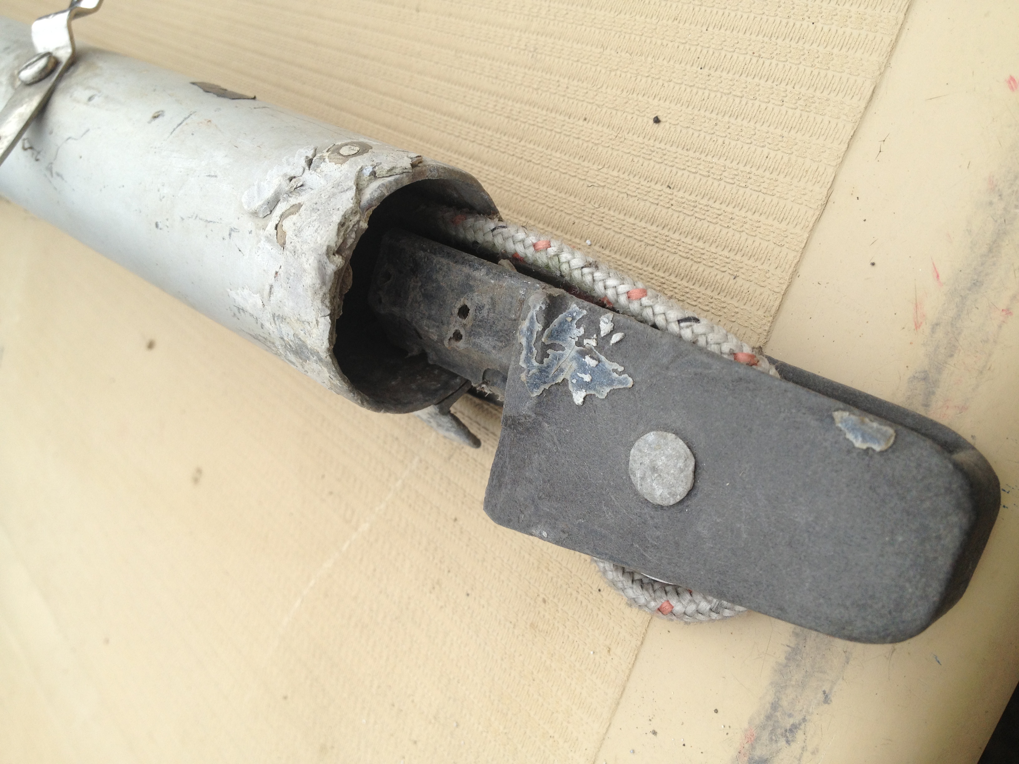

The masthead fitting on my old alloy contender mast (Wavelength) was certainly not welded. It was a fairly easy replacement job - the whole fitting came out - can't remember now if it was riveted or screwed, but you can see an old rivet in the pic up the thread.

I think it should be welded on with a weld all the way round.

PeterG View Drop Down
Joined: 12 Jan 08
Online Status: Online
Posts: 823
Post Options Post Options   Quote PeterG Quote  Post ReplyReply Direct Link To This Post Posted: 01 Aug 13 at 12:37pm
Looks like there was a rivet in there once and someone has stuck it back in with silicon, or similar.

Chimp View Drop Down
Joined: 30 Jul 13
Posts: 12
Post Options Post Options   Quote Chimp Quote  Post ReplyReply Direct Link To This Post Posted: 01 Aug 13 at 9:40am
Thanks it does look a bit Agricultural doesn't it!

winging it View Drop Down
Joined: 22 Mar 07
Posts: 3958
Post Options Post Options   Quote winging it Quote  Post ReplyReply Direct Link To This Post Posted: 01 Aug 13 at 8:50am
ah ok, that's the whole mast head - I was thinking just the sheave.  You should be able to buy a replacement.  Look at the make of the mast then contact a good chandler or the mast maker direct.  You'll probably need to measure the tip of the mast but if you say it is for a contender that should help.
Joined: 30 Jul 13
Posts: 12
Post Options Post Options   Quote Chimp Quote  Post ReplyReply Direct Link To This Post Posted: 01 Aug 13 at 7:31am
pic there are more but this shows whats what!
Joined: 30 Jul 13
Posts: 12
Post Options Post Options   Quote Chimp Quote  Post ReplyReply Direct Link To This Post Posted: 31 Jul 13 at 8:30pm
apparently its the wrong one anyway ! will post pics- where would i get a new one- does it have to be a contender one or will anything thatll fill the hole be ok?
