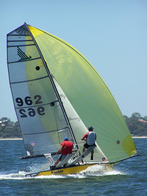

timnoyce
Posted: 06 Apr 09 at 12:26pm |
So like a sliding seat on a Canoe? Or are you thinking about having the pivot point in the middle of the boat, and then having it swivel from out one side, round the transom, and then out the other side?
Maybe a little Paint diagram to illustrate would be good here Grumph. There is a class of boat down under which has twin sliding seats. I forget the name of it right now but if I find it I'll post a link. Edit: Found it... Skate Edited by timnoyce |

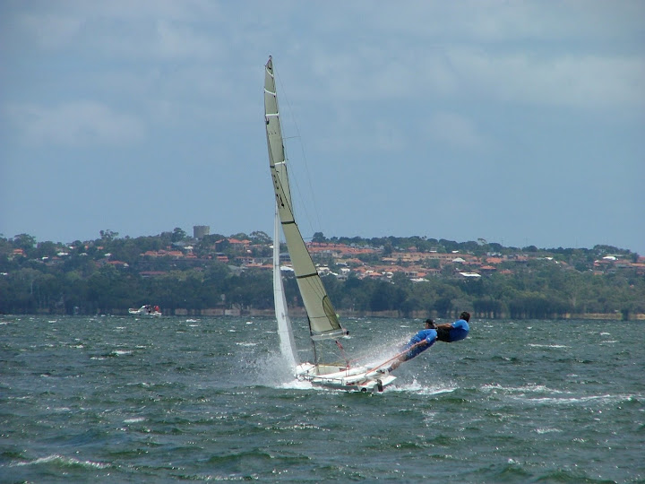

JimC
Posted: 06 Apr 09 at 12:35pm |
So you mean something like this? I'm not convinced of the advantages you claim!
![]() Edited by JimC |

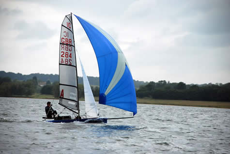

Merlinboy
Posted: 06 Apr 09 at 12:39pm |
Yeah Grumpf the international Canoe. They even do it with a 23sqr metr assy Kite. You can also fit one with a kick up centre board, and the dagger board cases have a special kick up system should you strike the ground landing. |
timnoyce
Posted: 06 Apr 09 at 12:40pm |
With that much righting moment they must be obscenely fast upwind when powered up! |
