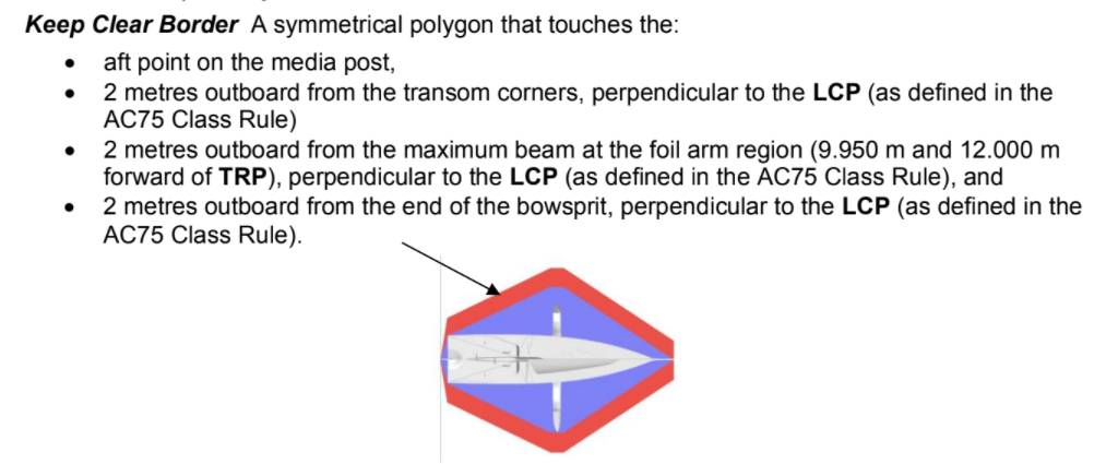

Originally posted by 423zero
Explains the rule apparently breached, to do with safety zones.
In my opinion the closest points of contact had Prada not luffed at the last minute would have been Ineos Transom to Prada port side foil. This would mean they would have had to have been within 2 meters of Ineos to get a penalty. To me they looked miles off of that.
Edited by ClubRacer - 24 Jan 21 at 5:59pm
