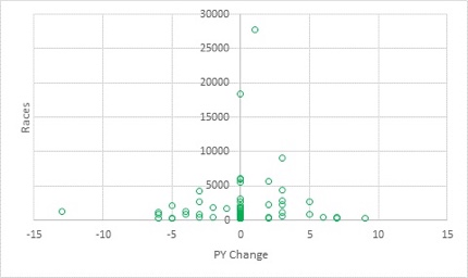

Post Options Post Options   Quote Guests Quote  Post ReplyReply Direct Link To This Post Posted: 11 Mar 19 at 9:38am
Top three (Laser, Solo and Radial) dominate the returns.
Post Options Post Options   Quote Guests Quote  Post ReplyReply Direct Link To This Post Posted: 11 Mar 19 at 9:42am
PY changes tend to be smaller with more samples, as you would expect.

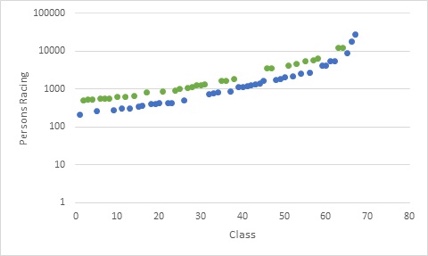

Post Options Post Options   Quote Guests Quote  Post ReplyReply Direct Link To This Post Posted: 11 Mar 19 at 9:46am
Shows the number of racers (ie number of races times number of crew). Two man boats (green dots) are still getting a lot of people on the water. Y axis is plotted as a log scale.
