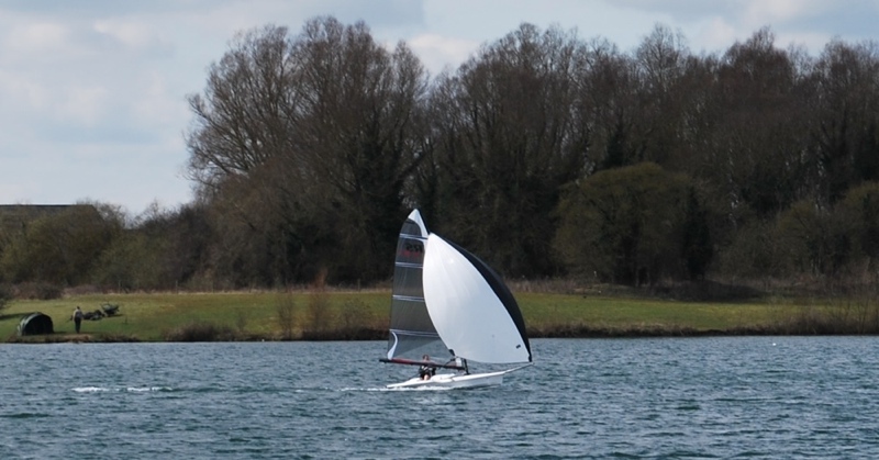

Thanks guys,
By the sounds of it a LOT more kicker is called for !!
Do you let the kicker off for tacking ?
Looks like a breezy weekend coming so plenty chance to try it out.
Tried to post a photo of me struggling upwind for some advice - my
linked images dont seem to appear for some reason.
Cheers
Chris30_213808_RS100_low_Res.jpg">

Second that. On the 300 we set up the gnav so that there is a bit of prebend in the mast when the kicker is fully off (blocks beginning to pull over the rollers). If you don't thave any prebend you will not be able to get sufficient kicker on upwind in a blow.
When Russ says use lots of kicker he means use LOTS of kicker. It's all about power management. If you're overpowered upwind pull on more kicker, if you feel underpowered let a bit off. In an unstayed rig leech tension, mast bend and therefore sail fullness are all interlinked so kicker is the primary control. From top end of force 3 upwards be prepared to pull the kicker on block to block. In a 300 this means that the top of the mast is behind your sitting out position (i.e. loads of mastbend).
The mastbend means that the top half of the sail is board flat (good) with power generated by the lower half. For this reason don't pull on much outhaul until it gets seriously windy as you'll need some grunt low down.
As an indication my avatar is in a force 2. This is the mastbend in a force 5. Note the angle of the kicker bars to the boom.

wow that is a lot of bend - do you tack with the kicker still on?

If I'm feeling agile (not very often), or panicked into making a crash tack (quite often), or I forget (very often). Usually, if the kicker is block to block I let off a bit (so that the blocks are about 3-4 inches apart) so I can get under the boom with it brushing over the top of my buoyancy aid. With this amount of kicker the leech is pretty hard so you have to be positive through the tack or else there's a risk you'll end up in irons.
