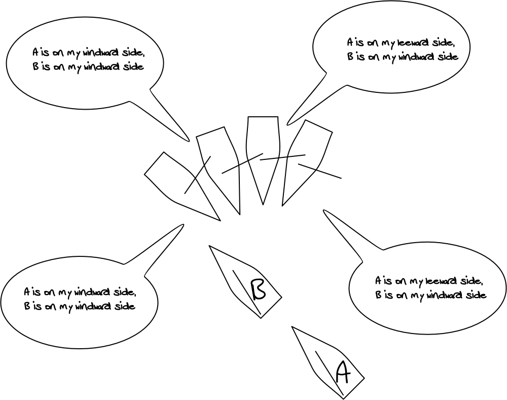

Post Options Post Options   Quote JimC Quote  Post ReplyReply Direct Link To This Post Posted: 07 Sep 18 at 12:40pm
Originally posted by Rupert
And that the upwind boat can become windward boat with a very small change of wind direction. Though this one makes my head hurt.
I don't get where you're coming from on this Rupert. The whole point of the definition about leeward and windward sides of the boat is that small changes in wind direction don't make any difference. Its the direction of the boats that makes the difference.
The situation where no neither boat is to leeward happens all the time, as seen from this sketch. But the point is that in most cases the boats will not be on a collision course, so we don't care. In my sketch only one of the 4 running positions is on a collision course with a boat on its windward side.
For the pedantic, this sketch is only intended to show 3 boats, one of them in 4 positions.
Edited by JimC - 07 Sep 18 at 1:21pm
Post Options Post Options   Quote JimC Quote  Post ReplyReply Direct Link To This Post Posted: 07 Sep 18 at 12:36pm
As Brass points out its basically a puzzle.
Even if this rather unlikely scenario comes up, and it is unlikely really, it seems to me that the key things are:
There is no circumstance in which the running boat has right of way, and the running boat is always obligated to avoid contact. From the running boats point of view the only difference is the subtle one between being required to keep clear and being required to avoid contact.
Similarly the beating boat only needs to be aware that it is just possible that they may get in a situation where they don't actually have right of way, and in that case if they fail to avoid a collision they will not get exonerated.
