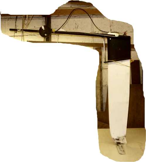

The major advantage is trapezing upwind in f3+ with both crew well aft, supported by the T-foil lift. There is less drag from the hull due to lower displacement, and this reduction exceeds the extra drag from the T-foil. The boat is now not very sensitive to crew position trim, the T-foil controls the trim angle. The lift varies hugely with boat speed ( proportional to square of the speed ), and so continuous angle adjustment is required. Some boats use foils fixed to the blade, adjustment by raking pivot pin, with string/cleat adjustment. Alternatives are adjustable angle foils, controlled by twisting tiller extensions. ![]() twin extensions rotate shaft attached to drum attached to cable attached to crank attached to long push rod inside blade attached to lever arm attached to shaft attached to foil blades . - simple really ! This setup enables the blade to be fully retracted for launching etc. |

& oh, Aquas & Primals foils are very easy to make - fixed "T" on the rudder blade and just knock the rudder stock back and forth! No little fiddly bits to go wrong, sorry Andy, not aimed at you, but if I tried making yours Id prob Fek it up!!!
yeh i was going to say that next, my old foil on the moth was fixed and as are most low rider t foils and they have there own benifits when it comes to inducing planing aswell quite technical but just cause they are fixed does not mean to say they are at a disadvantage
