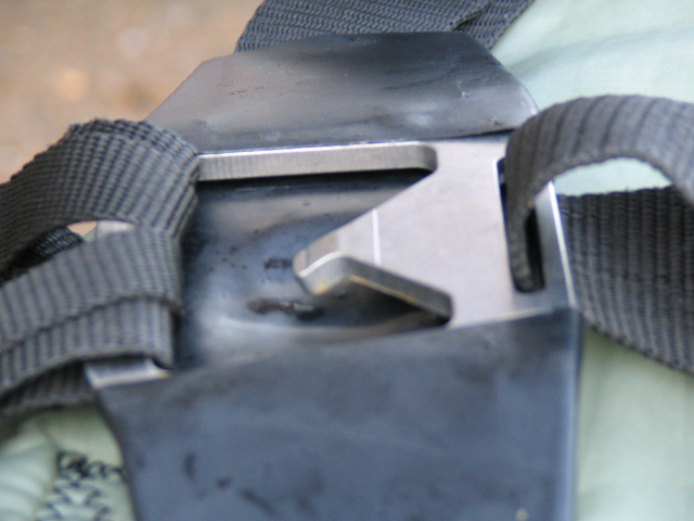

What is a Waddington Flat Plate Hook ?
I think it's a flat spreader bar with like a triangle hole cut out projected a bit forward with a bit pointing down to accept a normal style tapeze, there's a guy in our club has one I've been trying to find a source for them after I punctured my deck scrambling to get back over the side.
Seem to recall they were originally built by a company over Chatham way, but can't for the life of me find them now. Edit picky here from this forum circa 2009 Edited by iGRF - 19 Sep 18 at 2:01pm |
