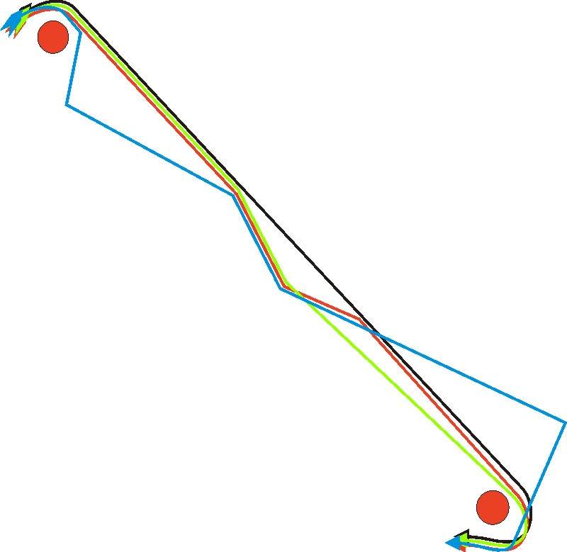

![]() Here's how I see it... Black line being the two sail boat, ignoring the luffing match before hand. Blue. Blue boat was sailing hotter angles before the boats meet, continues sailing hotter angles afterwards. Legitimate, and the common situation. Green Line Green boat was sailing on rhumb line before the boats met, and once she gained an overlap sailed on the new rhumb line, which was higher than the old one. I'd say legitimate. Green is on a proper course for the mark. The fact that she was sailing below a proper course for a while doesn't matter, there is no obligation to sail a proper course. Red Line The red boat was sailing on the rhumb line, went deep then pointed up when they gained the overlap but went back to the original rhumb line when clear ahead with clear air. Not legitimate. Sailed above her proper course for the mark whilst overlapped. Edited by JimC - 21 Dec 14 at 11:13pm |
