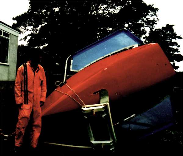

My first moth was a Magnum 3, which is much wider at the stern
Note the cool motorcycling suit  Cool

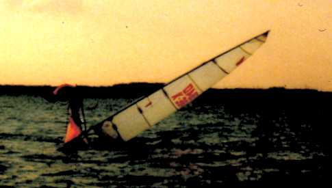

And first time out -
I did a tack to point it back in before capsizing - much skill  Wink

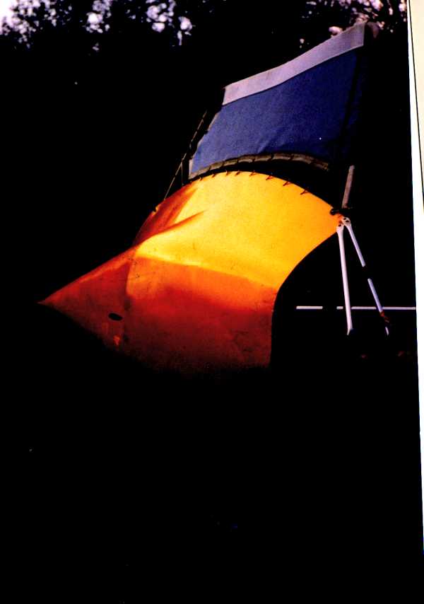

And being me... I just had to chop it - to the same transom shape as the Magnum 6 ( the fastest design at the time ) - it greatly improved the performance, less nosedives and faster, but then of course the good guys were on to the Magnum 8, and I remember being lapped at Hythe Euros in 1987 - Just ask Grumpfs - he was race officer!
