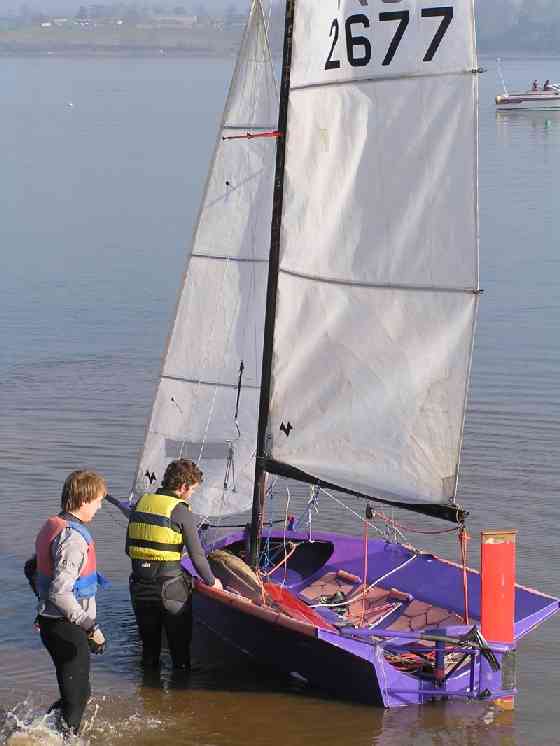

For those who are interested in the beast there's a new photo I've just got on the front of the website that shows up the incredibly small bow wave I get on the beast(and my tasteful colour scheme [grin]. This is sort of forced mode/marginal planing speeds upwind. There seems to be a fineness of bow where you get this effect, I know Frank Bethwaite has seen it too. http://www.cherubpres.f9.co.uk/plusplus/. Oh and (shameless free ad) the boat is kinda for sale at the moment should anyone want a flawed but rather interesting one off. Could also be readily converted to a two hander with a jib (and kite). Doubt it would measure to I14 rules though.

Post Options Post Options   Quote TheSeaFalcon Quote  Post ReplyReply Direct Link To This Post Posted: 22 Jul 05 at 7:37am
That is nice beyond nice! I love it, but sadly I have nothing like the money needed for buying it!  Well, maybe another time! Did you just build that yourself then from bits of other boats, or is that a recognized boat?!

Posts: 5984
Post Options Post Options   Quote JimC Quote  Post ReplyReply Direct Link To This Post Posted: 22 Jul 05 at 7:45am
Neither! The hull shell is to my design by Bloodaxe boats, mast and sail were commissioned specially for it, I did all the fiddly bits myself (which saves a heap of money over getting them profesionally done.)
