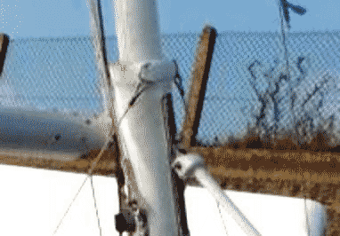

Post Options Post Options   Quote JimC Quote  Post ReplyReply Direct Link To This Post Posted: 16 Mar 06 at 9:07am
Don't use the plate is the simple answer. Use stainless steel D rings bandaged onto onto the spar with unidirectional carbon.

Post Options Post Options   Quote Isis Quote  Post ReplyReply Direct Link To This Post Posted: 16 Mar 06 at 1:04pm
Id second Jims suggestion here
