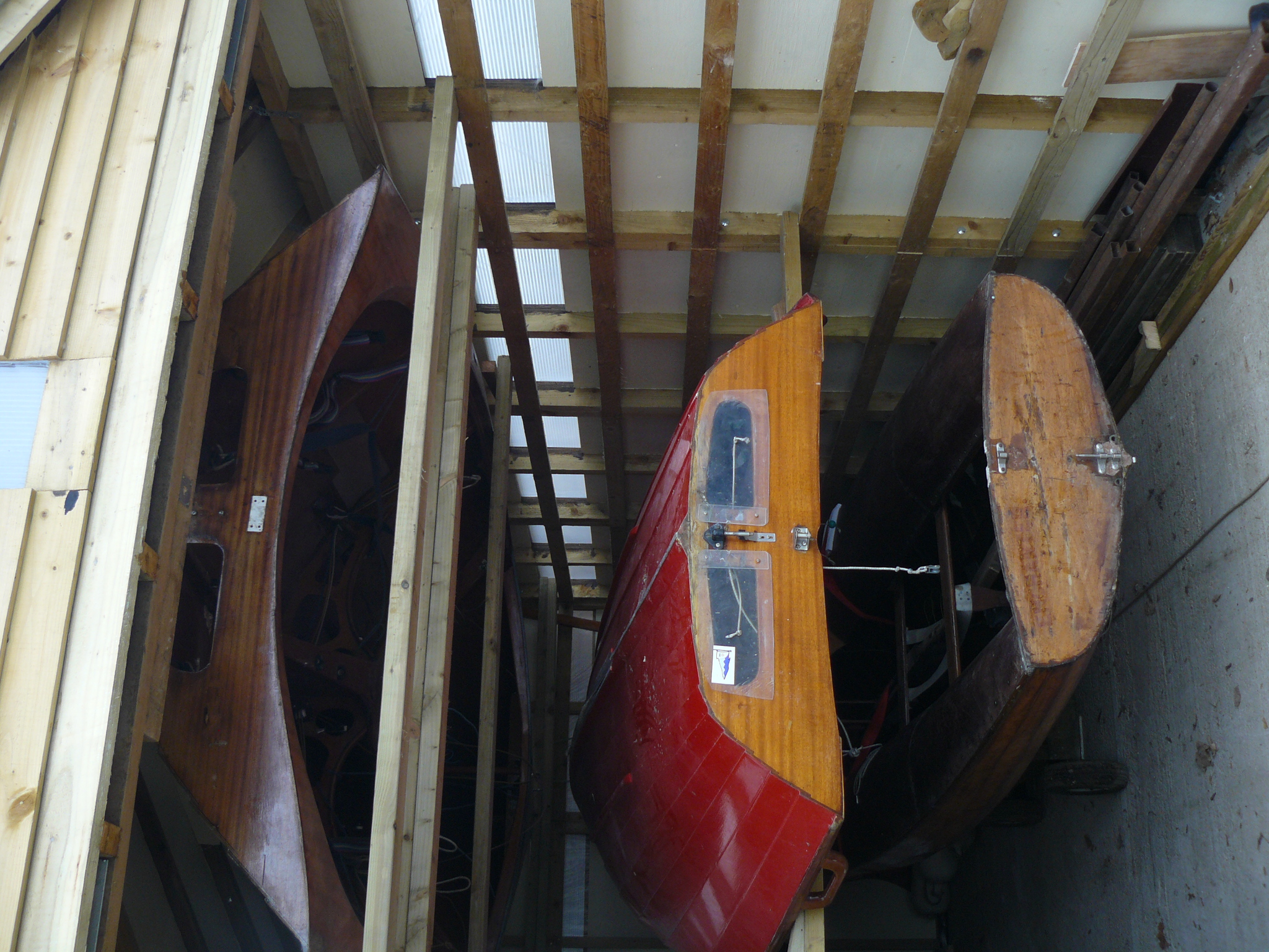

We have built a shed with ladder bars along the sides at about 1ft height gaps and the Merlins are simply turned upside down and raised at one end and a length of 4X2 put between the ladder rungs of each side. Then go to the other end and lift that and add a support timber. Repeat the lifting of alternate ends and moving up the timber until the boat is in the roof area. Add a few more timbers and metal braces to secure.
Then the second boat goes underneath in the same way and the third boat goes below that on its trolley. Result is three transoms for Dougal.
