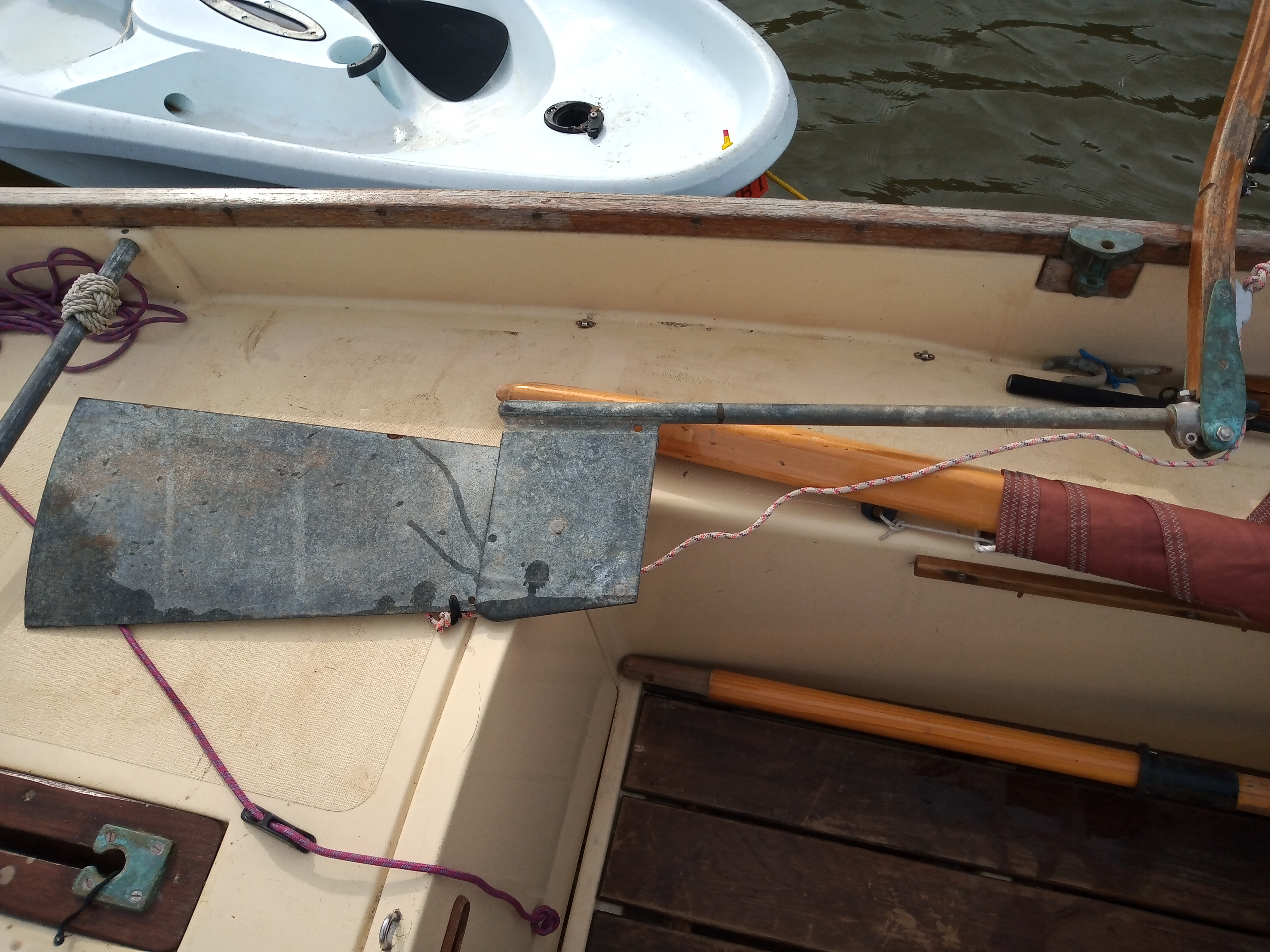

Post Options Post Options   Quote Riv Quote  Post ReplyReply Direct Link To This Post Posted: 02 Aug 20 at 9:26pm
The offending article.
This is as it would be hanging under the boat. You can see the top bearing bottom left of the picture and the narrow slot the stock will slide down,

Post Options Post Options   Quote Brass Quote  Post ReplyReply Direct Link To This Post Posted: 03 Aug 20 at 5:02am
Originally posted by Riv
The offending article.This is as it would be hanging under the boat. You can see the top bearing bottom left of the picture and the narrow slot the stock will slide down,
What a fearsome piece of ironmongery.

Do you think the top bearing engineering needs that weight to keep the rudder and its post properly seated and immersed?
What would be the effect on fore and aft trim if you replaced it with alloy? Would you have to remove the half hundredweight CQR from the forward compartment?
