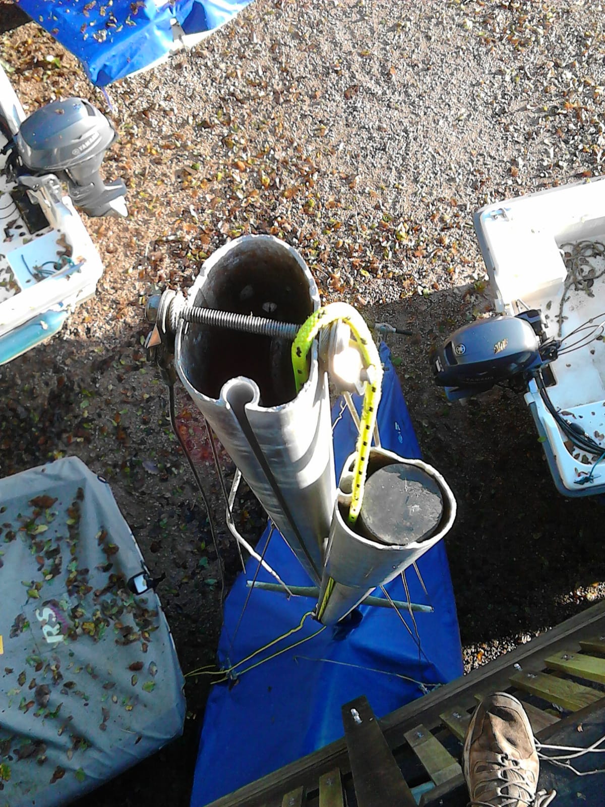

Our club L2 blew over and mast has cleanly broken just above the shroud bolt.

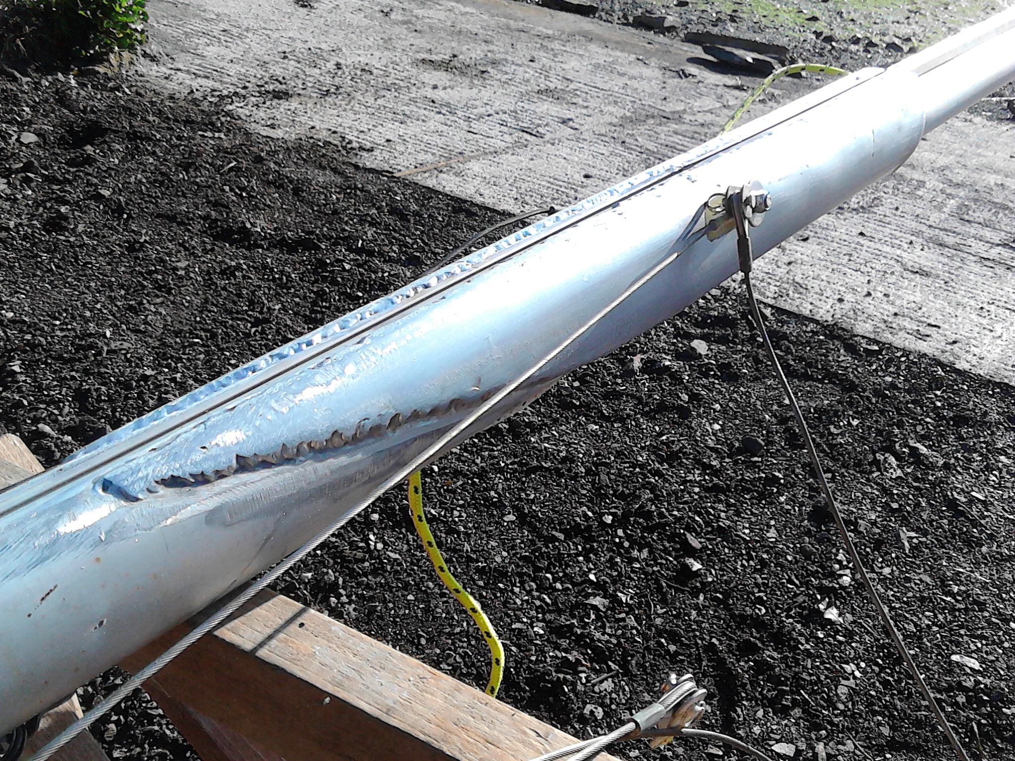

Update, we found someone local to make a sleeve for the top of the mast to join the broken short top section to the lower part. All went fine, the top mast fitted back in after a bit of filing (this is due to the welding distorting the mast section a little, which was my main worry). I designed it with a slanted end to spread the load over as big an area as possible.
At 160 it was by far the cheapest option, a new mast from Selden was about 800 inc vat and that's just the plain tube, nothing else. I could have got another mast but it would have come with a free boat that I would have had to chop up and sneak into the recycling.
We'll see how it goes this year.

Welding's a bit agricultural but looks strong and hopefully no one will be inspecting the top of the mast that much:)
