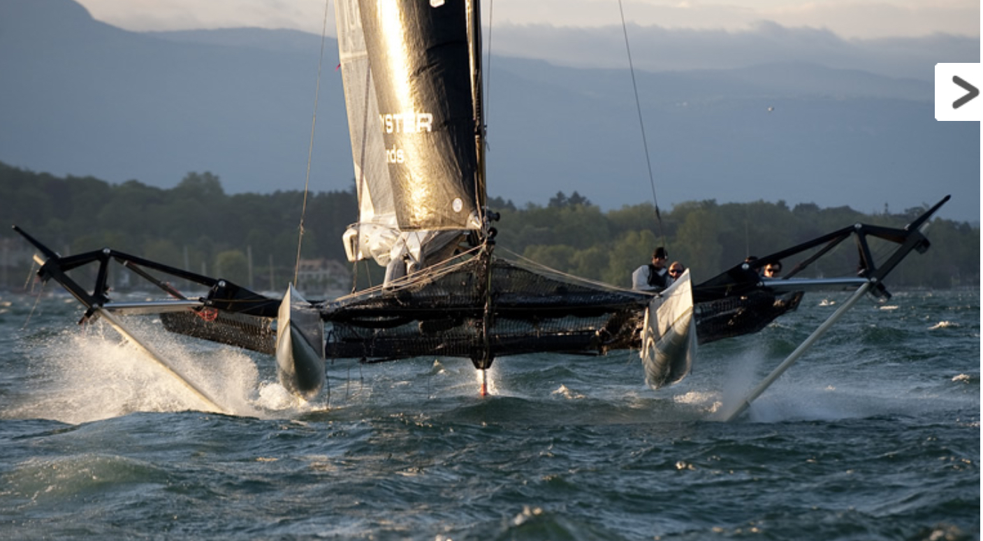

Originally posted by tink
Not fully upwind but I think in illustrates my point†
Looks more like broad reaching looking at the water and sail trim. Syz & Co (think that's the boat) got lots of photos in the sailing press for a very short time and then vanished, which probably speaks volumes.
I think the three point foiling is a nice idea if you're just looking at going in a straight lines. Suspect with the moths that even if the 'piv' foils hadn't been outlawed that ultimately they'd have moved to centreline foils as a better solution for all points of sail.
