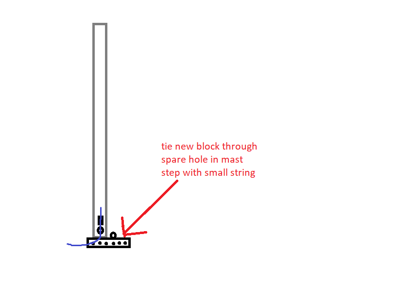

Replace the cleat with an anodised version not the cheaper silver one Move the (I assume you use a bobble in the end of it) 6 inches so the rope cleats in a new spot at the bottom If the halyard even remotely looks worn/old just replace it with some 4mm Kingfisher evo race (has to be dyneema core or kevlar or it will stretch/snap). The mast is 7m~ long so 15m will give you plenty. Every 3 months chop 6 inches off, every year end for end it, every 2 replace it. Always make sure the cleat gets a wash after sailing as they don't take much to start corroding. Obviously this differs depending on how much use it gets. If yours is anything like mine the location of the cleat + block means you cant pull the halyard up without it going through the cleat. If so then tie a new block onto the mast step and route it that way. Pic below |

Are you sure?
The cleat should line up with the front side of the exit hole, so offset by about 5mm. If you hoist with the halyard out of the cleat and to aft of the cleat it will run around the cleat. The offset isn't obvious, but is there. But even without the offset it should be possible to hoist with it out of the cleat and not going in, just there will be a tad more friction as it bends around the outside of the cleat. Its not a massive issue if you hoist through the cleat, but you'l probably be replacing it each season. I've never had to replace mine, and that's with the silver version. |

Post Options Quote Reply Posted: 20 Nov 18 at 8:38pm |
It was the friction I didn't like. The additional benefit of attaching the block to the mast step is that it wont eventually pull the rivet from the top of the lacing eye out the mast and leave a gaping hole

Ha, yeah, no pulling the block off is something that's happened to me, trying to hoist without it in a rush for race!

Thanks all for your responses. I think a new cleat and potentially a new block on the mast step is in order. Particularly as the block has already come off!
