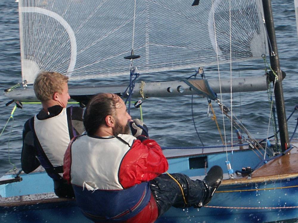

I believe its specially heat treated, I'm not sure its a standard grade. I have used standard grade alloy for a boom when I was broke though, I used 4 inch and cut lots of holes in the less stressed areas for weight and it lasted for years.
The holes are mostly behind the sleeve for the mainsheet, but you get the idea... Edited by JimC - 18 Sep 18 at 9:04pm |
