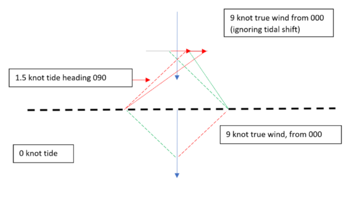

Post Options Post Options   Quote Guests Quote  Post ReplyReply Direct Link To This Post Posted: 18 Oct 17 at 9:27pm
My diagram wasn't showing a change in wind direction over time, like a lift which happens just after the start. It was showing a permanent shift in breeze from the true wind direction.  Neither of the boats changed their position relative to one another, it's just that the boat at the starboard end was upwind. Ahead and always ahead.

There is what I've called tidal 'drift' for want of a better word. All boats being swept across the course are so equally.  But there is shift that occurs due to the tide caused by the boats being moved with the tide. This creates a gain feature. It why you likely got ahead in that windsurf race.
Using diagrams and vectors is not 'misleading'. It is the opposite and quantifies the effect I am describing without using ambiguous language.

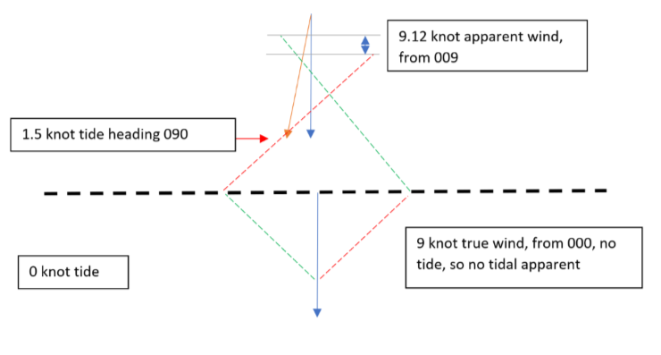

So, here’s one last try. I’m going to break it down in to bits, to separate the different tidal effects to show exactly where a gain would occur, and how you can use it in strategy.
Below is a scenario where two boats start from the exact same position, but one goes left, and one right up a beat. They then cross a tide line and tack back to the centre to see who made a gain. There is no current at the bottom, they then cross a tide line in to left to right tide.
So, first of all we have what I shall call here ‘tidal drift’. Both boats hit the tide at the same time and tack back toward the centre of the course. Both boats are swept right by the tide, skewing the beat so that they spend less time on port (if the mark isn't offset), and they sail a lifted course but slower speed over land on starboard, and headed course at faster speed over land on port. As the tidal vector is left to right, it doesn’t affect the progress they make upwind and their positions relative to one another stay the same; they both just get shifted equally to the right. As you can see from the grey gain line, both boats are still equal when you account for 'tidal drift'.
I believe this is what you are saying iGRF? That the tide will sweep boats across the course. Their course (relative to the land) will appear lifted on starboard, but neither will make a gain relative to one another.
If there is anything tactical to take from from this it is that you may be swept across to the starboard lay line quicker than you anticipated. But there aren't any gains you can make from creating leverage on other boats.
Now, what I was describing with my earlier vector diagram was a 'tidal wind shift'. But I used it in relation to bias on a start line. As described in the video I posted it can also be felt as a shift as tide changes up a beat. By being the correct side of this shift you can gain actual positions, just like being on the inside of a shift in the true wind. The boat that goes right in this situation is on the inside of the shift and makes gains. The result is a tidal wind shift lifts the boats course over water; from which real gains can be made.
The shift, as I explained in previous posts is caused by the tide moving boats across the true wind, creating an apparent which is more from the right compared to the bottom of the beat (see vector posts).
The diagram below only shows what will happen to the boats because of the tidal shift.

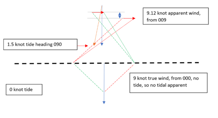

Now, you can add the tidal 'drift' to the tidal 'shift' by adding on the tidal vector for the top of the course. But, as demonstrated in the first image, tidal drift just moves the boats across the course to the right. You can see that boats now end up further right on the course, but still the only gain is made from the shift in apparent.
So you can see, knowing that the tide will move you across a course is fine (top image), and you can bear that in mind when calling laylines or staying in the centre of a beat; but it's not a 'gain feature'.
The knowledge that tide can increase or decrease apparent wind seems obvious (everyone knows wind against tide makes the wind stronger, don't they?). But also knowing that the tide can shift the apparent wind direction is most important for a racing sailor, as this shift you can leverage for actual positional gain (second image).
You can sum this up as "get the strongest tide on your lee bow". Which is then miss interpreted by people who think this rule of thumb means to point higher to get the 'bow up' over the tide. What it really means is to tack on the apparent wind shifts created by changes in current.

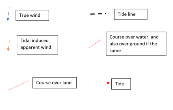

Key
