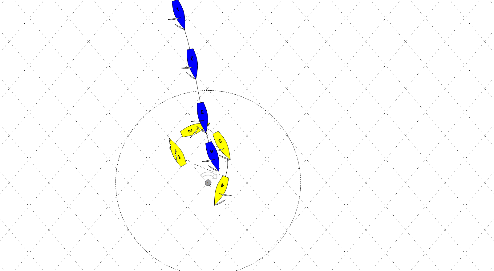

Really should get out more Joined: 24 Mar 08 Location: Australia Online Status: Offline Posts: 1146 |
Post Options Quote Reply Posted: 08 Apr 17 at 9:04am |
I'm not grasping the problem you seem to foresee. Does this show the scenario you have in mind? You say ... the boat that has left the mark on the wrong side has to 'rejoin' the traffic from a position where in any normal circumstance it would have mark room because he's on the inside. But it doesn't! That's not quite right. As long as the boat that tacked is overlapped inside, she is entitled to mark-room (rule 18.2( a )). The approaching boats gain no unusual 'rights' unless and until they become overlapped inside. The only 'right' Y loses is her right to exoneration if she doesn't keep clear of B when obliged to do so. @2, Y is right of way, leeward boat (rule 11). @3, Y is right of way, clear ahead boat (rule 12) @4, Y is right of way starboard tack boat (rule 10). @4 + delta, B will become overlapped inside, and gain mark-room and exoneration if she fails to keep clear of Y. If B comes steaming in and Y can't get her stern out of the way, starting no earlier than when the overlap began, then Y, now outside, will have been unable to give mark-room from the time the overlap began and is not required to give it (rule 18.2( f )). Certainly, once B gets overlapped inside and entitled to mark-room, Y may not be able to come up to course as quickly as she would like, but that's just the disadvantage she earned by muffing her mark rounding in the first place.
JimC
Really should get out more Joined: 17 May 04 Location: United Kingdom Online Status: Offline Posts: 6649 |
Post Options Quote Reply Posted: 08 Apr 17 at 9:29am |
And at 4 + Delta Y cannot turn to port to give B mark room because transom will contact, and Y cannot turn to starboard to give B mark room because middle of boat will contact. So Y is not required to give mark room. It seems to me the only time Y is required to give mark room to B is if she has already left enough space between her and the mark that there is room for B to slip through, in which case there isn't a real problem.
