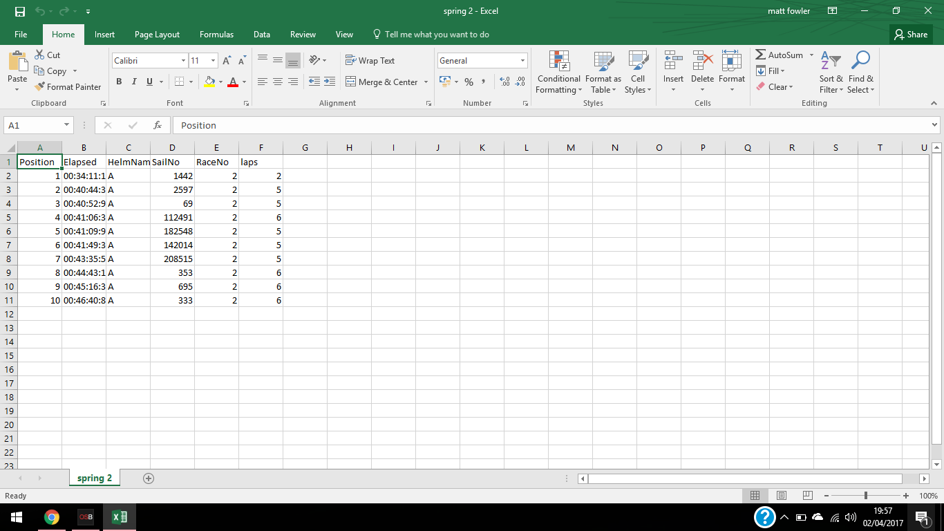

Post Options Post Options   Quote ClubRacer Quote  Post ReplyReply Direct Link To This Post Posted: 02 Apr 17 at 7:59pm
thats what the csv file looks like,
writing a sum is only good if all cells in that column need the time reduced or they're grouped together
im currently already deleting the ones that aren't needed for the designated finish and reversing it for the 2nd one
