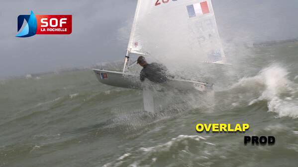

I hope you're not being serious?
Looks pretty bow up to me ...
That's because a lead mine has hit a wave!

the Emperor says that's not bow lift from a kite, this is bow lift from his new kite....
