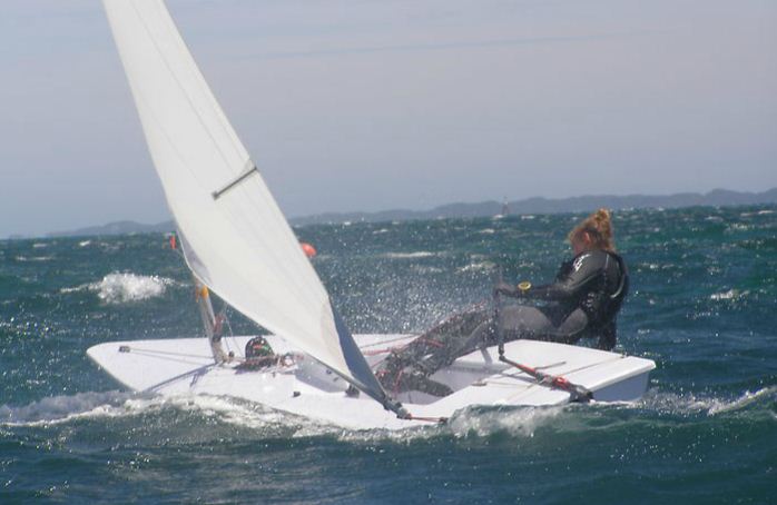

Thanks Ben that's very helpful, I think this photo of Marit shows what you are trying to describe with the mainsheet blocks:
http://4.bp.blogspot.com/-DEtDDd0zgwk/Ts4j4O9jNcI/AAAAAAAAAmU/I-1PTOa9hK8/s1600/Marit+Boumeester.JPG
What the photo doesn't show is the amount of boom bend she is carrying.
I really need to get hold of a legal bottom section and try it again, taking note of your warning.
With current set up I can put horrific boom bend on but the blocks are still no where near each other.
I will check position of the double block at max off, interesting what you say about dropping a purchase out, are there any photos that show this?
