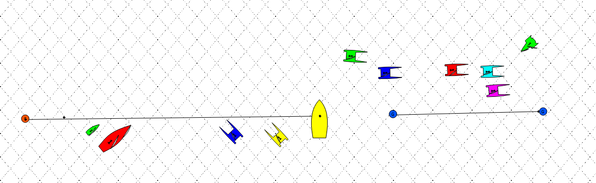

So, odd one today at Grafham. Scene setting, preamble: Morning racing is run with the asymmetric fleet doing windward-leeward, using the leeward gate, positioned to starboard of the committee boat (looking up the course) as a down wind finish line. Meanwhile the other fleets, using the same windward mark, do a round the can course, finishing upwind to port of the committee boat. Racing is average lap Today the morning racing included a 2-race Sprint 15 traveller. They were using the RTC course. Quite a few visitors. Over on the asymmetrics, in the B14 despite being rusty we were cheerfully flying, and had opened a healthy gap (as we should) on a 400 and 4000, and a lap on the 2000s and 200. So much, that the RC put the S flag (finish at end of lap) just after we passed through the gate (so they could start finishing Lasers etc). So we head off on an extra lap more than everyone else, hoping that the wind stays up, whilst boats finish. Down the run we're hooning along, and screw up a gybe near the bottom of the run. We take ages to get upright (bit rusty!). Lots more boats finish. Upright, we decide that we're close to the line so go two sail towards it. Quick tack, off at an angle, tack again, approach line on starboard. Situation: We're approaching the finish line (green winged monohull) between gate marks G. A gaggle of Sprint 15s are stalled out on port tack across the length of our line. Our calls for "starboard" and "we're trying to finish" are met with bafflement- I later figure they're visiting boats and poorly briefed Having to take avoiding action didn't, realistically, have an impact on our finish position, what with the lengthy capsize. It potentially could have. If they'd been there as we tried to finish with the spinnaker up, we'd almost certainly have had to round up hard, probably capsizing, to avoid a collision if they'd been so sluggish. If we'd protested, what result could actually have been achieved? They weren't racing. They seemed unaware they were blocking our race course. On a simple level it was port-starboard, with us on starboard. But could any action have been taken against them? I guess at least a talking to might have been useful.

From the preamble to Section 2 of the RRS
So RRS apply. Quite what penalties apply I'm not sure. Edited by JimC - 16 Mar 14 at 7:31pm |

So they are breaking rule 10 (P/S) AND rule 24.1 So, if validly protested they can be penalised.
Al said So dinging visitors who weren't aware they were interfering when it didn't make any difference to your race would be unwelcoming, and using your discretion not to protest seems like a good idea. But for arrogant or lazy locals who are sprawling all over your race course: rule 24.1 is the way to go.

So if I get in the way one Sunday when out for a cruise, a protest could impinge on my result the following weekend?
Or are we, more logically, only dealing with boats who are waiting around between races? I have been in plenty of multi fleet events where boats which have finished end up in the way. As protesting a boat in a different fleet would on the surface seem pretty futile, I've never done anything abut it. But maybe it would buck up the ideas of the rest of the fleet. |

If someone who should know better screws up your finish, then protest them under rule 24.1. If it's a prevalent problem, then complain to the Race Committee and they can take some action such as putting a reminder in SI or a notice to competitors, or creating a closed finishing area.
