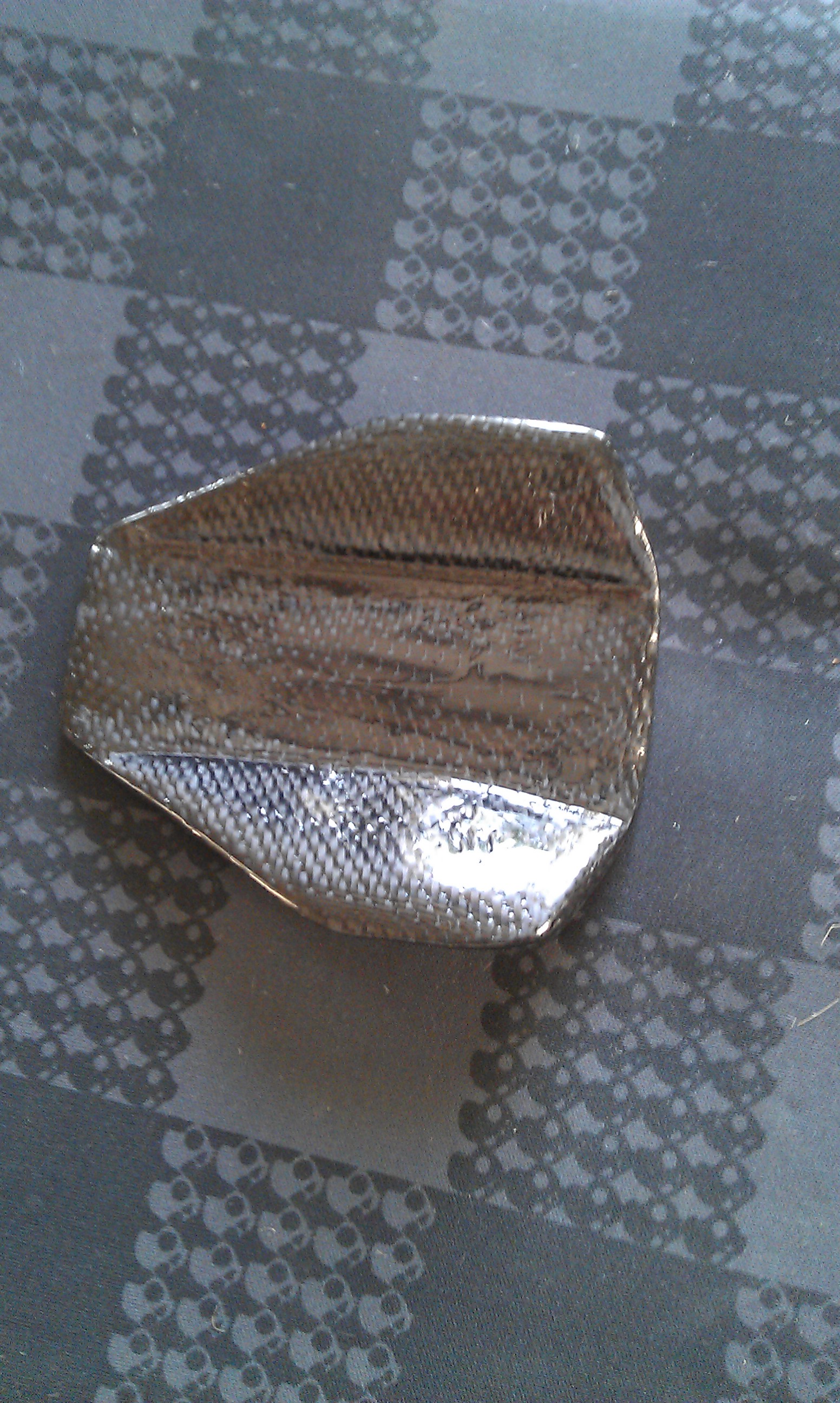

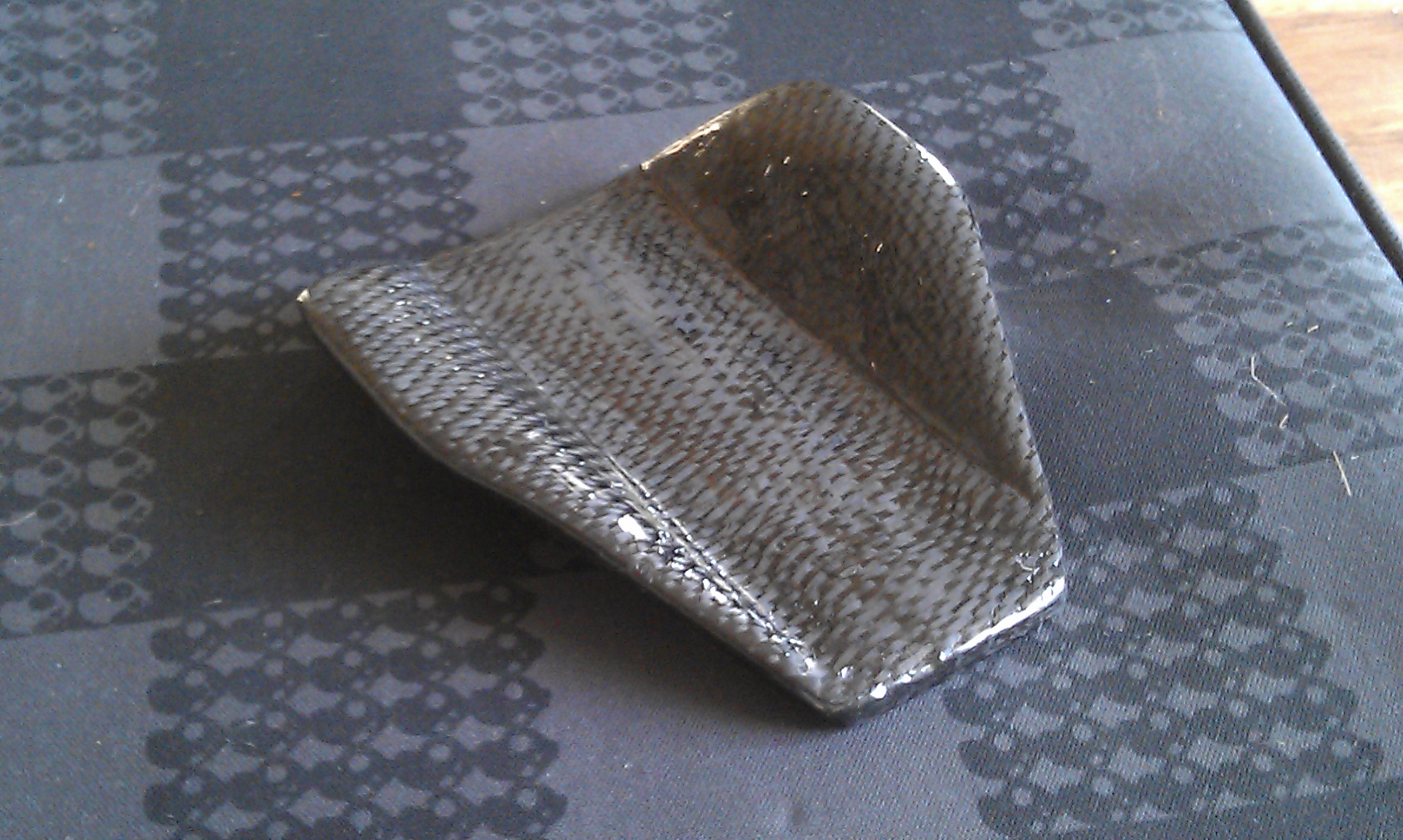

Would be interested to see the mast plate. What is it made from, and how did you made the edges neat?
E.J. View Drop Down
Joined: 19 Feb 06
Posts: 182
Post Options Post Options   Quote E.J. Quote  Post ReplyReply Direct Link To This Post Posted: 27 Jan 13 at 11:28am

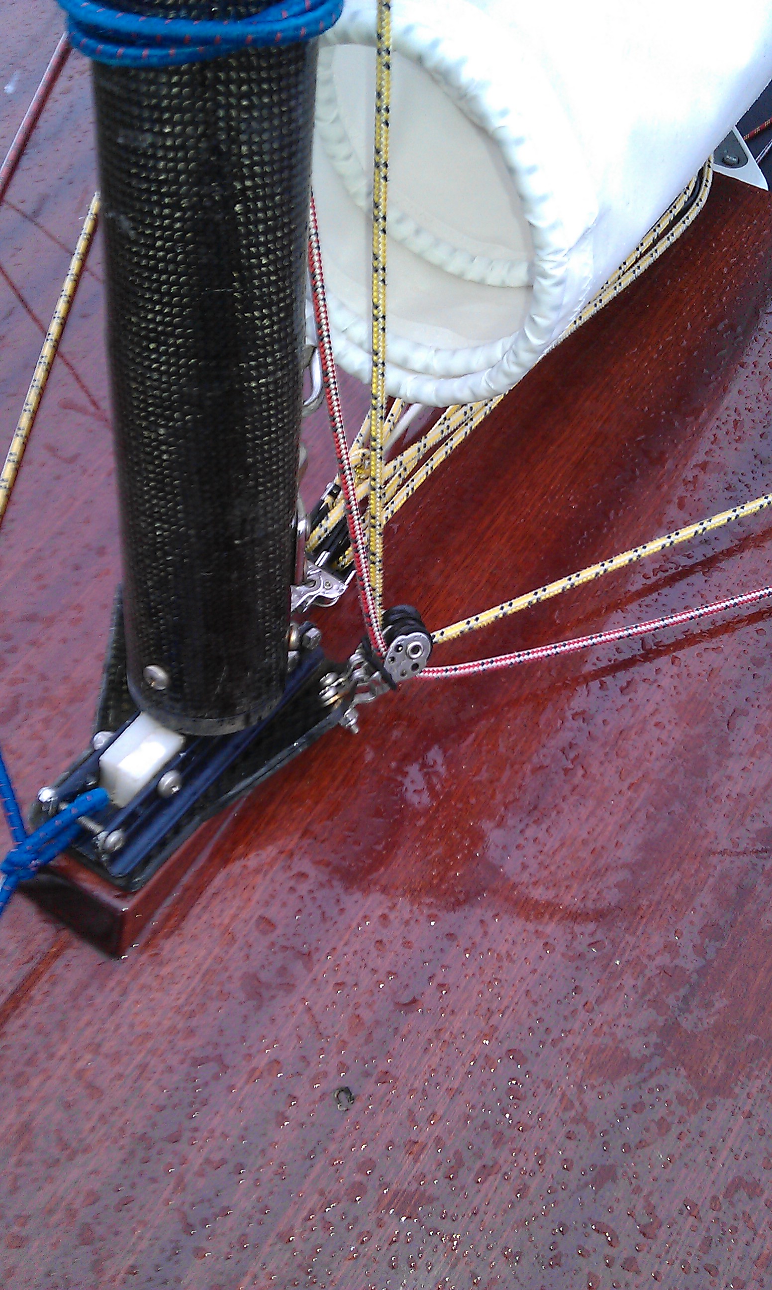

Its really simple, just a Carbon plate with angled flanges so I can attach 2 small blocks on each side and avoid having to fix them to the deck. The Mast step will sit on top of the flat portion in the middle.
In terms of neatness; trial and error. I made a mould from cut tiles that I could clamp tightly, then when it had set I hacksawed it into the general shape I wanted and wet and dryed it to smooth the edges, I finished it with a final thin coat of epoxy to cover up the obvious amateur nature of it , and polished it up. I'm quite happy with it but on closer inspection you can tell it was made in a shed rather than a factory! the finish is a bit uneven.
