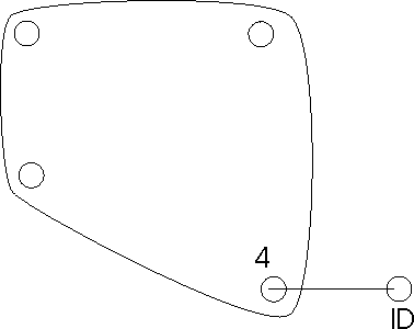

Not necessarily, no Rupert.
Take this as an example of the common error.
All marks left to port, start and finish to be between ID and 4.
You finish by touching the finish line with ID on your port side and 4 on your Starboard side, because the from the last mark, 3, to the finish line, 4, is in that direction.
Which way you rounded 4 on previous laps is irrelevant.
Date Posted: 12 Apr 12 at 4:08pm
Ah, yes, that makes sense. In a case like that, move the finish line so ID is down screen, not across, I guess
I've been here. Imagine 3-4 is a starboard tack run. Hull leaves 4 to port, boom end leaves it to starboard. Have you finished?
Stewart
