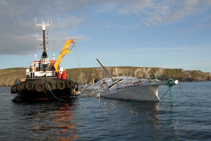

Posted By: Femto
Date Posted: 18 Aug 11 at 2:22pm
Now the right way up and being salvaged - minus rig.
Sad sight......

Posted By: Iain C
Date Posted: 01 Sep 11 at 11:15am
Originally posted by I luv Wight
A very Cherub-style snout on Rambler ( except of course the snout itself is longer than a whole Cherub )
I quite agree! BTW Rambler is now ashore at Endeavour Quays Gosport.
