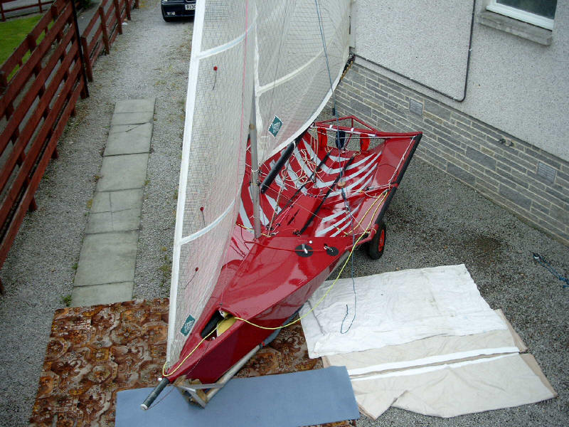

OK then:
TO BAG OR NOT TO BAG.
I've not sailed a boat where you have to bag the kite, and as the Cherub
has gone up in kite size and is only 12ft long with the mast in the middle
of the boat, there's not much room for a sock.
In Loco our sock runs almost to the stern and is a considerable hazzard!
Especially now we are twin wire. Getting out the other side quick is a
must.
So what do people think of Bagging the kite v's a sock?.
Be interesting to here what people have to say as we are thinking of
changing to Bagging on 'Loco Perro'. Plus learning to bag will be a
defiante advantage if we go to OZ for the 12 ft Skiff interdoms. You can
see the sock in this pic.

The bags would save you a lot of space but we used to hate them with a passion in the 5000..... mind you, less things to go wrong.

Hasn't the RS200 got a double pull down on the kite enabling them to have a shorter sock?
I woul'd guess it does horrible things to the kite but it may be a solution.
The only down side of bags is that you have to come in the boat to bag the kite (not to mention stepping forward and burying the bow) where as with a sock (if the helm drops) you are at least keeping the wieght back and out to a certain extent.
Just MHO of course.....
As for me I prefer a chute on the 'ball. Slightly slower hoist but a much faster drop, means we can be almost on the mark when we drop!

I have 3 patches on my 2005 rules kite and it still comes back to within 1 meter of the transom.
I was half thinking of a stratigicaly placed kick bar so you hit that rather than the sock

Having sailed the 29er (chute) and now B14 (bag) I can say that hoisting is pretty similar speed wise (bag possibly a bit faster).  Droppping can be slower if you go for a windward drop because of pulling the kite round the front, but a well done gybe drop will save you three or four boatlengths, especially in the light stuff when the crew can pack the kite from up front with the jib in as you go upwind effectively allowing you to drop right on the mark.  As for patches, they only work if you get the spacer knot just right.  Also bagged kites last longer as they do not undergo the high tension involved in pulling them through the chute throat on each hoist and drop.
Having said that there was an article in Y&Y not that long ago about a 12' skiff with a chute instead of bags and was not really any slower than the boats with bags.

Daryl, at the end of the day its all personal preference! Im my bros B14, its an arse to bring in - hand over hand! I much prefer the sock, but as Phil said - a carefully placed kick bar will sort this out.
When I ran the 30sqm on Norfolk I pulled it in 12ft stylee, was an arse! Also ended in an unsuspecting pitchpole.
When I get new rules on the cherub, i will have 3 or poss 4 patches, more friction but smaller sock!

well i know its not really same thing but cats used to have bags but they were so much bother no one used em now we all have shutes its the norm to have a kite.

it could just be that the 12" skiffs only have bags because of the fixed pole, it may not be an option to consider and that given the option i would think that a few would go for the chute

Why not do what the Hornets do? - keep the shute but lose the sock so it's loose under the fordeck and have a 'kipper line' where the downhaul goes thru a plastic ring on elastic between mast and chainplate which is stretched as you pull the kite down. When the kite is all the way down you let go of the downhaul and the kite 'pinged' back under the fordeck.
Admittedly both the fordeck and cockpit are a bit bigger and the kite a bit smaller so it might need a fair bit of pin but you get the advantage of less wear on the kite.

Thanks guys I think we are coming around to staying with the sock but....
Granite ( AKA Phil ) So even with 3 patches ( this is the other option ) the
sock is still long? Have you got a spacer knot / konts?
under the fordeck.
Hey man I like your thinking... this could be an option.

I had something like the hornet on the Trifle, this was only the 15m kite yet it caused a few problems, ie - capsize, it would float out and get tangled and caught!

At the moment I am using a spacer knot to ease the passage into the chute but it does have the effect of making the kite longer when in the boat.
On my previous boat I tried the no sock and elastic pinging forward method and it did work but you need to isolate the kite from any string under the foredeck e.g. self tacker or pole launch string or it will get sucked in.
bear in mind that you are still going to have to pull the kite back as far as it currently goes and it has to then ping forward without getting caught on anything and ends up being folded into half its current size
all that isa required is a little mesh to keep the kite forward of the mast

Just a bit of a wild idea but....
Maybe you could use a section of cat trampoline with a cringle put in the right place to allow the halyard to run through. On the drop the material would then pull in to the boat with the kite and once done it would all spring back in to place. Not sure how you could secure it, maybe use bungee cord to give that extra bit of stretch....
Like I said just a mad idea bu it may be worth investigating...

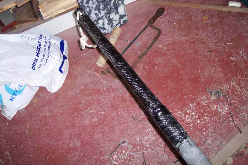

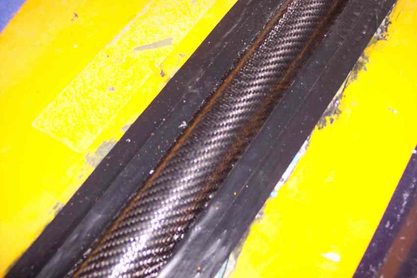

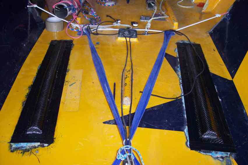

just finished some more mods this weekend.  the pole got extended for the new big kite and we made some rather sexy looking kick bars!
we just sheathed in a broken rs700 mast and whacked loads of uni d and weave round it. looks rather special not
fingers crossed they survive for weston even though the forecast is RUBBISH!
