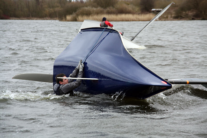

Posted By: dics
Date Posted: 06 May 10 at 12:01pm
RS300 Winter Championships
Opps here another one. He keeps on poping up everywhere.
The chap in the background has got it together though.

Can i just point out there is a perfectly good explanation for each of those capsize shots.

Re: the capsize photos - in boats that tippy looking I am impressed by anyone keeping them upright at all !
