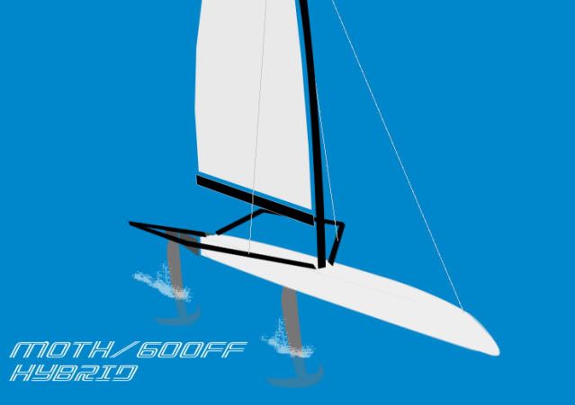

I had a bit of time on my hands so i did a rough sketch on Photoshop of what i want to build one day.
Its pretty much a 600FF but the hull is long and thin and gradually tapers to a sharpish point at the front. Its kinda like the Mach 2 design except longer and with the raked bow being more swept back and a more curved structure, similar to the floats on BOR90.

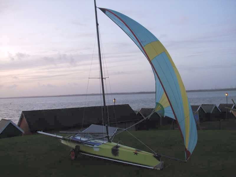

Date Posted: 31 Mar 10 at 2:13pm
Here's one I made earlier... looking a bit similar to the salty sketch.
but it's a moth / IC hybrid - with a kite and a T-foil rudder.
( converted from IC, hence XC on the sail )
it's even got the fashionable raked bow.
Not much news about sailing it to report yet though ( except that the flexible gantry for the adjustable T foil was too - err,  flexible  - to the point of failure. )
This could be the base for a development class single hander + kite, no foiling flying ).
" rel="nofollow -
Andy P
foiling Int Moth GBR3467
Freedom 21 Codling

Posted By: s.a.l.t.y
Date Posted: 31 Mar 10 at 3:35pm
Andy your XC is the closest thing ive seen to the idea i
had in my head. The only things what would be different are
a thinner hull (i know the canoe isnt exactly a fat boy but
width isnt needed when foiling is it), a trapeze and a more
pointy bow like a very long taper to a more bullet like
shape.
