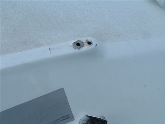

Posted By: les5269
Date Posted: 29 Apr 06 at 7:48pm
How i repaired the deck in the end Thanks guys for all the suggestions

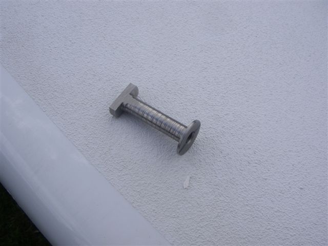

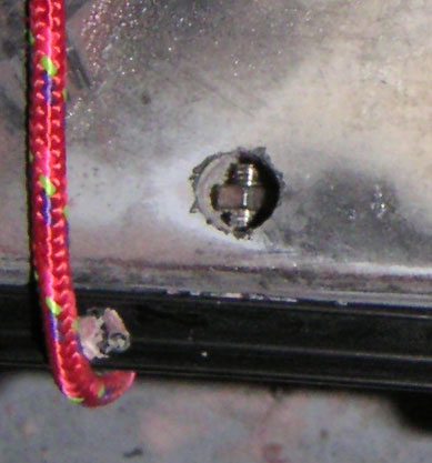

Posted By: les5269
Date Posted: 05 May 06 at 9:29pm
Posted By: les5269
Date Posted: 05 May 06 at 9:33pm
The Picture is of the part I made bonded into the hull.It seems to be ok,but will get put thro' it's paces this w/end
