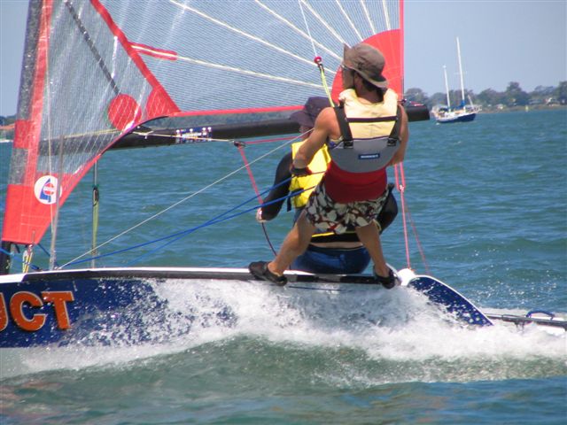

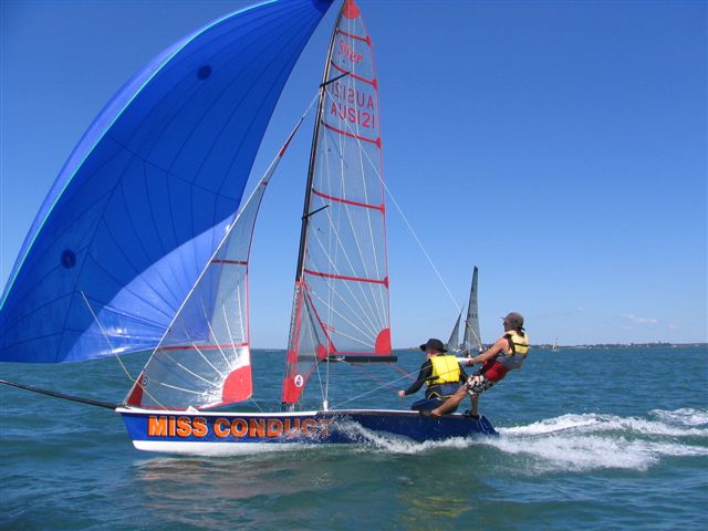

You saw it here first.
 I finally got some photos today of my 59er fitted with the trapeze. Wind today was from the land and very variable - between 10 and 20 knots. I'd say most of these shots were in about 15 - enjoy

So what was your verdict on it then?? Better? Worse?
Posted By: Pondling
Date Posted: 02 Apr 06 at 6:26pm
it looks the same as a 29er/49er sept theres the fact that its deeper. what s it like to sail?

yeah looks like a beefed up 29er

I thought the whole point of the 59er was that it didn't have a trapeze?
Posted By: swiftsolo.org
Date Posted: 02 Apr 06 at 11:43pm
This is a short piece I wrote on another thread.
Report on sailing the 59er with trapeze
I've been out a few times now with the trapeze and can now give a better opinion of how it goes fitted with this option. I am using 505s as a yardstick because they are the closest performing boat that we sail against.
Upwind performance
In light conditions obviously no change in performance! In medium conditions, when the trapeze is being used most but not all the time (around 10-13knots) we go much better against the 505s. Previously they put a crew member on the trapeze and sailed away from us in the puffs. I would say we are now about the same or maybe marginally slower in these conditions. In fresher conditions, on trapeze all the time and depowering (15-18 knots) the boat comes alive!! Much more fun than the hiking version of the 59er. In these conditions we go past all but the really well sailed 505s and as we get better I think we will go past them. It needs to be sailed lower and faster than the hiking version and we are still working on getting it into the right groove. The crew needs to work the main more than before and you luff less in puffs and just ease a little more and go faster.
Downwind
Light conditions - no change. Medium conditions (10-13 knots) probably the most surprising change in performance. We absolutely fly past the 505s lower and faster. Previously we were faster but sailed higher. The spinnaker is actually cut too full for the boat in these conditions as we have found that we need to slow down sometimes as we are sailing too high on the apparent wind for the spinnaker to cope. Fresher conditions (15 - 18 knots) not as much change. We are still faster than the 505s but not by as much as when it is lighter. We have fitted foot loops on the back of the boat so the crew doesn't go for a ride around the forestay.
Pluses
Much more fun upwind.
Makes it much more than just a light wind flyer
Minuses
Spinnaker cut a little too full for the new configuration.
After sailing it a few more times in the new configuration the main comment I would make is that on open water where I sail it makes it easier to sail!
We still don't always negotiate the corners though as you can see.

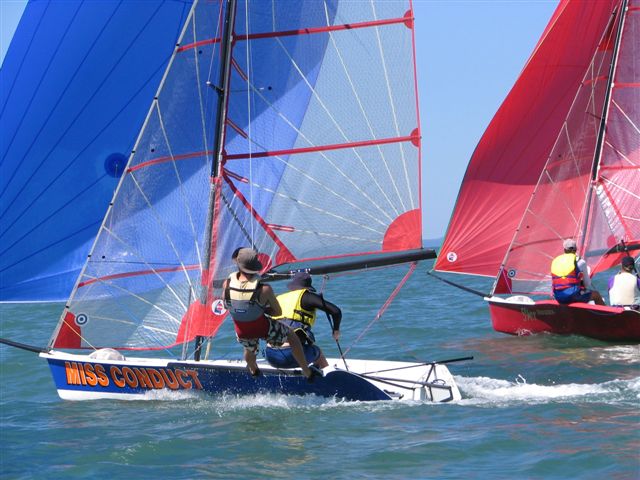

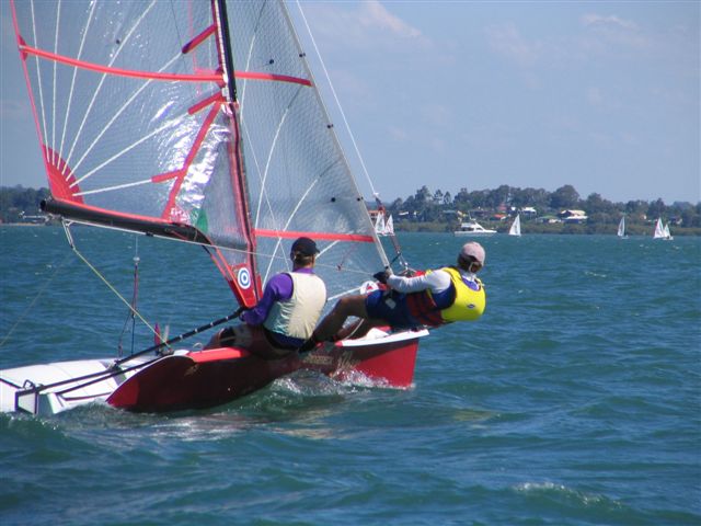

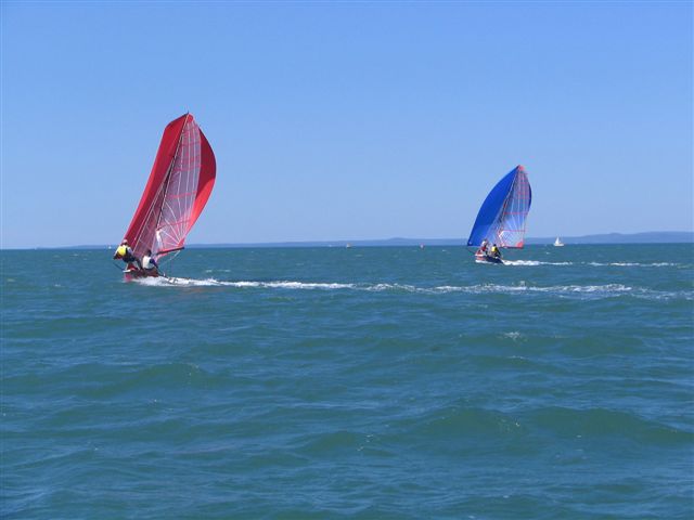

All I can say is after you get one sail as a hiker then invest $100 or pounds in the trapeze kit. If you don't like it as a trapeze boat you can take the trapeze stuff off - I bet you don't.
If it is light conditions you just don't use it.
Here are a couple more pictures.....yes there is more than one of us.

Nice piccies. nice weather, looks like warm water, You sod.

Posted By: damp_freddie
Date Posted: 10 Apr 06 at 2:25pm
Looks liek you were still overpowered in those last photos!
How do you cope with reaching between marks when you can't bear away?
 ie say a club outer perimeter marls race with some tight reaches?
It is a fairly monster kite.
Date Posted: 11 Apr 06 at 1:55am
Where we sail it is windward leeward courses. Once the wind is over about 8 knots there is no way that you would get to a wing mark on a triangle course with the spinnaker up. We are actually sailing lower with the trapeze on as we are moving the apparent wind so much.
The size of the kite is also a little intimidating for people that would be in the market for sedate little hiking boat. It is way bigger than a 29ers and at 23sq metres is only 4sq metres smaller than a 49ers!!  Yee Hah!!!!!
