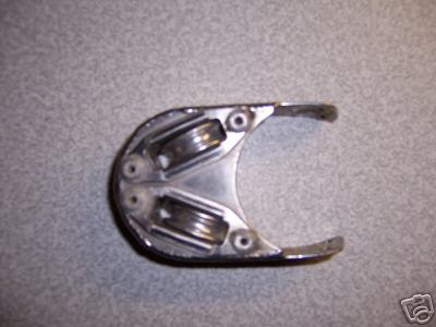

Posted By: Matt Jackson
Date Posted: 28 Mar 06 at 12:49pm
Originally posted by NeilP
My first FD had twin poles when I first had it, and from memory it had a Z-spar bracket on the mast with two sheaves in it for the launch strings.
Like this?
Laser 203001, Harrier (H+) 36
Posted By: NeilP
Date Posted: 28 Mar 06 at 1:09pm
That's the one. Did the job pretty well, until I junked the twin poles in favour of a single with a spiro. The boat was Rodney Pattison's Silver medal boat from 1976. Rodney loved his string! It even had strings to open and close the bailers!

Posted By: nibor
Date Posted: 30 Mar 06 at 5:02pm
The fitting looks good but I can understand why it chews rope.
Does it provide a more rigid platform than a floating block off the mast D ring tho?
If Rodney used it (to a moderate degree of success) should we mere mortals question its effectiveness?

A couple of years ago a competative Opsrey set up a twin spiro system - and told us all how wonderful it was and we should try it too ....  up to the point when he took it out.
When it was good it was excellent but when it went wrong, oh boy!
There should be no problem with crew weight in the front of the Osprey at sea - but where the spiro is more likely to be useful is if you have a lightweight crew who lacks the strength to push the pole out those last few inches.

I think i am going to ship one of these in from the states, it works out to be about £160 including P&P, so is much cheaper then the Twin Spiro, and looks sexier in carbon!!
Does anyone know of a good supplier of cheap carbon poles that would be up to the job?  A CST one is about £185 including ends.

I fitted twin poles and a twin spiro to a Sandhopper (shoal draft Squibb) and it was brilliant, particularly when gybing. Personally, I don't like 'unwritten' rules. I did a load of research and found that virtually all classes use the singular 'pole' in their rules, including the Merlins and 505s. The 505 chairman of the technical committee told me that he had never found a need to change the wording to read 'pole or poles' or some such.
I don't think you can avoid using a purpose made fitting, loose blocks would be a nightmare. Incidentally, you don't need a shockcord return to retrieve the pole which means you are far less likely to suffer a pole in the mouth. Check out the Merlin Rockets, they have a micro block on the inner end and a high set line (or shockcord) at the mast down to the boom end that allows a much more controlled retrieval. That worked for me too.
