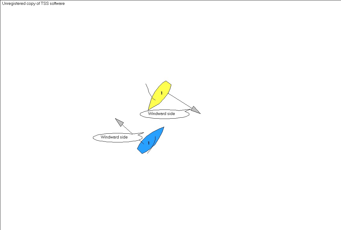

Sorry Stefan I misquoted you. However it would have been more correct to say that a boat running on port by the lee MAY be approached by a beating port tacker from the stbd side (as viewed from the running boat. In which case the situation under consideration does not arise. However, the close hauled boat MAY under exceptional but not impossible conditions, approach the by the lee boat on the running boats port side, inwhich case both boats have the other boat ton their windward side.
I understand now that we have not established the facts... your analysis is correct - but for a different situation.
I hope this sketch makes things clear.  The situation may seem unlikely but Laser's, for instance, can find themselves by the lee in this way as can, for instance, Marblehead's with their balanced rig.
Gordon

Posted By: far canal
Date Posted: 21 Feb 06 at 12:03pm
Here wwe go again .
Its flippin simple
Wind coming from top of page .
Both boats same tack.
Yellow boat is to windward .
Yellow boat gives way !
Problem ???????????????????
PS its best to let yiour main out beyond 90 degrees to run by the lee !
How the fek can winward side of yellow be down wind you numbties ! if yellow is running by lee wind is coming from starboard side !

Posted By: gordon
Date Posted: 21 Feb 06 at 12:46pm
Would somebody please lend "far canal" a rule book. He might then be able to read the following definition ..."When sailing by the lee or directly downwind, her leeward side is the side on which her mainsail lies. The other side is her windward side. When two boats on the same tack  overlap, the one on the leeward side of the other is the leeward boat. the other is the windward boat."
In the sketch both boats have the other on their windward side, and they are both overlapped on the same tack.
(Italics refer to RRS definitions)
If "far canal" could then turn to Rule 11 he would read "When boats are on the same tack and overlapped, a windward boat shall  keep clear  of a leeward boat."
In this case neither boat can be windward boat as they do not have a boat on the side on which their mainsail lies. Both are leeward boats Rule 11 does not apply.
To quote " It's flippin' simple".
The writer of the rules used a specific definition of windward and leeward which is slightly different from the accepted nautical usage. Thes makes the setling of disputes about boats relative positions much simpler. It also, in this very specific instance, introduces a paradox that causes few problems (except apparently of comprehansion) because both boats are bound by Rule 14 Avoiding Contact.
You may wish to change this rule. In which case - good luck in both drafting a more adequate text then in getting it voted by ISAF!
Gordon

Gordon then came up with another scenario. Here the by-the-lee boat is running so deep that the boats are on nearly reciprocal courses. In order for the boats to be on collision course, the windward boat is now approaching from the port side of the running boat. As he has argued, by the definitions of the rules, both boats are to windward of each other and both/neither have right of way.
The original question didn't make it clear which scenario applied, but in the 20+ years I've been racing, the first happens all the time but I can't remember an instance of the second. I agree it is conceivable and I agree with Gordon's interpretation of the rules. It is an intriguing hole in the rules. However I think it unlikely that it is actually answering the question.
I think a lot of the confusion has arisen because people think Gordon is talking about the first scenario rather than the second. It certainly confused me for a while.
Posted By: sargesail
Date Posted: 27 Apr 06 at 6:16pm
In gordon's sketch the boats arent overlapped (yet)!  And neither is clear astern!  So neither is yet obligated to keep clear!  If they are on a collision course then I would argue that gordon's second scenario as explained by Stefan is impossible - at least part of the leeward side of one of the boats must be creating the overlap.
And if they are side by side (ie become overlapped) (not for long - closing speed will be large!) then neither have become obligated to keep clear!  And neither are constrained in the right to luff apart from by allowing room to keep clear if they luff or bear away - neither establish the overlap from clear astern.
So it really is a knotty one - but if the running boat gybes she is establishing rights and must therefore give an oppurtunity to keep clear.  If she luffs at any time once overlapped it would be almost impossible for the close-hauled boat to keep clear.  The port tack boat has less speed and freedom of manoeuvre.
My view - if they touch - flick both the "t**ts.

frayed you guys still missing the point , once the fact one boat running by the lee and by definition is on same tack as beating boat forget the windward leeward side relative to boom.
The bit From Definition  rules 2005 - 2008 " A boats leeward side is the side that is or , when head to wind , was away from the wind " excerpt from definition .(the bit Gordon doesn't quote above)
then takes over ,
ie boat running however deep when looking over the side AWAY FROM THE WIND has the beating boat on this side ie the leeward side , so by rule ( ) whatever has to keep clear.
If its good enough for RYA thats good enough for me .

Far Canal: I'm baffled why you think the RYA's words clarify anything one way or the other. Read the entire definition of windward/leeward. You are quoting the wrong sentence. It is the bit starting "however" that applies in this situation, as the wording makes clear.
Sargesail: you are correct to say neither boat in Gordon's diagram is clear astern. Therefore, in the definitions of the rules, they are overlapped, although in the "common sense" use of the word they are not. Read the definition of clear astern/clear ahead/overlap. They are overlapped, on the same tack and both have the other to windward. Therefore the rules just say they mustn't hit each other but are otherwise unforthcoming on who should keep clear.

Nice to see that this thread is still running. Even nicer to see that Stefan agrees with me!
It is worth expressing some caution when reading RYA interpretations. They are sometimes in advance or somewhat at a tangent with ISAF interpretations. As a French qualified judge and an Irish qualified race officer I regard RYA rulings as interesting view points - but only ISAF rulings apply worldwide.

Gordon: I agree with you in the sense that you are correct in the situation you describe and it is an interesting point you have raised.
However I think it is unlikely that the original and fairly innocuous question actually related to the distinctly esoteric scenario we have been debating. If this situation in which two boats on collision course had equal rights were a common one in practice, the rules would have long since been fixed. Either that or we'd have a lot of broken boats.
Posted By: gordon
Date Posted: 30 Apr 06 at 8:00pm
Unlikely situations test the rules to the limits...and in this case the rules do provide a solution.
As for the reality of the situation - in handicap racing when a close-winded hiking dinghy (a Snipe) helmed by a mad luffer meets a Laser coming off a wave...

The solution being that they are required not to collide, but with no indication of whose responsibility it is to do so or how? Not really much of a solution, is it? Or have I misunderstood?
Posted By: gordon
Date Posted: 01 May 06 at 2:14pm
Nevertheless it is a solution. Rule 14 is a rule that applies in all situations, even one in which both boats can claim that they are the right of way boat.  Intelligent men these rule-writers.

running by the lee to go as far as heading straight towards a beating boat on the same tack is going to be surfing on waves? And surely then they are going to be doing transitions between broad reaching & running by the lee? Surely then this is changing course & they are going to have to give the beating boat room to keep clear (under rule 15), which must surely be a considerable time as they are going to have to tack? And so in the event of a collision the beating boat will argue this & take the protest?"
My full answer to this and his last posting would be :
1.The situation I described MAY occur due to the existence of surfing conditions, but not necessarily. There may be other circumstances : fluky winds and RC sailing have been cited
2.A transition from a broad reach to running by the lee does not in itself constitute a change of course, as a boat might do this while sailing in a straight line. A change of course occurs when the direction in which the boat is travelling changes.
3. In the situation I described both boats could claim to be the right of way boat. Rule 15 does not apply as the right of way boat only has to give room "initially".
4. Rule 16.1 only applies IF a right of way boat changes course. If neither changes course then the rule does not apply. Only rule 14 applies. I would add that the beating boat does not necessarily have to tack in order to avoid contact.
5. If in a protest a competitor states that a boat changed course BECAUSE they went from a broad reach to running by the lee the protest committee should verify that the boat in question did in fact change the direction in which it was travelling. The competitors case would be stronger if they could demonstrate that this direction did in fact change. This is not being pedantic, merely trying to establish the facts.
6. Unfortunately, despite the best efforts of protest committees to ensure that competitors who may be unfamiliar with the rules and protest procedure can express themselves, the competitor who has studied the rules and has experience of protests will always have an advantage. Which is why any keen racing sailor should read the rules, protest when necessary, and volunteer to sit on protest committees. The protest committe can only make a decision on the basis of the information that is presented to them
7. The language used in the rules has been greatly simplified over the years. Whenever a word is used in the rules in a way that is in anyway different from a dictionary definition the rules give a definition - the use in the rules of windward and leeward being a good example.
8.A protest committee should not make a decision directly on the information given by competitors. This information is used by the protest committee to establish, to the best of their ablities, a description of the incident. It is at this point that the work of "translating" competitors testimony into the language of the rules will be at it's most intense. It is only when the facts are established that a protest committee should consider which rules apply and if a rule has been infringed
9. Personally, whenever I chair a protest committee I always offer, after having given the formal decsion of the committee, to explain the ruling, with reference, when necessary, to the Case Book. This is especially important when the decision is based on a legal nicety, or on an interpretation of the rules that may not seem obvious. After all protests are heard I am available, usually somewhere near the bar, to answer any queries on the rules, on incidents that occured during the day, or any other points arising. I also prefer to be out on the water during racing, even when there is no judging on the water.
10. If, in the situation I described, in a diagram, some time ago,  if neither boat changes course and there is contact then both boats have infringed rule 14 and the protest committe would have to consider if a penalty is appropriate. If one boat changes course then they are obliged to give the other boat room to keep clear. The protest committee would have to decide whether the boat that had changed course had left enough room.
11. The best option for the by the lee boat would be to gybe on to starboard in good time to let the beating boat time to keep clear.
Hope this answers your questions.

Rule 14 obliges a boat to avoid contact "if reasonably possible". In addition a right of way boat, or one entitled to room, only has to take avoiding action when it becomes clear that the other boat will not keep clear.
In this case the protest committee may conclude that the situation was somewhat uncertain (the time we have spent discussing it is proof of that), and that both boats have suffered major damage  affecting their result in the race and maybe the series. If I was chairing the protest committee I would be tempted to conclude that the damage was a sufficient penalty and that there was no need to inflict a penalty such as disqualification. On the other hand, if there was evidence that one or both boats had had a reasonable opportunity to avoid contact and had taken no action to do so, then disqualification would be an appropriate penalty.
The decsion would depend upon the facts established according to what the competitors said in the protest room.

To go back to my points on page 5 which concerned establishment of overlap and on which stefan quite rightly corrected my assumptions - I am intrigues as to how folk view the fact that any significant luff by the by the lee boat will create an overlap - and it will then clearly be windward boat - this would aslo be the case if the boats meet anything other than bow to bow (if you allow my assumption that the by the lee-er is unlikley to try and run underneath the close-hauler! - a fair one I think).  So if there is course changing as described by John (and eventually agreed by Gordon "I'm not a pedant - I'm pedantic!" (firmly tongue in cheek and with apologies!!).  then the likelihood is that the boats have been overlapped - that he put himself there and that therefore he should assume that it is for him to keep clear - apply Gordon's gybe solution - or head up and reach round the back!
The close hauler should be in the clear - if he becomes right of way boat it is not through his action - though clearly he must avoid a collision.
Posted By: gordon
Date Posted: 03 May 06 at 3:24pm
As both boats are on the same tack and neither boat is clear astern of the other then, according to the RRS definition, they are overlapped even though they are approaching from nearly reciprocal directions. A change of course by either boat would have to be very radical in order to break the overlap.
This holds true for both scenarios that have been put forward. In one scenario this means that rule 11 applies and the windward boat keeps clear. The additional scenario I introduced is one (unlikely but it has happened) in which, because of the way RRS defines windward and leeward, there is no windward boat, both boats can claim to be leeward boat. Rule 11 is inapplicable so rule 14 obliges both boats to avoid contact.
Gordon
PS If applying the rules as they are written, precisely and in accordance with the policy of ISAF, constitutes "an overating or parading of book-learning or technical knowledge or an insistance on strict adherance to formal rules, or even being possessed by by a doctrinaire theory " (such is the definition of pedantic) then I am proud to say that I am guilty as charged. The current rules are simple, short and logically structured. The essential rules for when boats meet are a mere 4.5 pages long. There is little excuse for not using these rules precisely.
Gordon
