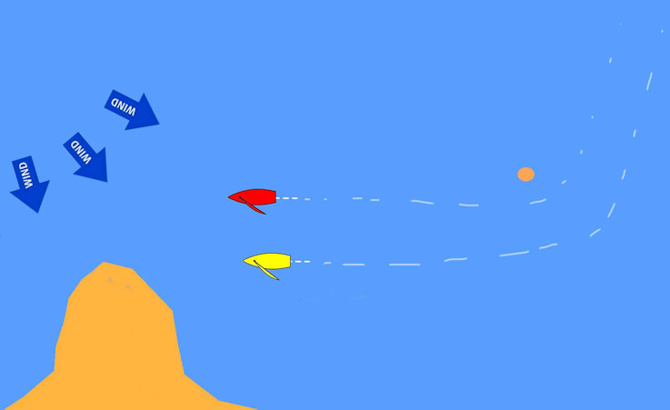

So today..
Two boats side by side both close hauled sailing on starboard.. about a boat lengths between them
The leeward boat got a little too close to an outcrop ahead and called for room to tack, then tacked. The windward boat didnt change course and said there was enough room for the leeward boat to dip behind, which he did.
So who was right? Should the windward boat have tacked as requested, or was he correct in not tacking as the leeward boat was able to sail below him without any collision??
I know the rules say you have to keep clear when requested, but the requestee had room to sail behind him.
This caused quite a discussion post race and would love to see others views.

So if windward immediately hailed back "you tack" then all rules were obeyed, since leeward was given room to avoid. If windward didn't respond in the correct way then they technically broke 20.2c.
If leeward is in any doubt about whether there's enough room to tack they may as well hail, because windward can always hail you tack, and it means leeward is covered if someone has misjudged it.
Its fairly worrying that you had a post race discussion on one of the most important safety rules in the book!
Yep.. there'll be some sleepless sailors tonight worried sick. Clap
The discussion was due to the fact the leeward boat called for room to tack, yet had room to tack and dip behind the windward boat which did not alter course.
Post race the leeward boat said the windward boat should have tacked regardless.. the windward boat said the leeward boat had room to tack.
So are you saying you have to tack? even if you believe the call is false, then protest? Seems a bit daft.

Exactly.. so does 'room' include holding your course and the other boat successfully dipping behind you? The leeward boat says no.. the windward boat says yes.

Leeward managed to tack without hitting windward, so there must have been (or windward gave) room to tack…
Posted By: Old bloke
Date Posted: 21 Mar 22 at 6:48am
Depending on the circumstances a tack and immediate hard bear away is not guaranteed to be done successfully and if you don't get it quite right there is no safe exit and a T- boned boat. I don't think it is unreasonable to want a margin of error

To clarify.. the windward boat did call 'You Tack'.
The issue is that the leeward boat is adamant that he should have not been forced to duck behind the windward boat and that the windward boat should have tacked. The windward boat disagrees and believes the fact the leeward boat had space to tack and duck behind was sufficient.

I believe the onus would be on the windward boat to prove they gave enough room for the leeward boat to tack and duck them, remembering that the definition of room is not the minimum space required to manoeuvre, but the space required to do so in a 'seamanlike manner'.
OK 2249
D-1 138
Posted By: Jon Meadowcroft
Date Posted: 21 Mar 22 at 9:46am
No onus on anyone to do anything as far as I can see in RRS.
Facts found:
Both boats hailed correctly
Leeward boat tacked
No collision
So the base assumption has to be that there was indeed room for leeward boat to tack and avoid the obstruction.

Date Posted: 21 Mar 22 at 12:44pm
Ah, well in that case its "go and read the definitions": failure to do so is an all too common problem.
Leeward is obliged to tack, windward is obliged to give room. So what is room?
Room The space a boat needs in the existing conditions, including space to comply with her obligations under the rules of Part 2 and rule 31, while manoeuvring promptly in a seamanlike way.
So the obligations are that the tacking boat is obliged to keep clear, but the windward boat is required to give her enough room to do so. If there's no collision and the tacking boat was able to avoid without "unseamanlike" actions then everyone is good. This is covered in Case 35 in the case book.
CASE 35
Rule 20.2(c), Room to Tack at an Obstruction: Responding When a boat is hailed for room to tack at an obstruction and replies ‘You tack’, and the hailing boat is then able to tack and avoid the hailed boat in a seamanlike way, the hailed boat has complied with rule 20.2(c).
Facts
As two close-hauled boats approached a shore, L hailed W for room to tack. W replied ‘You tack’ and L then tacked immediately. After tacking, L bore away in a seamanlike way and passed under W’s stern, which she cleared by three feet (1 m) or more. L protested W under rule 20.2(c). The boats were 15 feet (4.5 m) in length and the wind was moderate. The protest committee decided that W failed to give room as required by rule 20.2(c) and disqualified her. W appealed.
Decision
W’s appeal is upheld, and she is to be reinstated. L’s actions showed that she had room to tack and avoid W. W therefore met her obligation under rule 20.2(c).

So L hailed for room to tack, W replied "You Tack".
It is perhaps worth noting that the hail of "You Tack" does not give L right of way. L remains keep clear boat throughout the entire exchange, the only onus rule 19 places on W is to give L room "to tack and avoid her". Note that L has to do the avoiding, not W.
