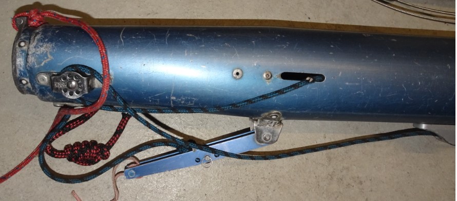

Boom
The boom we bought separatey somehow has got two outhaul mechanisms we do not fully understand. One features a kind of lever at the front end of the boom. Maybe "Coarse" and "fine" control??? (In German we would call it "dead center lever", whatever that is in English...) Does anyone have an idea how this may have worked?
The vang already has got continuous control lines led to the transom, unfortunately the cleats "disappeared" at the previous owner...

Date Posted: 19 Apr 21 at 12:33pm
photos would help...
Posted By: skslr
Date Posted: 19 Apr 21 at 8:42pm
Front end of boom:

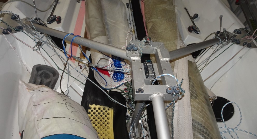

Posted By: skslr
Date Posted: 19 Apr 21 at 8:43pm
Spaceframe with "mast stump":
Posted By: davidyacht
Date Posted: 19 Apr 21 at 8:48pm
Was a Selden boom with course and fine adjustment, not sure of the benefit, we had multi purchase inside of the boom onto a single cleat and turning block, since there was plenty to keep you busy rather than fiddle with the mainsail foot
Date Posted: 19 Apr 21 at 8:50pm
Don’t think that the stump was original, the Ovy Howlett that we had 1301 still had a hog stepped mast

Date Posted: 20 Apr 21 at 10:33am
Hmm, yes, I very much doubt that setup is original, but I would definitely want lowers with any distance of gooseneck above mast. The kicker load is going in the mast whatever.
The big question is what are you planning to do with mast and sails. And a second question, which you probably can't answer, is how well does the rig you've got actually work.
A mainsail for a properly designed twin spreader rig will have entirely the wrong luff round to be used without caps, but there was a tendency in some classes and some places to just bung caps on a single spreader rig to hold up a kite downwind without much thought about upwind. In my opinion that was not a good rig, but if you have one taking caps off isn't an issue.

Posted By: Lukepiewalker
Date Posted: 10 May 21 at 6:36pm
Until the 1996 unification foredecks weren't allowed, so spaceframes were very much the thing.

Posted By: piglet
Date Posted: 11 May 21 at 9:21pm
That space frame looks identical to the one we had in 1188, I think that boat went to Belgium?????
I'm sure the number will be in the hull somewhere.
1188 was a single trapeze rules converted to twin trapeze rules, great boat but the mast was long, heavy & didn't bend at all!

Posted By: MikeBz
Date Posted: 17 May 21 at 1:17pm
We had the first customer Ovy Howlett 1B, 1302, and that was stumped from new.  At my request the spaceframe included an aluminium plate underneath the rectangular section, on top of which I put the mast step and underneath a section of old mast as the stump.  I don't believe it's the one in the pics as the plate on which the step sits is somewhat smaller.
