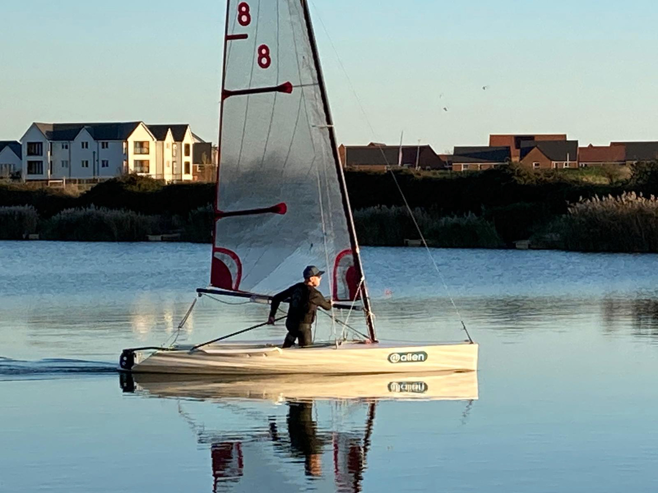

So, I've done a deal with Mike and now own what he called his hybrid, not a name that particularly inspires so I've decided to continue the development with the possible goal of lauching this into the market as a commercial proposition probably 2022 now when this covid nonesense is over.
The name is a combination of the Fire rig which I may end up with and the sharp nose which i think is more apt, my plan is for that trapeze single hander that also works in land as a hiker ( maybe the trap can be arranged more as a hiking aid, more about that later.)
I'll opt for a carbon rig eventually and go for on the fly raking adjustment with the dual option of raking a bit to trapeze and loosening the halyards for by the lee action down wind, rear footstraps and maybe a rear thwart/spoiler to help with the knees downwind, we'll see, got to sail it first and see how it feels. Mikes already done a good job amd I don't want to screw anything up just for the sake of it he has lots of other work that needs his attention, but if we go ahead and launch it I'll make certain he's in the loop and rewarded for his design input.
Can't say how excited I am to have something else to work on, maybe I'll really get the one boat does it all I've wanted at last and be able to offer it to others packaged in whatever spec they require. Small sail hiker, mid sail hiker/trap possibly even a big rig option but that's way down the path. Couple to price breaks, low cost alloy rig to high end carbon.
I'm considering making it a multi owner business with boat owners being issued shares in the production company and profit being divie'd up amongst them each year which would broaden the appeal to some enthusiasts to actually own part of the company as well as the 'class' which I'd soonerrefer to as Owner group since the word class carries such negative connotations in my view.
Anyway, watch this space it could all turn to nothing, but right now I've got some reason to be excited with yet another round of lockdown approaching and if you have any suggestions please fire away. Here's a pic off the hybrid thread again...

Well, had my first 'go' in it today although in typical fashion the moment the hull kissed the water surface the wind buggered off and we were left with 0 - 3 mph which initially had me circling a couple of chums in lasers and racing away, then we had a little race in which every time I started to come from behind I discovered just how deep the plate was and found myself hooked up on the island we race round. My point of proving the best PY for it would be the same as the Laser was proven but not entirely accepted as the occasional puff would see it gather momentum quite quickly, but in all seriousness it was just a sunny jolly, marginally better than a poke in the eye with a sharp stick, a feel around. It's definitely a boat that's going to work best bolt upright and it's going to be tricky to keep it that way, very very sensitive to position, I didn't really even get to sit on the side, I don't think those winglets are far enough forward, but again too early to say, I also think he's over cooked the raking of the rig, in a quick sum up, great boat, not great rig and God knows where the sail came from but it's got to go.
Date Posted: 04 Nov 20 at 8:30pm
All that from a no wind sail? I'd expect a more upright rig in a drift, and surely you need more wind to see what the sail is capable of?
Posted By: iGRF
Date Posted: 09 Nov 20 at 6:26pm
Well It came good yesterday in a bit more wind, 5-8 mph at a guess, it pulled away from our little recreational gathering after a rabbit start, Lasers & Solution it was one and a half minutes quicker in a 45 minute session and 2 min fifty in the second but that time the next chasing boat got itself stuck in a hole. Triangle sausage. A lot quicker up wind, came out of one start in which it had been buried after a lifting gust took the next boat out of the gate over and on top covering us, but as the wind built a bit it came out from under and pulled away.
Offwind it lost ground particularly on the dead run, I put that down to the overly raked rig and inability to sheet right out square, but all in all it felt great to restore natural order.. If all else fails, nothing like buying yourself back to the front of the fleet..

GRF ...offwind 'light' stuff - ease the kicker and be prepared to dog-leg.   You simply don't have to go dead down-wind in grotty light wind stuff and you will be no faster than a laser sailing at approx wind speed if you do.  Hybrid (or 'Fireblade' if you must ...) is of course potentially faster (VMG wise) but not unless you dog-leg.  So throw in a few gybes, sail away a few degrees higher than 'dead' downwind or so and then gybe .. repeat as necessary and your offwind VMG will be very much improved. (you cannot do this really in a Laser or Solution - they tend to be too slow to benefit).  Do this and you also escape the wind shadow of any 'slow' ones behind as well.  All they can do is 'follow' dead down wind as they cannot improve their VMG  if they try dog-legging and gybing.
Costs not a lot to try it for yourself - you will 'get it' before too long ....  Wink    Good luck.
Posted By: iGRF
Date Posted: 09 Nov 20 at 7:51pm
Yeah I did that a couple of times and when the shifts were right it worked but when they caught me out.... There he was.. This I might add another shift aware ex windsurfer who we shall call skeletor since he must weigh about 59 kilos and flies in light weather with one of those super sized M&B 'training sails'.. And it took me a bit to work out just how far forward you have to sit to stop the stern noise. I need a saddle just in front of the Centre board.. ;-)

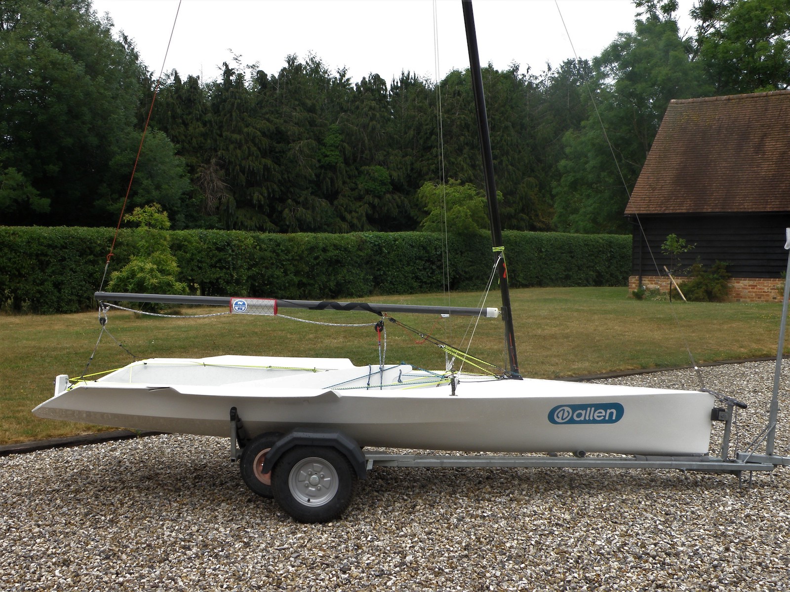

Posted By: iGRF
Date Posted: 06 Jun 21 at 9:14pm
Bit of an update, fitted what we windsurfers call an RDM (reduced diameter mast), got it off one of our Contender hotshots who having bought it recently had a couple of windy races and thought it too soft, much to my good luck it's the same height and rough dimensions as the tin pole that came with the boat, went to try it today, but forgot I was on race duty so didn't get to try it, the wind was crap anyway the useless race officer set two crap courses. It's made by Superspars, probably for Hartley, still stupid money even 2nd hand, but as a concept if it works could be purchased much cheaper as extruded carbon and a track added.
The sail sets well on it, it bends off in all the right places, has trap fittings ready to rock so I might finally get to trapeze off it.
So far I've had good results with the boat as it was in the light stuff, but once the buggers in their Contenders get even one foot into their traps and they can foot off, they're gone. Now I don't expect to beat them but it's a bit embarrassing just how quick they leave the party upwind. So if you can't beat them, nick their rig..
Will update a bit more when I finally get to get out on a wire, as a straight sit out boat, this is a jewel, can't fault it. Maybe on a production boat I'd makes those wings longer, further forward, and made of carbon, oh and somewhere to sit on a run maybe.

Well what a night I had last night, after managing hurriedly to attach trap wires arriving at the start thinking it was the five minute gun when it was the one minute. Lovely warm sunny windyish (wind drops the moment the gun fires as is normal, so a patchy 2 - 4, but enough to get on the wire and see how she goes.
Which was well, having to catch up after completely missing the start due to watch error. and arriving at the first mark about half way back in the pack which contained Contenders, Tasars and Lasers and an Aero 7, then it all went pear shaped on the bear off, which took longer than it should have due to the rudder blade raked and in need of pulling vertical, all attempted to be done from the wire, which ended up with the inevitable front rounding and capsize on the bear off.
The boat wasn't that easy to right, slippery plate, high sides, it needs righting lines as I think someone pointed out way back. So by the time we were back under way the fleet was at the first gybe, then having rounded up, back on the wire and engaged once more on the catch up into the normal short chop with the boat bucking and crashing, after a few hundred yards and a particularly steep wave, crash down we came and with it the mast and me back in the soup, snapped forestay, I haven't bothered to find out exactly which bit failed will do it a bit later this must be the third de masting of a trapeze boat with me out there, doesn't inspire confidence or enthusiasm for much more of it...

   Hi Grf
Two things make a big difference to how the boat is on its trolley, balance and tyres. I bought the solid wheel versions like the Aero which are fine but not on soft sand,  pneumatic are better as I found at Broadstairs.
Try joggling the boat on its trolley to get the balance right and then get an alloy trolley made to fit properly. some trolley bases are heavier than the boat!
Gordon

Date Posted: 10 Jul 21 at 11:06am
Well I managed to finish a 'windy' race on Thursday night, and nearly did myself a mischief getting out on the wire for a couple of beats, not to mention coming close to going down the mine on a couple of steep waves, but also managed not to stack it, so am a little bit pleased with my progress.
It's not easy wiring with off the boom sheeting and nothing to cleat off to, so I think maybe a turret is needed, it's also a total ballache trying to kick out without some sort of kick bar on the deck before getting your foot up onto the side leg bent almost double under then trying to kick up - nightmare.
But once up there it's a joy and the speed increase is noticeable if a little more free than I like and cause to totally relearn your tacking angles.
Got a picture as I left the beach, I did tune the rig a bit better than that before the actual race.
I was however totally knackered, there was talk of reaching for the defrib as I lay on the beach recovering once ashore.
Anyway progress is still being made.
