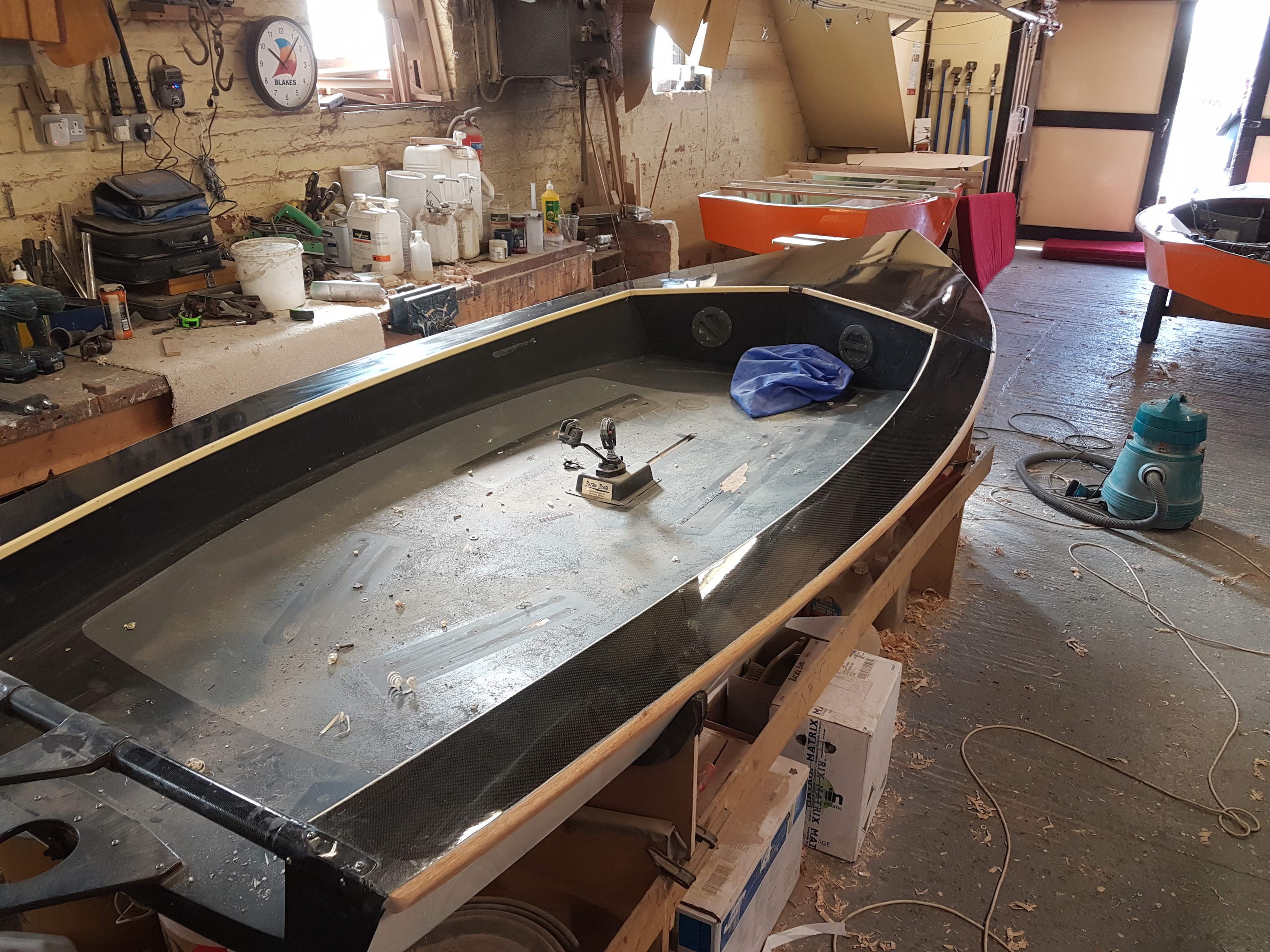

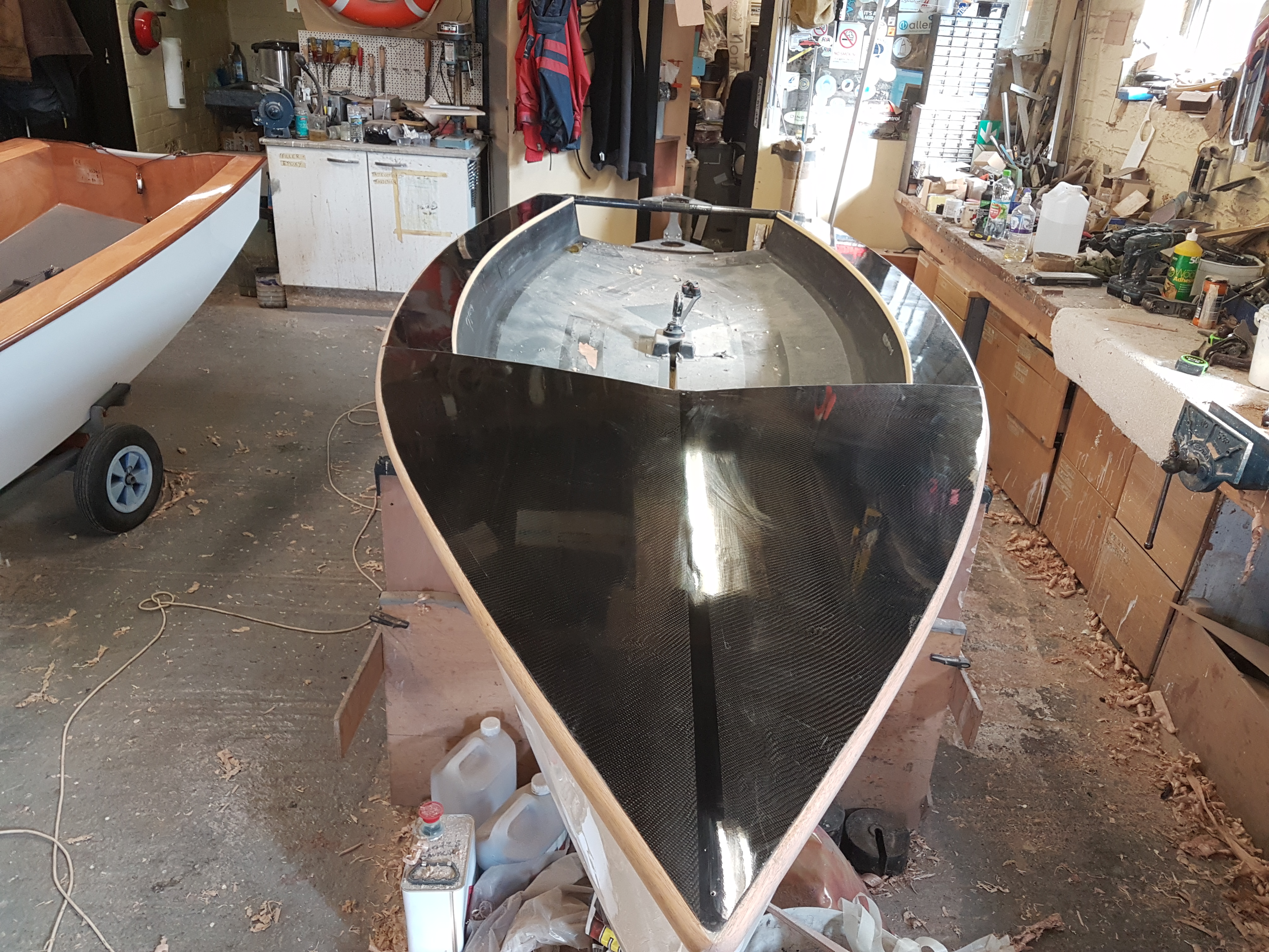

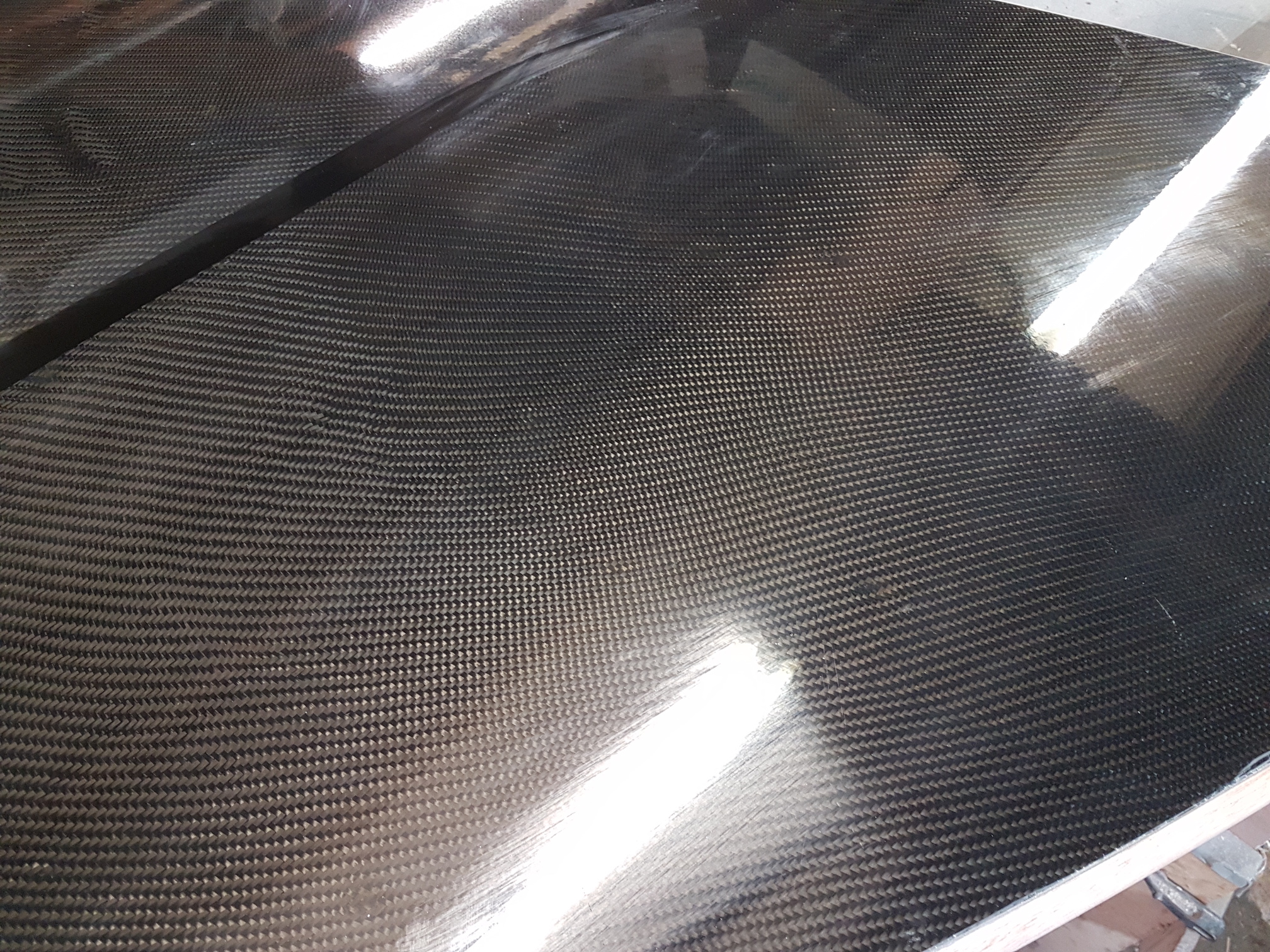

Well the story so far , I was too late last season because it was part built so I had a carbon effect wrap which looked OK, but tended to bubble in the heat, then in the course of learning to sail it I put a few holes pretty much everywhere, hull, deck foredeck so it had to go back for a bit of tlc last October, it's been a long wait but check it out, should be ready to fit out next week, I'm going for a red keyline on those rails and this time it'll get proper kitesurf straps and will look the absolute DON!

Posted By: tink
Date Posted: 05 Apr 19 at 7:51am
Bit confused, is the picture still a wrap or now real Carbon

Posted By: iGRF
Date Posted: 05 Apr 19 at 11:46am
So, here's an idea I'm thinking about. I'm trying to convince folk I come in contact with on the option of a 'kit' in carbon, to bring the self builders into the now. There is already a ply self build thing going on with the Farr and several folk have built their own, but, they end up like my first iteration, wood and whatever you think about it, wood needs looking after and is more susceptible to idiots like me puncturing it with our harness hooks. OK carbon might get scratched but it should be more resistant to puncture and the price of carbon is so much more reasonable now especially in sheet form.
Does anyone think there would be an appetite for a self build class for kids, if there were say significant prize money at say a national event once a year? Obviously Dad would have to help, but this boat is ideal for youngster moving into the realms of trapeze sailing, I wonder if such a carrot might help a)Getting kids into actually building things and b)growing this class a bit. Just a thought. It's an absolute joy to sail once you get the knack and being on the wire is a great relief from knee and back pain from hiking hence it's appeal to us oldies, I dunno, it just need some sort of shove to get wider appeal.
Posted By: iGRF
Date Posted: 05 Apr 19 at 11:48am
Tink it's real carbon over foam backed by glass I think.

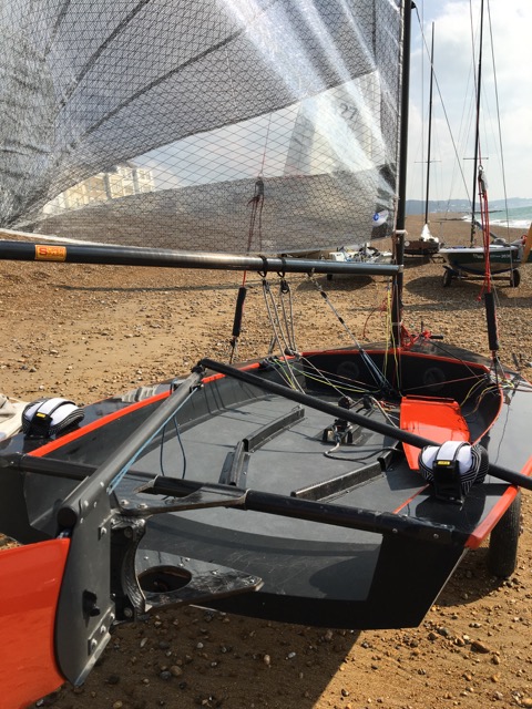

Posted By: iGRF
Date Posted: 12 Apr 19 at 8:02pm

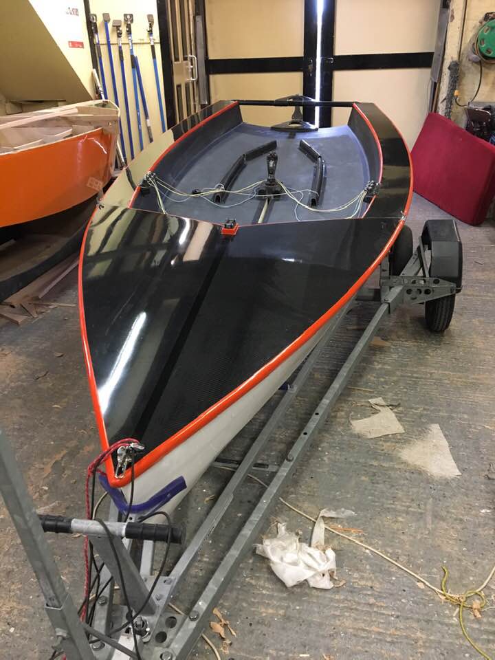

There she/he is, picked it up today whilst I decide if it's had gender re-assignment now it looks Awesome...
Posted By: Do Different
Date Posted: 12 Apr 19 at 8:31pm
Respect to your commitment and very nice it looks.
Some seriously high kick bars on the cockpit floor, are they any hindrance when changing sides? I only ask because Contender only allow in their rules one pair of quite small measured wedges.
Posted By: E.J.
Date Posted: 12 Apr 19 at 11:24pm
Practically there is much less room in the Contender when tacking, anything more than a gnats cock on the floor will remove your knee caps, I suspect the rule is to prevent sailors from turning the boat into a torture device. Also I thought that rule referred to the gunwales to stop wedges becoming extenders? Expecting to be wrong though.
Date Posted: 13 Apr 19 at 6:22am
I wouldn't say you're wrong, quite possibly reading another measurement rule.
I looked at kick bars for mine because being very short in the leg it is a big step back from CB case to gunwale. There is in addition to a size rule, a rule governing the positioning of any kick wedges.

The red strip gives it a slight A-team van, hooligan effect. Very dynamic
Bit too Man United for me 😫
I assume adding a fake carbon deck has actually made the boat Heavier?

Sorry but 'faux' does not do it for me .... If it ain't a pig why put lipstick on it ?  Racing boats are primarily about 'function' surely ....
I guess each to their own  - just make sure it does not get too hot and 'fry' the deck ... LOL
ISTR a Contender with kick rails between the mainsheet tower and the back of the foredeck?
That's where you need such things, as when it's marginal trap weather, you want your weight more forwards?
Isn't all this naked carbon a bit old hat now? Reminds me of my 1992 motorbike.

Posted By: iGRF
Date Posted: 13 Apr 19 at 8:49pm
The kick bars are a tad higher and thicker because I asked for it, the last ones were useless and broke anyway.
The carbon is real now rather than fake and will make the boat more stiff as well as better to look at.
The red, is just a personal thing, I like a thin red keyline with an overall black device, it could be blue, it could be whatever colour you want, you just have to ask.
That's the joy of this class, you can personalise things without becoming 'out of class'.

iGRF, you do know you have to varnish carbon fibre?

Posted By: iGRF
Date Posted: 15 Apr 19 at 10:25am

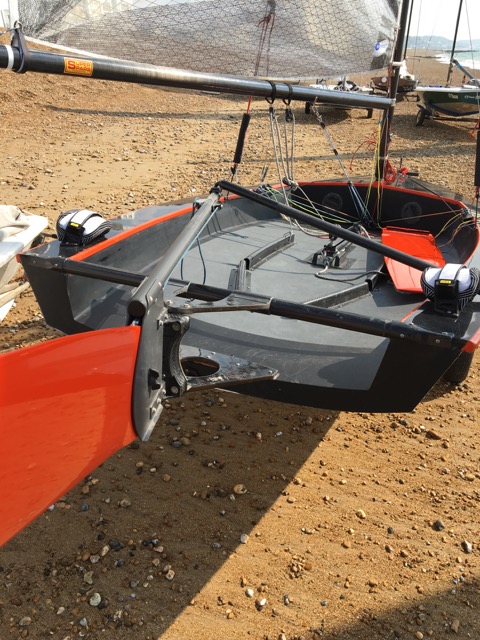

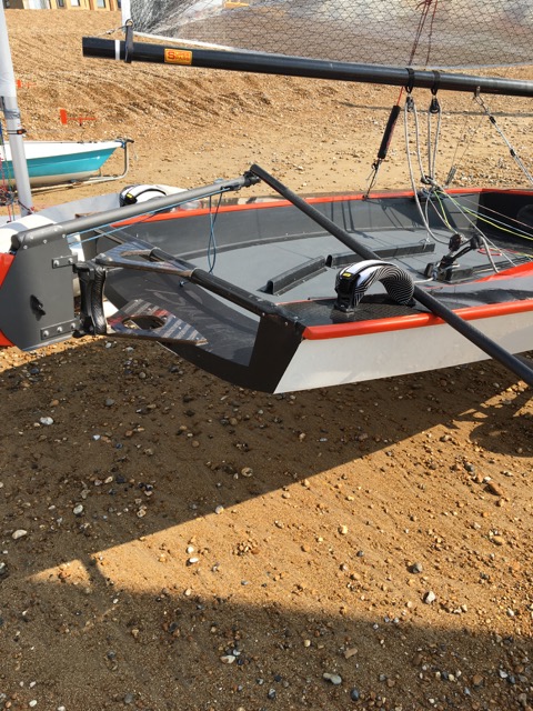

Here's some more pictures from yesterday and yes the lack of none slip did cause a swim on the bear off.
Posted By: Granite
Date Posted: 15 Apr 19 at 11:40am
Last year I built a Cherub a bit like this to a Clive Everest design. The deck and bulkheads were all made from CNC cut foam carbon panels and were bonded together with tape to make the shape. The hull was made on a male mould from loads of CNC cut foam panels which were sanded smooth on the outside before being laminated. If you were going for a more chined shape you could probably do it all with precut foam carbon panels and a reasonably simple jig.
Posted By: PeterG
Date Posted: 15 Apr 19 at 12:54pm
Yes, Progrip is your friend! Smart shiny decks, sadly not.
Mr. Zog is your friend ...
Posted By: PeterG
Date Posted: 15 Apr 19 at 2:26pm
GRF thinks progrip looks messy. Mr Zog is much worse!
Lets face it, neither would win the boat pimping stakes, but staying upright has more going for it!

Posted By: iGRF
Date Posted: 15 Apr 19 at 4:11pm
I shall probably try these first, snow board traction which will let the carbon show through.Since I just happen to have hundreds of them left over from a previous life.. https://www.corekite.co.uk/amplifi-large-dots-547-p.asp" rel="nofollow - https://www.corekite.co.uk/amplifi-large-dots-547-p.asp

If you want to go low key, then the translucent grip tape designed for showers and the like is grippy enough under a boot.

Posted By: iGRF
Date Posted: 16 Apr 19 at 1:40pm
It's done. Went down last night and big dotted it a treat...

Posted By: iGRF
Date Posted: 18 Apr 19 at 10:55pm

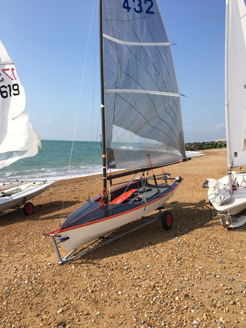

And it worked, got round in a gusty North Easterly tonight, didn't stack it once and other than an idiot spell in irons with a tad too much kicker, it went OK.
