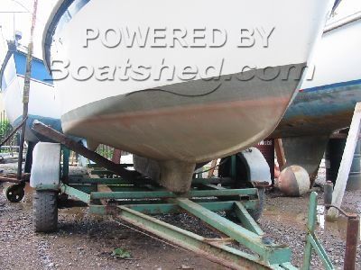

Here is a pic of a similar boat, same model.

Well, with a stub keel like that it ought to be capable enough crosswind and even make some ground upwind on what would really be a close reach. If I had to get home upwind against the tide in a narrow channel I think I'd need an outboard motor, or else anchor up and wait until the tide changed.

Right, so it has a small keel as well as a C/B, so yes it should be able to sail reasonably upwind - though it will certainly perform significantly better if you can get the centreboard to work.
Do you know what the centreboard is made of? If it's heavy, cast iron, or similar, having it down will also improve the heeling stability, in addition to reducing upwind leeway.

Date Posted: 16 Oct 18 at 11:21am
Think it is iron or steel, definitely ferrous as appear rusty at top of housing, even with all the grease.

Date Posted: 16 Oct 18 at 2:50pm
Thanks for the advice, especially comments after seeing the underwater profile of the boat. gives me confidence that should be ok for some sheltered sailing prior to taking her out of the water later and getting the centreplate fully operational
