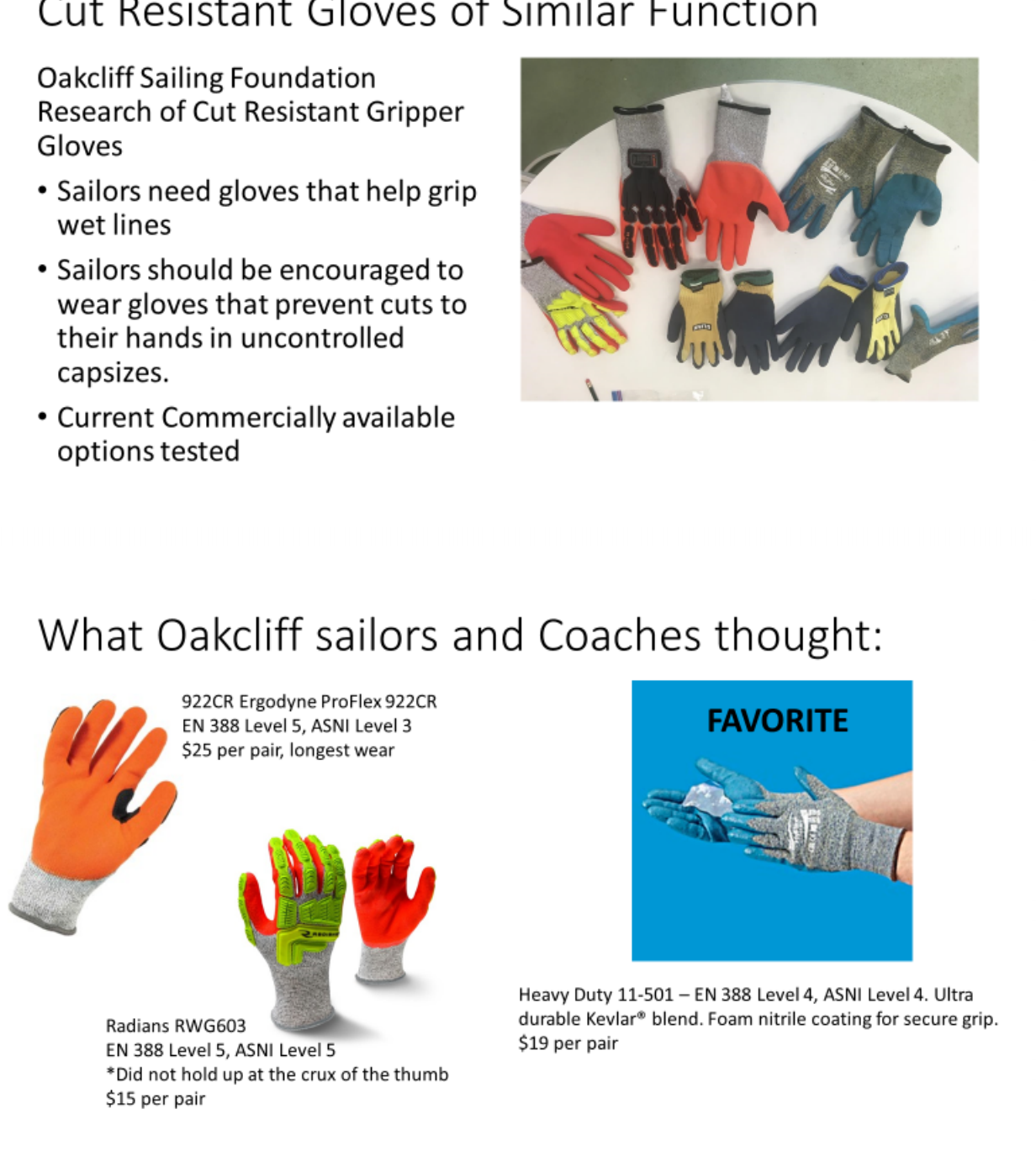

Ouch... I had a friend who lost a finger tip falling off the back of tornado with a kite sheet wrap over his hand. He was sailing with Hugh Styles at the time who was on this investigation team.
I quite often take wraps on the main, which I know is a bad habit. But really just upwind where I don't feel 200 has quite the speeds to cause the injuries though... a snapped toe strap may achieve the sudden fall though.
Generally I think dinghy sailing is very safe. Certainly around the events i've been to I can only recall less than a dozen serious incident, plus a few more recounted second hand.
Does anyone know where you can buy those cut resistant gripper gloves? Although at $19 they're quite a bit more expensive than the builders merchants.

Come on people.
Mozzy you've always talked good technical sense but really? Cut resistant gloves, get real, a wrap will rip bits off not cut them off gloves ain't saving you, only good practice will help.
And iGRF, you don't HAVE to wrap ropes round your hands, if you do you're doing it wrong.

Posted By: Guests
Date Posted: 23 Nov 17 at 9:57am
I wasn't suggesting them as my own idea, I was referencing the recommendation in the report.
"c. Personal Safety Equipment – Sailors should wear gloves that protect against cutting by thin
lines and wire under load. These are commercially available at low cost. The standard these
types of gloves are tested is based on cutting with a straight edge. There are no protection
standards that apply to wrapping lines around a hand."
Details in Appendix 3 and copied below.
Posted By: Do Different
Date Posted: 23 Nov 17 at 10:13am
Fair enough Mozzy, I stand corrected. And you've proved my point, how many pages to say what the "old boys" knew along and then come up with a technical answer which won't actually save an injury.

Posted By: Guests
Date Posted: 23 Nov 17 at 10:28am
DoDifferent, I completely agree, the answer is to not wrap a rope.
All my coaches said never wrap sheets. Partly for safety, but also it leads to a bad habit of keeping sheets still.
Having said that, just looking at my 200 videos and if the main is near centre I pretty much always have a wrap (especially when sailing bare handed). I run a 6mm mainsheet, I guess it's just too thin for me to properly grip for the leech tension without gripper gloves.
So why don't I wear gripper gloves?  Well, I'm guilty of another bad practice,  I like to slip the sheet through my hand to ease it, which is more difficult with a 'gripper' glove. I end up sailing most of the time without gloves so I can slip a sheet, but then then also wrap the sheet.
So I was thinking, maybe I should start sailing with the sticky gripper gloves again as it'll at least force me to use better technique, and if I can get ones that are cut resistant and function just as well, then that's got to be good right?
Regarding the gloves, what would be interesting to know, is whether the rope cut through his gloves and fingers, or if it just gripped his fingers through the gloves and pulled the fingers off alongside the rest of the glove. Because if his fingers tore off, but the glove didn't tear, just slipping off his hand, then  stronger gloves would not help.
If the rope is gripping the fingers through the glove, then tearing both glove fingers and actual fingers off in one, then maybe Kevlar reinforced gloves may help? Your finger would still be gripped (possibly dislocation / break) but the strength of the glove would stop it being torn off (assuming the whole gloves doesn't slip off your hand taking your finger with it)?

Posted By: andymck
Date Posted: 23 Nov 17 at 11:36am
There is a major floor in the report which is the lack of a good medical report. There are three potential mechanisms for the injury as described, a cut by a sharp surface. A crush injury by the control line or a “ring” avulsion type injury, which is a combination of constriction and tension. Or a combination. Use of Gloves will not really protect against the latter two. In fact can in some circumstances can make it worse.
A better description of the state of tissues at time of presentation including the state of the gloves would provide clues to the mechanism involved. This would normally be part of a medical report. This would have also tried to identify the mechanism as it does have a bearing on prognosis.
The big lesson appears to be the wrapping of sheets and lines.

Not sure any of those gloves would prevent a reoccurrence of Bora's injury as I believe that it was the wrapping of the control line that caused the issue. It could be argued that if he was not wearing gloves then he would have come of without losing figures as the rope would have been more inclined to release. They are wearing gloves so they can pull high loads and use skinny ropes.
