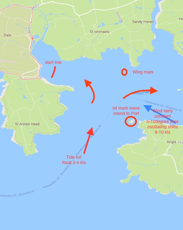

OK here's my first case study, taken from the Gate start thread, this was a race in the late 90's, long distance across the milford haven entrance channel off Dale, where all week the racing had taken place just off Dale in the confines of the bay and the cliffs of Queen Annes head had been offering favorable shifts to the right all week.
So my question what's your strategy for the race it's a straight windward course round the island then a wing mark (boat) and finish at the start line beach. The wind is pretty clean maybe 5 degree oscillating certainly no more than 10, the tide is flooding indeed they had tried but failed to get the start off before it fully flooded.
The line is pretty square but slightly favoured favoured the committee boat (starboard) end as the wind swung slightly that way during the 10 -5 countdown.

I grew up in a place with 0.1knt of tide and wind that shifted once a week so cr*p in tricky tide but will give it a bash. I assume there are no shoals or anything that would affect the current in the channel
Head right off the line to pick up slacker tide or even back eddy off the headland and short tack up there until the channel. Then keep heading to the right and into the tide and try to cross the tide to the other side and come in to the with tide under me rather than coming from left and getting past the island in the lee of the shore. Reaches should be simpler with just crabbing enough to keep the track.

One thing I don't get, in the same sentence you say the tide is flooding in and they tried and failed to get the race off before it fully flooded. By 'fully flooded' do you mean 'high tide', or is 'fully flooded' max current? I guess the latter?
Also, no depth chart, so I'll assume there's no funky bathymetry or banks?
I'd start middle line. Against the tide (does it run that far down?) there will likely be sag, and if you are expecting the wind to go back left you don't want to be on the right of fleet. The shift is right phase so you'd want to sail starboard first if you are expecting it to go back left.
I'd also go left up the beat to get in to the shore away from tide which is pretty much with the wind. There may also be a left shift with convergent wind on the left shore to add to the oscillation left you are expecting.
Coming in to the windward mark you'd experience a tidal lift in apparent wind too. You'd have to be careful not to over stand the windward mark though.
You'd want to get a good transit on the reach and crab down as the traditional fleet windward arc will be even more pronounced with the tide pushing people high.
Not much to do on the bottom reach unless there is a tide line where the tide splits which you'd want to get the correct side of.

Pretty much exactly what the coach suggested, he drew it on a board, had he not done so I might not have even bothered, but it was too good an opportunity for an I told you so moment.
The temptation for the cliffs, and yes maybe a back eddy swirl around St Annes head had almost the entire fleet doing as you describe, but the other route, bang over to the left where there was also a bit of a lift off the land, sufficient to get the nose into the tide and give a fair run out into the bay where the full blast of it not only lifted the nose but put the board on the plane, turned the the 8 - 10 knots into 10 to 12 knots which is marginal planing for a race board which reached the island whilst the fleet were still tacking up the coast in slacker air (which also lifts up and over those cliffs.
But fundamentally it was tide initially on the nose then full on the lee bow which did it.
So much so, that by the island the board had to be sailed free onto a reach.

So my strategy would have 3 parts.
1.  Take the 'free' southerly uptide gain behind the promontory immediately to the south of the start line.  I would want to be careful of any potential race on the headland.  I'd reckon that right would probably pay, depending on the exact shape of the land and the feel of the breeze.  Hopefully I'd have some shifts to help me get there efficiently.
2.  I think I'd then sail a short starboard leg until I reached the port layline.  This would come quite early because of the east going tide in the east side of the bay.  I'd be worried about what sort of tidal compression I'd experience around the island - if it's strong then I would have made the wrong call.
3.  For the rest of the race I'd make ground up tide when in less tidal flow, for example in the tidal lee of the island.  That is to say I'd emerge as far west as I could without overly compromising my speed.
If I thought there was going to be a significant increase in north going tide (a race) to the immediate west of the island then I would execute a different strategy.  I would sail a long port tack first and flick on to starboard when I got to the layline for the mark, or, depending exactly on my tacking angle, before that, in order to take advantage of the maximum flow in the main channel before being tidally sheltered behind the southernmost headlands.  But I'd still look to flick back on starboard and approach from uptide - remembering that this is predicated on a strong race off the island.

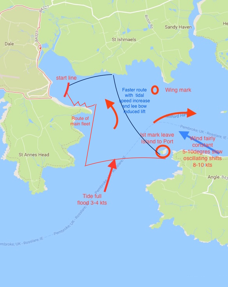

So this is actually what happened.
Blue arrives at island before red tacks to cross channel.
So tell me why it wouldn't have been faster for blue to do a hybrid of the two: short tack like red and then do a starboard leg from the end of the headland until meeting the port layline drawn?

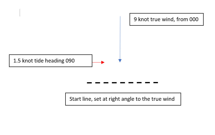

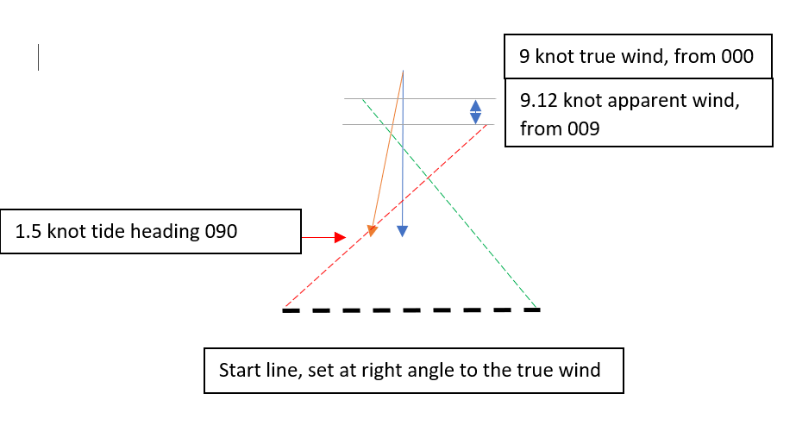

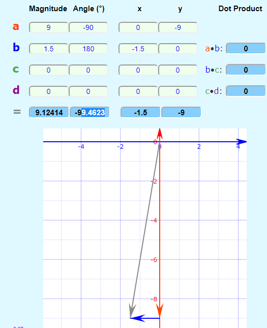

When he tacks out from the left shore the tide is first mostly on the head, but becomes increasing cross and even slightly against the wind. In teh boat it would feel like the breeze was increasing and lifting as you come back in on port.
Looking at the vectors (3.5 knot tide, 9 knot true wind) this would feel like a 10-20 degree lift (assuming tide was slack or against on the north shore (far left of the beat).
The component of the tide which is running in to the wind obviously increases the apparent wind strength for both port and starboard boats; however, the cross tide component would lift the port boats (and head equally the starboard).
Basically, as the boats on the right come out from the head land, back toward the middle, they would feel the breeze increase as the tide gets on their stern, but also get a header.
OK - so talk me through the curved laylines.  Why does blue gradually get lifted on port?
Why does red gradually get headed?
And where can I get one of these windsurfers which point so high that the tacking angle looks like 40 degrees?

In the scenario you describe, I think you made the right choice. But those three point above make no sense.
You sail on the difference between air and water. Two things. Over the ground is only relevant in that as the tide is moving it makes the apparent wind different on water compared to land. Its not a separate for to true wind.
Your third point is crap. Leeway over foils is about 3-4 degrees. This doesn't change if you are in tide or not.
Pretty much what we'd been doing earlier in the week when the windward mark was sited just at the tip of that left arrow. The main reason to go left (as also pointed out by Mozzie, credit where it's due) was the likelihood there would be a better lift off the opposite cliffs, which would get the nose into the tide earlier than rounding the headland where the lift off the land petered out, quite why they didn't harden up to head out to sea I'll never know, they were not stupid, some were Hayling sailors so not tidal neophytes, but then again who knows what squads have to do when their coach is dictating the route.
I didn't win the race, I spent too long berating the coaching team who were moored at the island, about listening to lectures on tide and not arguing the point when I bother to drive down to weymouth at my own expense to try and help them, but then it's not in a paid professional coach's interest to have anyone around with superior tactical advice is it? Then I always was naive..

Yes - I know that.  But what I'm getting at is that blue still has to make to the south into a north or north-west going tide.  Even if the diagram is not as drawn and the east going flood starts further west (unlikely) then it still starts as a north-easterly flow and turns east as you get east.  So going south before you are in north going flow is always a gain (other things being equal - which they're not!).
I think iGRF has drawn the lines a bit wrong. The way he's shown it both tacks are lifted in to the windward mark, which is impossible.
As I said in another post  the right would look okay, until they came out from the shore. They would get a lift on port from the incoming tide, but when you're the furthest boat right on the course, the last thing you want is a lift on port! They, would have to get out of that right hand side at the top of the beat by sailing on starboard. Starboard tack will be feel an apparent header.
Also, I wouldn't see going right as that much of a gain at the start either (unless there is a big back eddy which isn't shown). The tidal stream will be diverging in the middle as it splits (divergent) to two channels so the north bank probably won't see strong adverse tide, especially mid way up the beat.
Then on top of that, iGRF does say the wind was in the right phase at the start, so you'd have to sail a ten degree header to get to that right shore.

If the water were moving toward the wind at the same speed then the boat will move forward as if the wind speed were double.
I feel your pain in terms of the interaction with the coaches.....
But I also put it to you that the lead you established that day was due to the lift off the northern cliffs, and not some inexplicable tidal magic?
Posted By: iGRF
Date Posted: 02 Oct 17 at 10:35pm
The curve indicates the strength of the tide 'lifting' the board higher, tidal lee bow, as classic as that, is twofold, not only does the board physically go faster thanks to the energy provided by the tidal flow, but the direction in which the tide is headed lifts the craft upwind.
The reds stayed out of the tide.
You can buy race boards for next to nothing on eBay and I'd strongly recommend any sailor trying one out if for no other reason, than to actually feel all that knowledge you obviously have, in the palms of your hands, you'd find it exhilarating.
OK so blue, once on port, gets an increasing shove to the east from the tide, which has a greater east going component as she heads south.
What about red?  I'm not sure I understand how they stayed out of the tide.  Surely they crossed the main flow on starboard.  And what they experienced on the west coast they should also experience on the east?

Posted By: Guests
Date Posted: 03 Oct 17 at 10:52am
So, simple tidal question. In the scenario above, which end of the line is favoured and by how many degrees (upwind start)?
Posted By: Sam.Spoons
Date Posted: 03 Oct 17 at 12:05pm
Port end, on Starboard tack, CBA doing the maths but around 10%? The apparent wind caused by drift (i.e. boat stationary in the water but moving 1.5kn at 090 over the ground) would be around 010 and slightly more than 9 knots so a good lift in heading plus the drift would take you towards the windward mark. You would, in fact, be 'lee bowing' the tide Clap
Posted By: Guests
Date Posted: 03 Oct 17 at 12:07pm
Almost, but you've called the wrong end of the line.
Maybe you're accounting for the inevitable pile up at the committee boat; but I didn't actually say there were any other boats, just simply which end was favoured.
Posted By: Guests
Date Posted: 03 Oct 17 at 12:30pm
The tide will veer the true wind by 9.46 degrees, lifting starboard tack. And creating a starboard end bias of almost 10 degrees.
The race officer (moored up, so not moving in current), will measure true wind direction and believe their line is perfectly fair. If a fleet start the result will be a pile up at the committee boat as not only will people be aiming to start at the starboard end because of the bias, but will also be swept toward that end as they rack up.
Bonus points if you also calculated the 0.12 knot increase in wind speed!
See below vector calculation. A is true wind speed, and B is current induced apparent.  Ignore the angles (they’re different because of the way we describe wind coming from and tide going to then tide creating apparent from the direction it is pushing you towards). You can see the grey resultant vector veered from the true wind. The angle change is highlighted at the bottom.

Posted By: iGRF
Date Posted: 03 Oct 17 at 10:04pm
Originally posted by mozzy
Assuming the tide slackens across the whole course? No windshifts? And they were sailing at exactly the same speed? B would have to take avoiding action to avoid hitting A (still on Starboard)?
Spot on! A would hold a 1 metre is lead and B would have to avoid.
Agreed, but then B could still short tack, onto the starboard layline and force A behind and round first

The start line scenario isn't wrong. I clearly showed it was true and backed it up withe maths. That you still argue otherwise or can't comprehend it is another thing.
Yes, a tidal increase in wind can lift a board on to the plane. And it can and does an RS200 as well.
What you fail to realise is that when the tide shifts the apparent wind it shifts it in one direction (which should be obvious, it can't lift both tacks, or head both tack). This will favour one tack or the other. When the tide increases the apparent wind it increases it does so for both tacks.
So in the board race you described, where the current lifted you and increased the apparent wind allowing you to plane. That's fine. But, the increase in apparent would have also been enough for the board on starboard to plane. It's just that they would be on a header and you were on a lift.

You need to work on your problem setting iGRF. There are so many things left out or wrong.
I have another scenario for you to consider, in your {doesn't make any difference which angle the boat is to the tide) assumptions.
Lets take the typical triangle with a cross tide, but the 1st leg has been set broad and the return leg of the triangle is tight.
Okay, so by triangle course you mean a course that start on a reach? 1st leg a broad reach, second leg a tight reach and third leg presumable a beat?
The advantageous cross tide assists on the 1st leg, but is disadvantageous on the 2nd.
Okay. I get this, that's fine. But really, the extent to which a boat has to crab across the tide to stay on the rhumb line is determined by:
  • the strength and direction of the tide
  • the strength and direction of the wind
  • the boats speed through the water over various headings and wind speeds (speed polar)
  • distance and heading between marks.
You provide none of these key bits on information which would allow a definitive answer to the problem. You are either leaving this information out because you don't realise it is required, or because you don't understand how to solve the problem and want it to be ambiguous so you can blag your way out of it later.
It is still a reach though but the wind is failing
So, you're saying the wind is dropping, but not so much as they have to start tacking to get over the tide and up to the mark. I think I understand that. But again, you don't say what the wind started out at, or what it drops to.
Boat A gybes and sails for the mark with the tide still on the weather side of the foils.
Sails for the mark... so ambiguous. Do you mean points it bow at the mark? Most people in this situation would sail for the mark by taking a transit to show them where the rhumb line was and crab the tide. AS you can tell from my bullet point list above calculating the true heading needed is difficult, so just taking a transit and keeping the boat on it is a very practical way of solving the problem.
Tide on the weather side of the foils? Ha. The tide is coming from the weather side of the boat, the foils, the rig and everything. It is a single factor, moving the whole boat in one direction as one. Meanwhile, the foils will experience flow in from the direction the boat is moving (through the water). In terms of flow on the foils where the tide is coming from makes no difference. The boat isn't moored to the bottom.
Boat B gybes higher and presents the bow directly into the tidal flow.
So, boat B sails higher, directly in to the tide. But, the tide is still slightly across the reach (although we don't know for sure as you haven't provided the information). If they only sail directly in to the tide, they will never reach the mark. (unless the mark is directly in to the tide as well... in which case boat B is doing the same as boat A, which is sailing directly to the mark as well).
There must be a second part to B's strategy. I.e. they sail directly in to the tide, then bear away later on the reach to cross tide and drop down to the mark.
Sailing high then dropping low could be a good strategy in a failing breeze. You'll spend more time fighting the tide when you have breeze to do so, then can ferry glide down to the mark later on when the breeze dies... none of that is in your description of the strategy though.
Who gets to the lee mark first?
Well, unless boat B bears off, he'll never get to the mark, so I'd say boat A.

Easy.
Point 1, favorable tide say up river, wind blowing downriver, like say Columbia River Gorge Both Tacks lifted.
Point 2. Your gammy start line prediction.
All boats off the line, relative to the wind will stay at the same angle to the wind yet the course they collectively sail on is moving sideways creating the illusion of a lift, but not altering the attitude of the boats against one another as would be the case with a windshift favoured starboard end.
I take it I don't have to point out to you what happens when wind lifts a fleet as it departs a start line.
