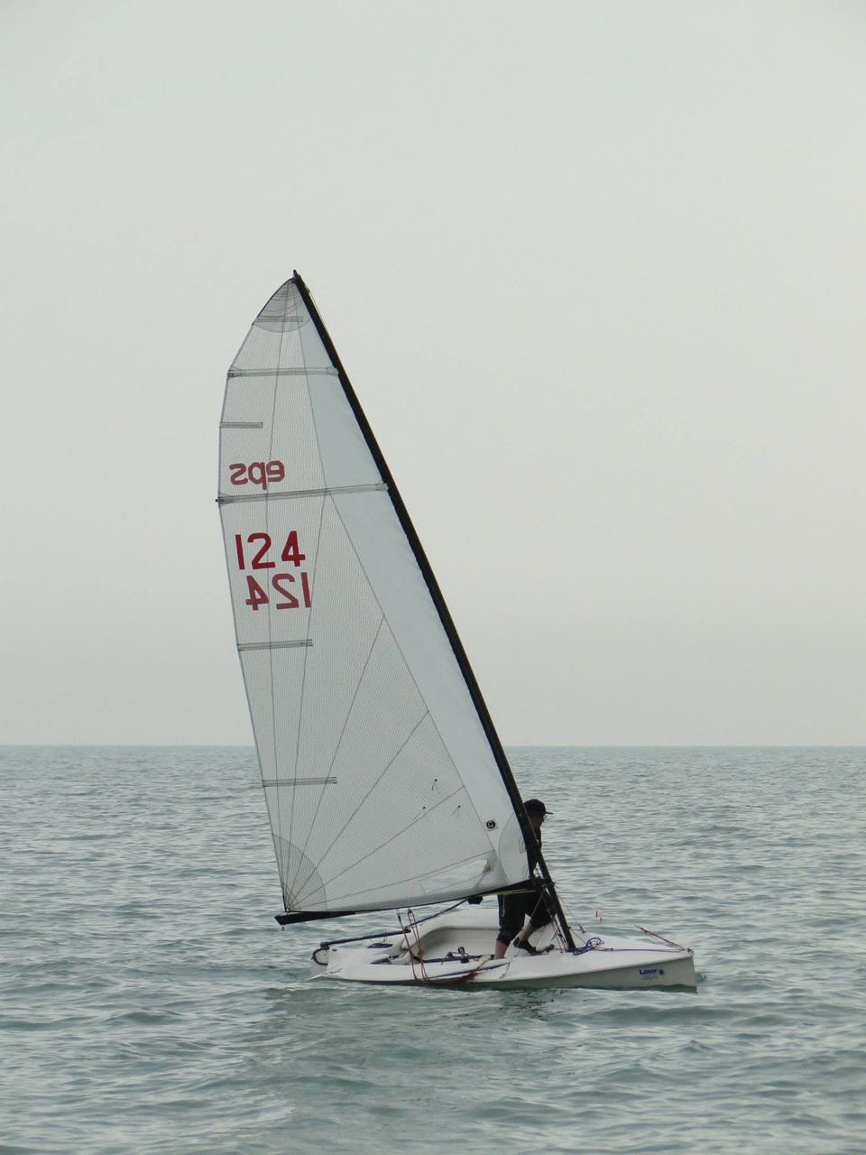

Posted By: iGRF
Date Posted: 12 May 17 at 10:35am
These are my two EPS sails the original and the soft copy which performs much better for me, it's quicker through tacks, less likely to go into irons although it did last night when I forgot to dump the kicker after a failed gybe.It seems more tuneable shape wise as well although I felt he'd built to much fullness in the leading edge which only pulls out with lots of kicker induced mast bend.
Posted By: davidyacht
Date Posted: 12 May 17 at 11:37am
Looks quite nice
Happily living in the past
