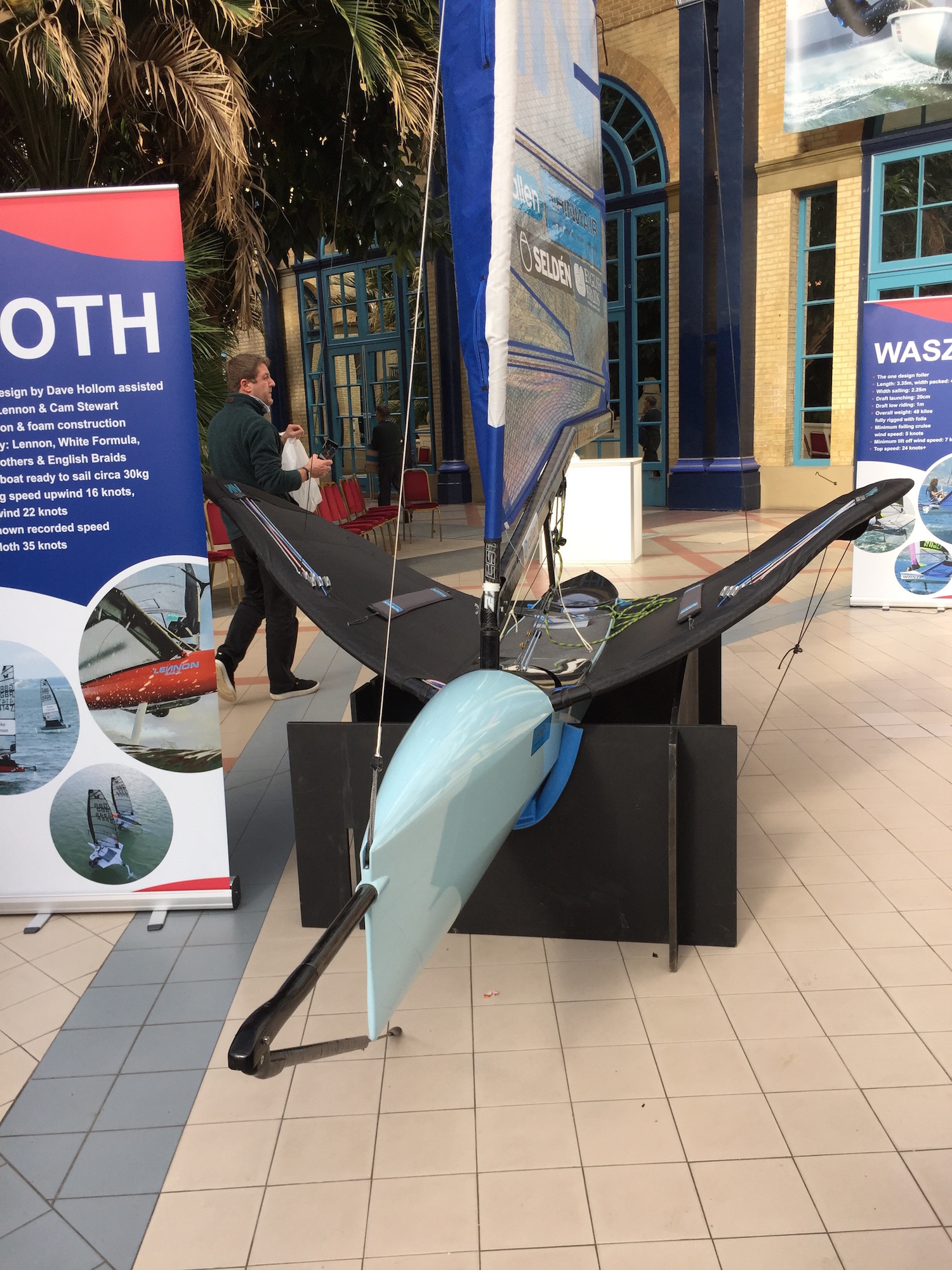

I had promised to man the Solution stand so spent a fair bit of time there but not without checking out the F101, a tad too big for our boat park but quite a stunning creation none the less and the thing I'd most like a go on although the Mike Lennon moth with it's incredibly upswept wings in the foyer was equally tempting but probably impractical for those of us prone to snr moments.

Check the rise and uplift of the tramps on this Mike Lennon moth, why? My guess would be more ability to cant over to windward windsurf style without touching the wings down, but looks like a bird, swallow style, very nice boat, nobody to chat to it was out side, but obviously if you know about this stuff you'll probably get it anyway and us low riders just get to gape in awe and troll over to the F101 stand.

I guess the next trick is to make the leeward wing work as useful sail area?

Trifle useless info at this point GRF, but the chap in the background to your Moth pic is also a Solution sailor.
Posted By: 17mika
Date Posted: 04 Mar 17 at 11:04pm
The high wings are just to get more righting moment when heeled upwind.. nothing to do with touching the water, because that is almost never a problem in a moth.
Sweet looking boat, by the way :)

I dunno, the wings being as high as they are, were in fact closer to the centre line, that was quite obvious from another Moth nearby with conventional straight wings that only raised the 'normal' angle. So not 'more' righting moment than normal in fact you could argue less, maybe a heavier sailor who wants to ride more inboard and lever from there, my money is still on more windward cant and therefore more lift from the sail to complement the foil, it would have been great if someone had been on hand to ask. Ironically I met a guy who allegedly had a hand in it, old mate from windsurfing, Simon Reynolds a mothy, I should have asked him he'd have known.

The moths sail upwind heeled well to windward so those canted wings then effectively become horizontal and increase the leverage

Presumably the wings will be max width (no point in them being narrower) so being upswept must increase the righting moment as the boat heels to windward to the point when the wing is horizontal?

Nope I still make the argument that if you follow the logic,
1) They are closer to the centre line.
2)They permit the rig to be hauled further to windward without dipping in the water thus reducing the sail area presented to side forces and generating more upward lift vector without over cooking the righting moment and going in to weather.
That means less righting moment, but more versatility with the righting moment available.
I reckon.
Or.. sudden thought they are actually wider, but being curved upward remain within whatever measurement defines how wide they can be, then they do all that stuff I said up there anyway.
But they certainly look kewell and I hope it blasts to the front of the fleet.
Posted By: Sam.Spoons
Date Posted: 05 Mar 17 at 12:35pm
As long as the wing to wing measurement is no more than 2250mm they are legal, the more they angle upwards (the curve may be ergonomic but makes no difference to max leverage) the longer that can be (from hull to tip) without exceeding the max width measurement. Leverage increases until the windward wing is horizontal. That is compounded by the fact that the roll centre of the boat is a couple of feet below the hull when foiling so the righting actual moment is the horizontal distance between the RC and the end of the wing.

Another thought, are they curved so you don't just slide off them when the boat is sailing nearer to upright?

they may be really springy, when sat on they could flatten out ?????

I'm still struggling with why the leeward wing presenting itself as a damn great near-vertical surface in the airflow isn't a very bad idea?
Or is it working as a sail?

If you saw the Mike Lennon talk at the show he explained with various diagrams how the upswept wing increased the righting moment. The distance between the edge of the wing and the tip of the foil is greater the more upswept it is, and of course you are sailing the Moth canted over to windward so the helm's weight is effectively further away from the tip of the foil. But he also said that if the wings are too upswept they become a problem for the crew when moving from side to side, so there is a trade-off at some point.

i'm wondering if when sailing the toe straps are held up a bit further at one end, they look like you'd need to find a spare hand to get your feet in them now and that, in my low-riding Moth experience might be the second or two which makes the difference between swimming and sailing

Of course.. it's the distance from the foil that increases, not the centreline of the boat, so it's win win.

And they can be longer but still measure, I make that win win win :)
