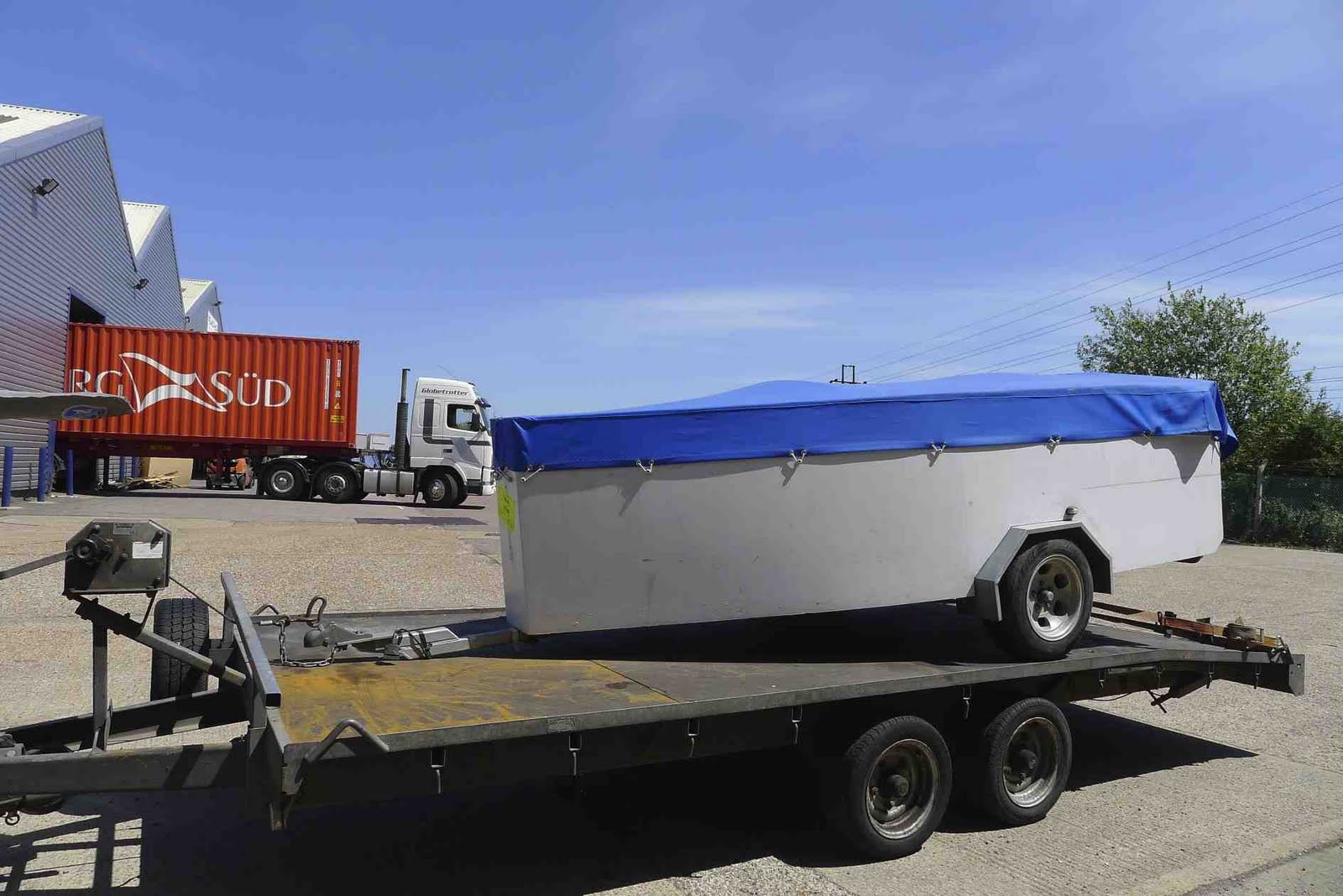

I was speaking to my local trailer builder and they commented about an old Fireball combi they made which was a covered 'box' design where a boat could be wheeled straght into and driven off / when storing can be wheeled inside with mast up / and overnight stays can be used as accomodation.
does anyone use something like this still / has anyone got an photos of a trailer similar to this?
Considering something like this for ease and accomodation when travelling to opens/nationals/etc

Posted By: pompeysailor
Date Posted: 21 Feb 17 at 10:01am
any designers out there fancy sketching up something / trailer designers to price up?
My idea:
* Fully enclosed boat 'box' constructed on existing trailer base
* Sloped to rear to allow water to drain off
* Thick / boat cover material for 'roof' and clip down points along sides - allow transport with roof on/off etc (weather dependant / need to dry hull)
* double ended zip along middle for allowing mast up storage
* flat floor to allow accomodation when required
* Internal tie down points for transporting

Posted By: Jack Sparrow
Date Posted: 21 Feb 17 at 2:18pm
You mean something like this? Yes, my old 3.7 had a box tailer with a canvas roof which you could sleep in. Not to difficult to make around a trailer.

I think I have a good idea about what you're after.  Something that would sit on an existing road base would negate the type approval / inspection thing, and then in turn the boat sits in that.
First problem is that road bases with 8" wheels are quite low - when towing the hitch may be higher than the axle.  So if you put a flat base on it extending out to the transom of the boat, it would probably have grounding issues.  The solution would be for the floor to be hinged just behind the road base roller - when travelling this would be raised close to the transom to provide ground clearance, but would be fully lowered for loading.  Possibly could be a mid position for camping?  Would need some thought about what was going on with the sides & rear at that point!

I saw something once, it was a sort of mini-folding caravan/trailer tent affair, with brackets to hold the launching trolley on the folded lid.
It seemed to pack down to a box about 18in tall,  and open to a funny wedge shape.
It might have been Fireball related.
RS400atC, I think the trailer tent arrangement you are refferring to, belonged to Neil Thornton of Number1 sails, when he was campaigning on the Fireball circuit in 85/86.
It was beautifully made (as was everything Neil turned his hand to) but I only ever saw it in use once.
39 years of dinghy racing and still waiting to peak.
