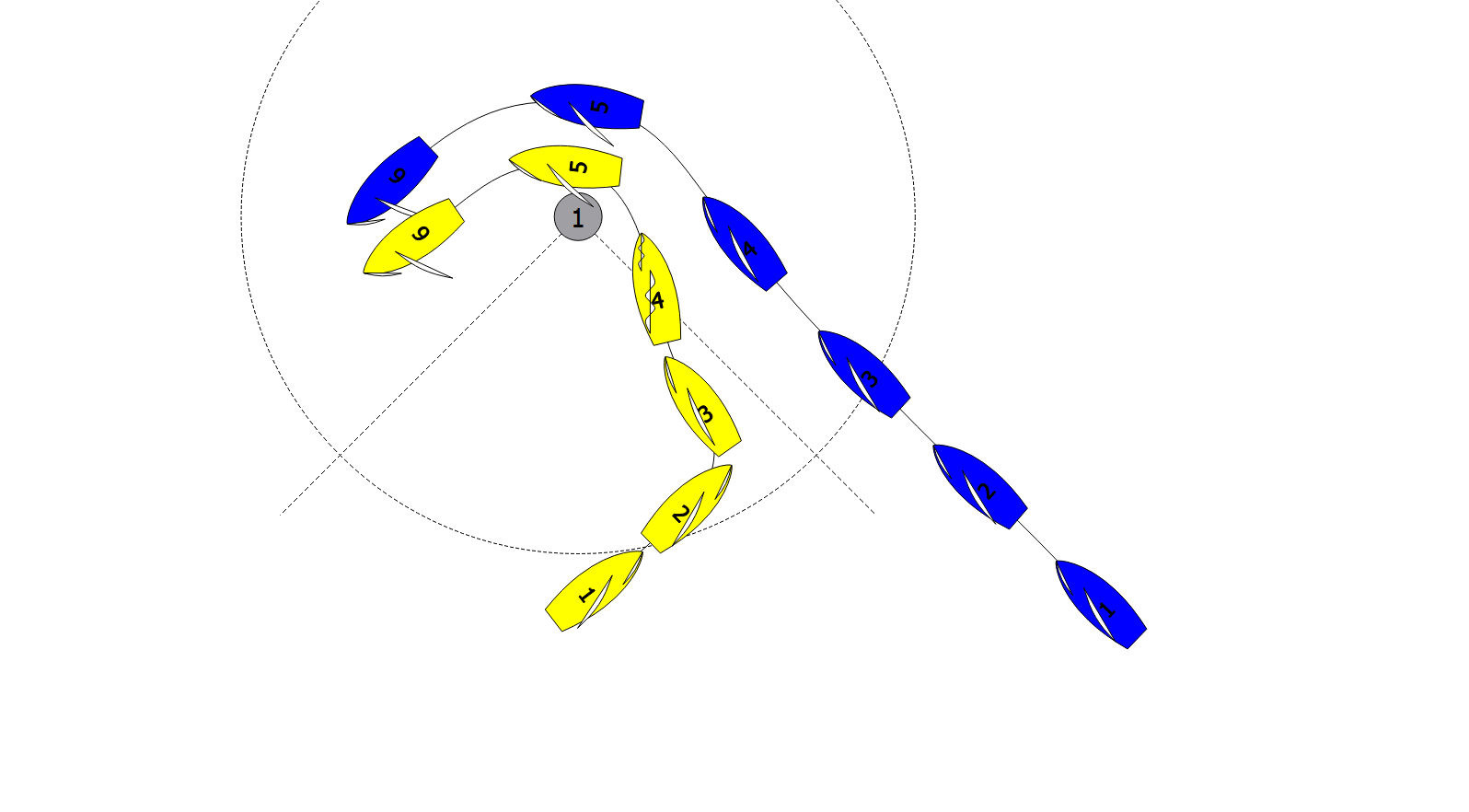

Here's another query about tacking in the zone. . . .
Two boats on opposite tacks approach the windward mark which they are rounding to port. Boat P, on port, tacks below boat S which is approaching on starboard. Boat P's tack is clean and boat S does not have to take any avoiding action. Boat P who cannot lay the mark without luffing shoots the mark and rounds cleanly but Boat S's boom touched Boat P's rigging when this manoeuvre is carried out.
Should boat S have given more room for P to round the mark or did boat P infringe the rules by tacking below S and then shooting the mark.
This all happened within two boat lengths of the mark.

Posted By: Brass
Date Posted: 11 Apr 16 at 12:34pm

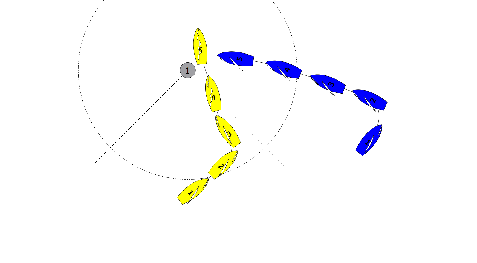

Here's what I think you described.
In this case, B has never sailed above close hauled, both boats have passed the mark, so Y cannot be said to have prevented B from passing the mark, so Y has not broken rule 18.3.  B, to windward does not keep clear of Y and breaks rule 11 and probably rule 14.
Try this:
Here, I don't think anyone would dispute that Y prevents B from passing the mark.  Y breaks rule 18.3
Now this:
There is contact with B's boom @5.
Boats have not 'passed' the mark, therefore B is, at least' attempting to 'pass' the mark.  Y shall not 'prevent' B from passing the mark.
Y's shrouds, which make contact with B's boom, at least obstruct B from passing the mark.  I think this has to be the applicable meaning given to 'prevent' in rule 18.3.
There is very scant discussion of the 'prevent' obligation in the commentary books.
One way of looking at the 'prevent' part of rule 18.2( a ) is to consider it the 'compliment' of the 'cause to sail above close hauled' part:  where the fetching boat needs to sail above close hauled to avoid contact, but doesn't, isn't that where 'prevents' kicks in?
Posted By: sundowner6959
Date Posted: 11 Apr 16 at 1:01pm
The bottom graphic is how I saw it happen.
Date Posted: 11 Apr 16 at 1:23pm
Gosh Brass, you're interpreting 'prevent' very differently from me. I was thinking that it meant forcing the other boat the wrong side of the mark.
Given situation 3 then, where do you see penalties?
The way I read it B is not ROW or entitled to mark room under RRS14. Depending on the speed of boats Jeffers may very well be right and B is entitled to room under RRS15, in which case she's exonerated for RRS11.
B is not entitled to room under a section C rule so can't be exonerated under RRS21.
I'm inclined to say that Jeffers is right about room, that Y didn't give B room under RRS15/16, and so penalise Y and exonerate B.
However if B had luffed up to avoid Y there would be no complication at all, and Y would clearly be penalised, so there's a moral there!
Posted By: jeffers
Date Posted: 11 Apr 16 at 1:50pm
Sometimes it pays to luff up above close hauled to prove that you felt that a collision was inevitable and you had to take avoiding action and sail above close hauled. Slam dunk case if that had happened in my eyes under 18.3 (as long as B was not way above the layline of course).
Are we assuming B is effectively on the lay line though as the illustrations show B to be above it (this is why judging a layline accurately is important)?
Date Posted: 11 Apr 16 at 2:57pm
The race was on an inland loch with the wind flicking through 30 degrees so whether B was fetching or on the layline is difficult to determine but I would assume he was above the layline.
If Y had not tacked below B but had been abreast and on the same starboard tack and on the layline within 2 boat lengths and the wind shifted 15 deg.(header) would Y not be entitled to shoot the mark with B giving room?
Date Posted: 11 Apr 16 at 3:36pm
If the boats were overlapped and on the same tack when they reached the *THREE* boat lengths zone then the inside boat is entitled to mark room. That includes room to shoot the mark if needed, but not to tack or go past head to wind.
Posted By: jeffers
Date Posted: 11 Apr 16 at 3:40pm
You cannot assume anything. Whether the wind shifted or not would be a matter for the PC to determine in their 'facts found' as would whether or not B was (far enough) above the layline or not.
Breaking it down. Rule 18 'switches on' when Y reaches the zone at point 1. As they are on opposite tacks at this point Rule 18 does not apply (18.1a).
When Y tacks at point 3 they are not entitled to 'Mark Room' as the rules clearly state that 18.2 does not apply between them.
18.3a allows Y to sail above close hauled as long as they do not cause B to sail above close hauled or prevent them from rounding the mark. As there was contact between them it shows that something clearly went wrong.
As Y also changed course to go above I believe Rule 15 applies.
So unless Y can prove that B was well above the layline and could have changed course to a close hauled course then the odds are definitely not in their favour but B is also not required to react to Y unless it is obvious they are not keeping clear. B may have assume Y would sail astern of her and tack.
Without a witness the case for Y does not look good. My gut feeling in this case is that most PCs would find in favour of B unless there is a witness involved.
The rules are stacked against latecomers at a windward mark on port, for a good reason IMO.
So my advice is, if you are going to come in late on port make sure you have a gap to go in and if it doesn;t work you need to bail out (bail out protest later).
Posted By: Brass
Date Posted: 11 Apr 16 at 8:28pm
That's certainly the example the commentaries discuss with respect to 'prevent'.

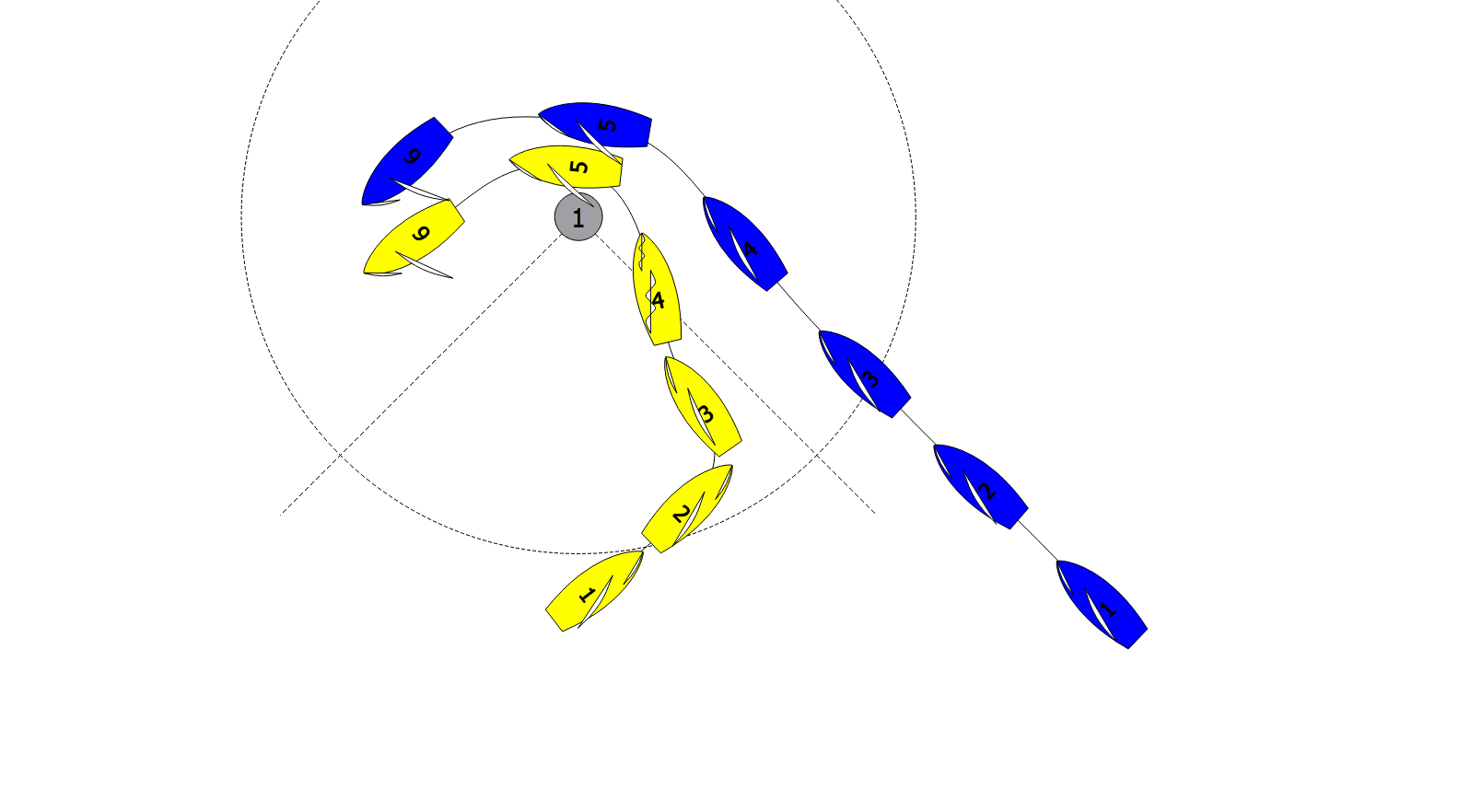

OK.  What does anyone think about Diagram 2, where Y deliberately puts on a mark-trap?
I would guess it is Rule 11 as Y is not preventing B from passing the mark on the correct side (so doesn't break 18.3) as B is well above the layline they could head up..
Posted By: Brass
Date Posted: 12 Apr 16 at 3:31pm
Can B pass the mark without hitting Y?
How is that not 'preventing' B from passing the mark?
Date Posted: 12 Apr 16 at 5:03pm
Not sure what you mean...
I don't think we need the "prevent" clause in this situation since if Blue goes behind yellow she's entitled to mark room (18.3b), and if she goes in front of yellow and past close hauled then that's the first sentence of 18.3(a).
Date Posted: 12 Apr 16 at 6:38pm
I assume blue doesn't have to predict at point 4 that yellow will stay htw past the mark, and by stage 5 will need to go past close-hauled, so blue is wrong.
Posted By: Jon Meadowcroft
Date Posted: 12 Apr 16 at 9:05pm
This seems a pretty pointless and unrealistic example
In the starting position Y is downwind of B who is on the lay line. Apparently by pointing the boat head to wind after a tack Y gets its transom past the mark before B gets there.
It does not happen like this!
If it could happen Y tacked in the zone. I don't think she wants to be hanging about waiting for anyone else to turn up. B can easily sail over the top has physics has to make Y stop!
Posted By: Brass
Date Posted: 12 Apr 16 at 11:06pm
Isn't that Y preventing B from passing the mark?
Yes, if it is possible for B to luff up past her close hauled course before she hits Y
Disagree.
If B bears away, she will be clear astern of Y.
Posted By: Brass
Date Posted: 12 Apr 16 at 11:15pm
We are discussing the operation of a rule.  Of course the example is contrived.  I'm trying to examine what happens at the boundaries of the rule.
I disagree that it couldn't happen in practice.
If Y had passed head to wind before reaching the zone, it would be a routine mark-trap, so all that is needed is for Y to misjudge her position with respect to the zone boundary when she tacks.
B has never been on the layline.  B is always well above the layline.
If B is on the layline, she's nearly always going to get the benefit of rule 18.3( a ) first sentence.
Posted By: jeffers
Date Posted: 13 Apr 16 at 9:02am
18.3 states:
(a) shall not cause the other boat to sail above close-hauled to avoid contact or prevent the other boat from passing the mark on the required side,
In your contrived example B is well above the layline and could come up to a close hauled course and still leave the mark on the required side. Once they are past the mark it becomes a windward leeward situation.
There is no mention of B being entitled to sail their proper course in 18.3 just that they be allowed to leave the mark on the required side. Which, in this case, had they come up to a close hauled course, they could have.
This is why being on the layline is key as it closes off these situations.
