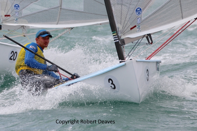

Date Posted: 18 Feb 16 at 9:43am
Just thought that I would clarify that the JC Strap (not strop) originated in the Finn class and was introduced to the class by John Christianson.  As some might know the Finn mast is stepped way forward and it's pretty much impossible to hold the boom out whilst at the same time keeping hold of the tiller extension which led to this innovation. Some people like to have the bow block led back to a cleat so that they can let it off in strong winds but others keep it on all times as it helps with pumping (the legal type of course Wink) and also assists in preventing unwanted gybes when running by the lee.

The JC strap is shockcord and is not intended as a preventer with it's main purpose to take the boom out to the desired position without the need to push it by hand on light downwind legs.  I think there is a danger of getting two very different types of rigging confused.  Yes it was an innovation on the dinghy scene and I am not aware of any 'big boats' either using a JC strap or anything similar?
